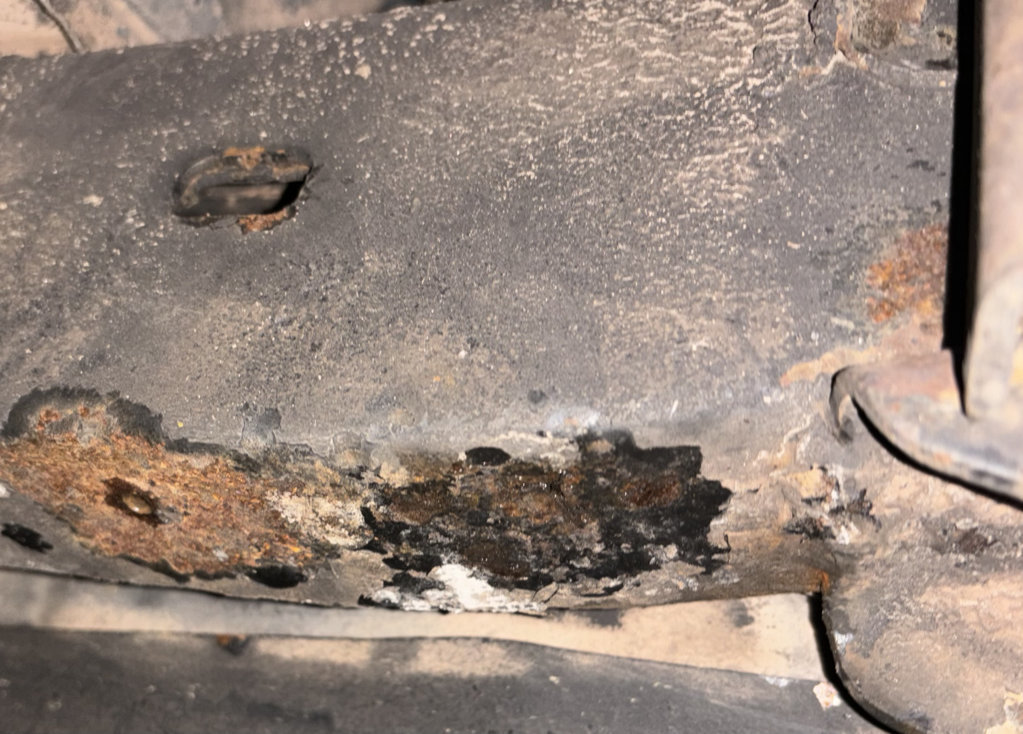

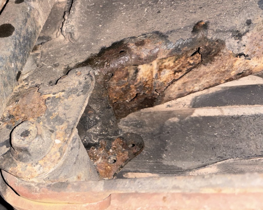

    I'm sure this has been posted many times, but I'm hoping to get some advice specific to me. Hope it's okay to post this here.
    First, I've inherited this truck with rust issues. It wasn't apparent in the first year the extent of the rust problem because it's rusting from the inside. I've learned more recently that this is very typical of these trucks, and also very detrimental. I'm sure most, if not all, of you are aware of this..
    Second, I'm not very mechanically experienced. This is my first car, and while I've learned a few things, welding and stuff is way beyond my knowledge.
    So... There's a few things I can use advice on..
    I live in Brooklyn, NY. Does anyone know of any shops with experience with significant frame/rust repair? I just emailed SafeTCap to try to find an authorized shop to take a look at it. I'm pretty desperate to save this truck, so I'll travel..
    In the meantime, is there any way for me to clean out the frame. I've only just started to take a good look at the frame as I'm realizing the severity of the rust issue, and ive noticed that there's like an inch or two of loose debris/dirt/salt/rust built up inside the frame just sitting there damp. How can I get that out? Being that I'm in Brooklyn, I don't have a hose hook-up. Is there a car wash I could take it to?
    Lastly, I'll include some photos and explain my understanding of the issue as best I can. The worst of the rust is behind the leaf spring hanger/shackle on the driver side. Also, I banged a hammer in front of the hanger, and can tell its very weak up there too.. The passenger side has not rusted through, but I tapped over there too and can tell it's only a matter of time. The rest of the frame seems pretty solid, but again, I know it's only a matter of time.
    PS,
    I apologize ahead of time for the lengthiness of this post, and my naivety and inexperience. I'm totally open to suggestions. I'm under the impression that this fix will be costly, but like I said, I'm desperate to save this truck. I can scrap together a couple grand if that's what it takes.
    Aside from that, I have family that would let me use their tools/driveway down in Philly. Maybe I could clean out the frame down there before I pay to have it repaired.
    PPS, this is my daily. I don't need it daily, but I'm using it in the meantime and it's snowy/salty/muddy here for the foreseeable future. Safety issue? How quickly will this progress?

    Good thing is you have some solid metal there to weld to. SafetCap is your friend here. For reference I paid someone $700 to weld the mid section on my single cab. Means cutting off the old leaf spring mount, and prepping and welding the mid sleeve on, and reattaching leaf spring.
    Treat what you have esp. inside frame. Look up waxoyl and see specifically their cavity wax product. Comes in aerosol with a long wand to put inside frame.
    But get both of these steps while you still have solid metal there.
    RustyNut1996 likes this.

    Looks like you’re already on the right path!
    Saf t cap has a list of shops in each state certified to use their products.
    here:https://www.autorust.com/safetcap-installer-network/
    Like the above poster said, get a wax product on it in the mean time, spray inside of the frame and out. Also don’t try to tow a trailer any time soon.
    I’ve heard people saw it’s about 1,000 per side to have those repairs done. Good luck

    If you don't have the means to DYI at least some of the work - take the bed off, clean the frame, wrench suspension - this will end up being a very expensive ordeal to do it properly, I'm afraid.

    I hate to rain on your parade, but if you can scrape together a couple grand for repairs, then you should spend that couple of grand on a cheap, but less rusty car. This thing is way far gone and will cost you thousands in repairs, and eventually the rust will win the war

    Yes, this ^^^. Without pics of the full undercarraige there's no assessment here on overall condition. Weld a sleeve on it -- and don't feel obligated to use the folks on safetycap's list. Anyone with solid welding skills can do it.
    Ive had three toyotas rot out to point of vehicle retirement.

    FWIW, here's a truck that sold (way over priced) -- very nice condition with a patched frame. You can see it in the photos and comments. Frame condition before patching is unknown... Like I said, buyer over paid, but the point here is good trucks are repairable and valuable. Small frame rust issues can be resolved.
    https://bringatrailer.com/listing/1999-toyota-tacoma-18/
    Here's another one with frame work. Doesn't show before pics, but again, the point is that trucks can be repaired and nice ones still have value even with repairs.
    https://bringatrailer.com/listing/2001-toyota-tacoma-60/
    If you sleeve the rust section, consider getting the sleeve galvanized if such a place exists near you. Galvanizing is cheap....

    I stopped by Pro Lube Performance in Staten Island. They work with Safe T Cap, and only do frame restoration. Joe took a good look at my entire frame and quoted me $1900 to clean the frame inside and out and cut out and replace the section where it's rotted through. He's going to have to drop the gas tank, and potentially remove the bed. This is likely the route I'll go.. I'm also under the assumption that the frame is likely weak in at least one other area, but we'll see.
    I'll keep updating this after that work is done, and as I continue to do work to protect and reenforce the frame.
