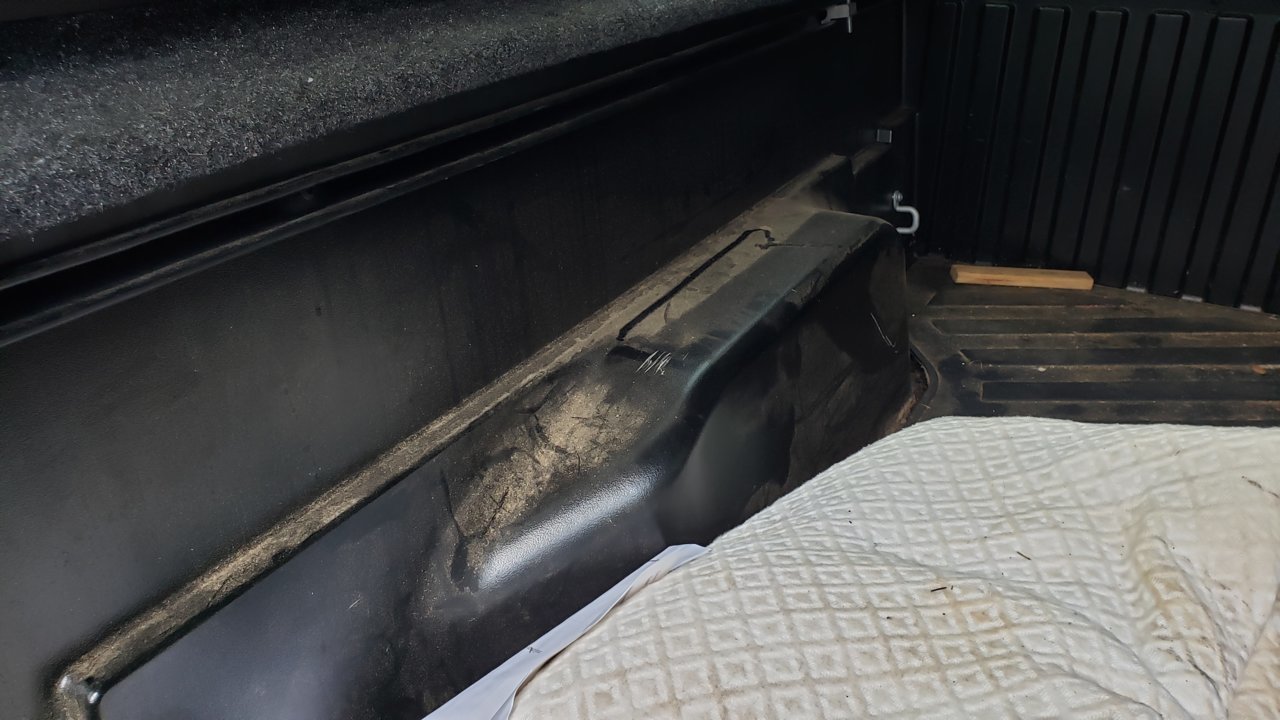

    I've got the stock tacoma tonneau cover, and i've had no rust or anything like that, but it doesn't leak either. Must be coming from the tonneau cover hardware, or somehow from the rear quarter panel steel skins.

    The watery rust is coming from the bolt areas above.
    Look close at the first red-circled area in Post #45. You can clearly see stains down the side of the bed from the bolt area. That runoff overflows the first narrow "shelf", then floods the bed floor.
    If you pierce the factory paint down to metal in any way (scratch, drilled hole, rubbing, etc.) it will rust unless properly sealed.

    Look at the hardware that holds down the tonneau to the rail. Mine rusted a bit because the rubber washer didn't seal between the tonneau and the bolt flange.

    Its as plain as day the rust is coming from the bed cover's brackets and bolts. Wash it out and call it the day. Spray some clear coating or rust preventative on it. You're making too much out of it.

    who added the other rail under the OEM probably used non stainless hardware. Take each one out and make sure all is stainless, even the washers.

    i don't think the rust is from your bed. it's from something else. like something you park near. either that or the aftermarket rail you installed. never had rust in my bed but i don't have that thing you installed.

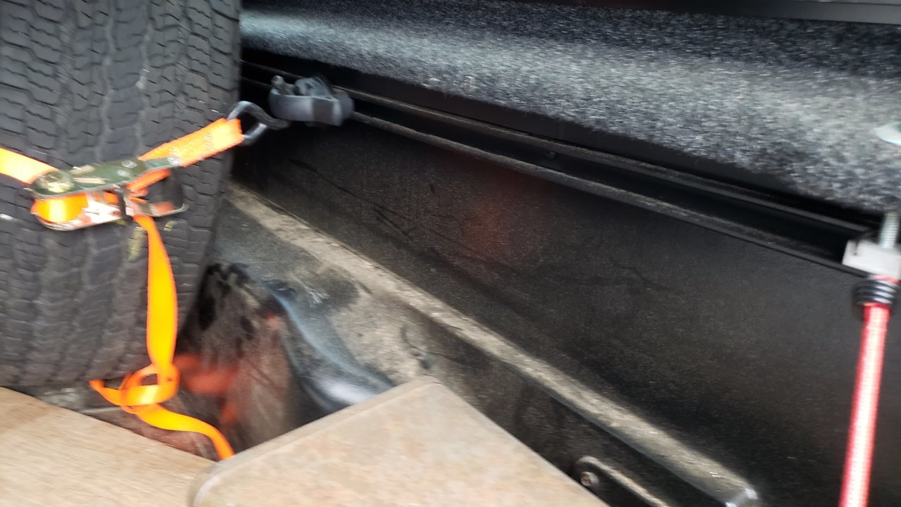

    Only aesthetic mods so far Leer 180 cap & Clazzio covers on order.
    I have a cap on mine and the inside of the bed looks similar (no drilling ever).
    Prove that it's rust and not just road dust captured in the bed. Then address it.
