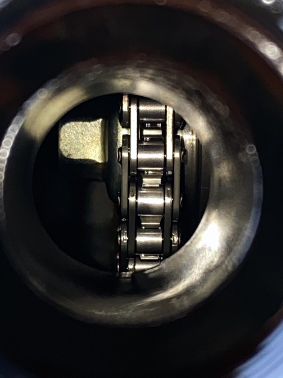

    IMG_1777.jpg What does it look like under the oil cap? If it looks like this there’s should be any sludge. If there is run synthetic oil. It’s your best be to clean up any build up. Don’t use marvel mystery oil. That shit is solvent based and will burn off if ran too long. I would look in HPL, high performance lubricants. They’re a new company and gets a lot praise for their products. My 4.0L has 128K.

    Instead of adding all these magic chemicals to the engine, several rounds of short oil change intervals with cheaper oil and filters would be a safer bet. You'll want to clean this mess up slowly. After all said and done it'll never really be a "clean" motor. The 4.0 won't care that much though.

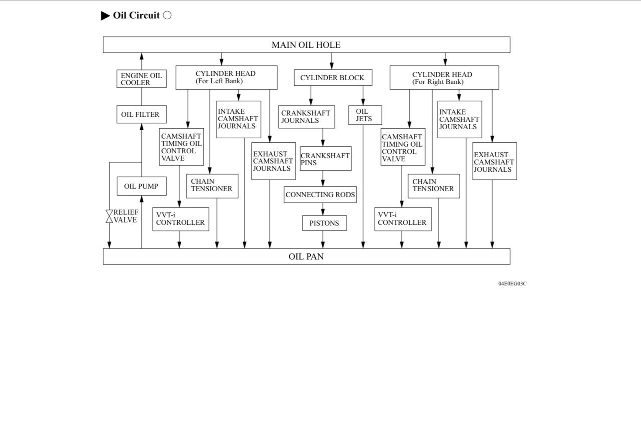

    The oil flow on the 1GR (as most engines) is Pump pickup screen to the oil filter.
    Your best bet would be to change the oil and filter by 2,500 miles or sooner.
    If you continue to see chunks, keep changing it sooner. Once it clears up. Do regular changes.
    I suppose you “could” do an oil pressure test and see if the system is low on pressure.
    If so, you could drop the pan and inspect the pickup. Other than that. You have nothing else t9 do other than drive it and do maintenance like it should have been done in the first place.
