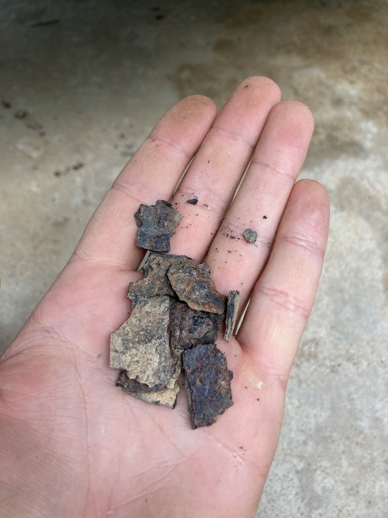

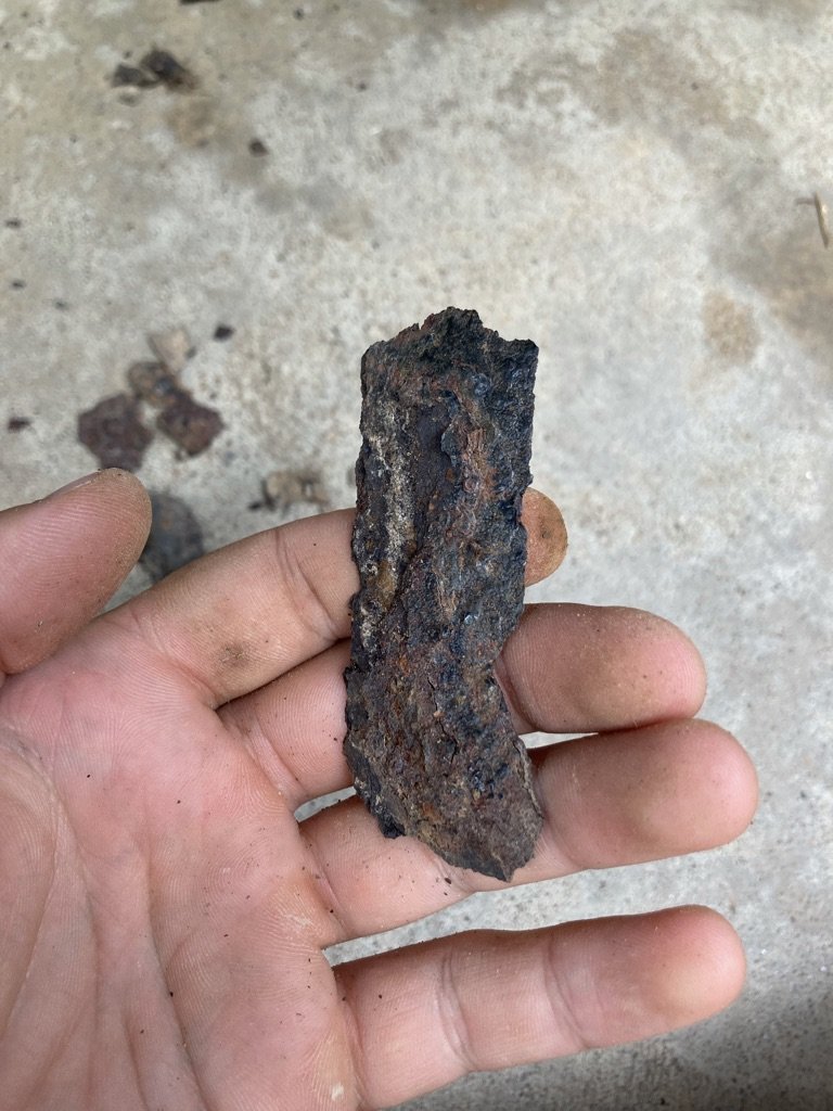

  9. Jun 28, 2021 at 3:25 PM
    #29
    Ozark_RegCab
    Ozark_RegCab [OP] Well-Known Member
    Jan 31, 2021
    #354648
    6,189
    Nick
    Northwest Arkansas
    1996 Tacoma SR5 4x4 5 speed
    Sliders, lift, 275/70/17
    Update: It's worse than I thought. I poked around inside the frame holes just in front of the rear wheel well and came up with some HUGE chunks. You could see the old paint on top.
    I think I'll have to cut my losses at this point, as I don't see anything that'll save it at this point, at least nothing cost-effective. Amazingly, there's still no outward signs of any structural compromise, but I figure it's only a matter of time.
    It's a shame these early Tacos came with such crappy frames; they're such scrappy trucks otherwise. What was wrong with the fully boxed frames from the earlier Pickups anyway?
    In any case, I've learned a lesson about vehicle acquisition; any potential future purchases will be gone over with a fine-tooth comb, inside and out, especially older trucks like this! Pics below.
