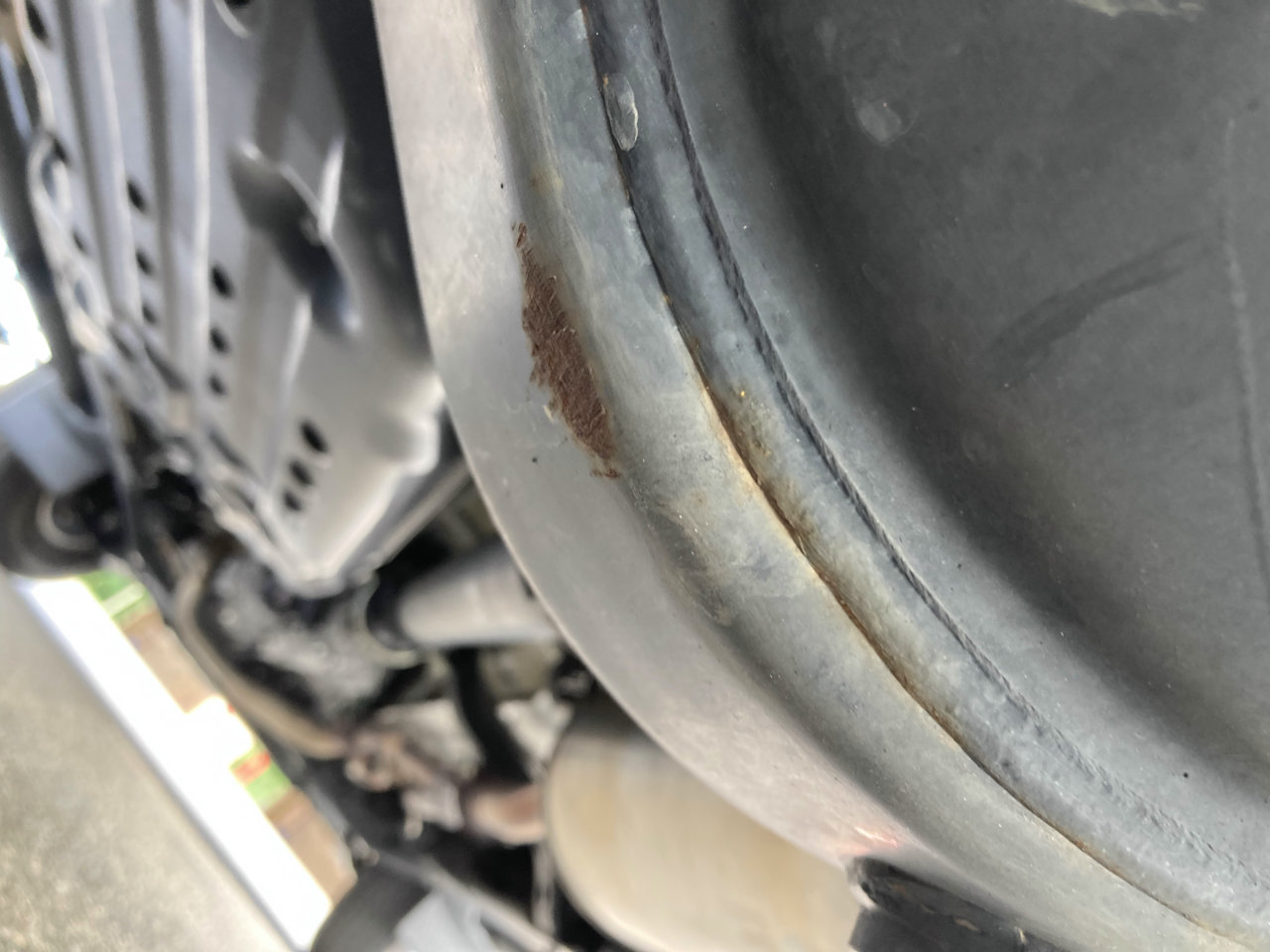

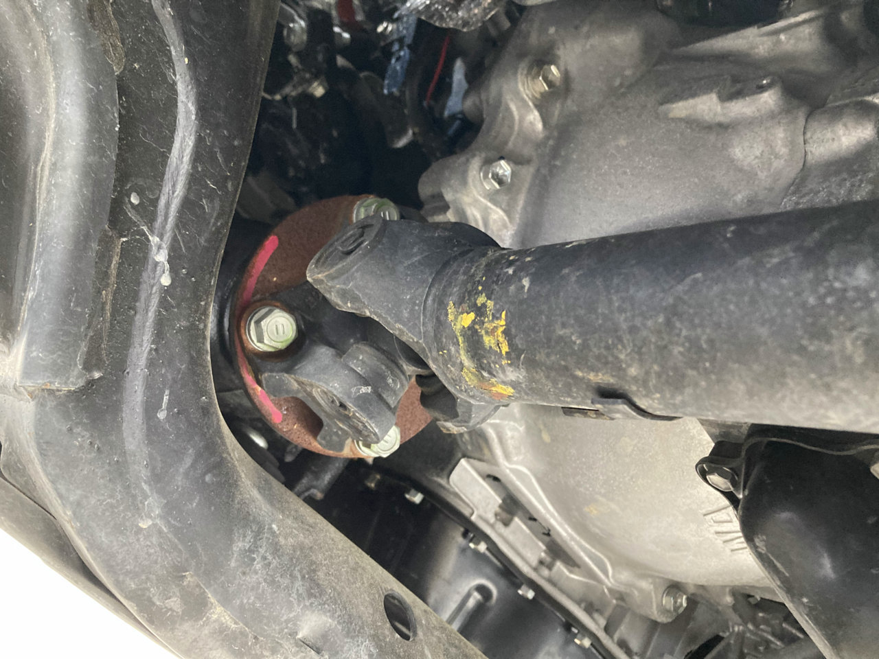

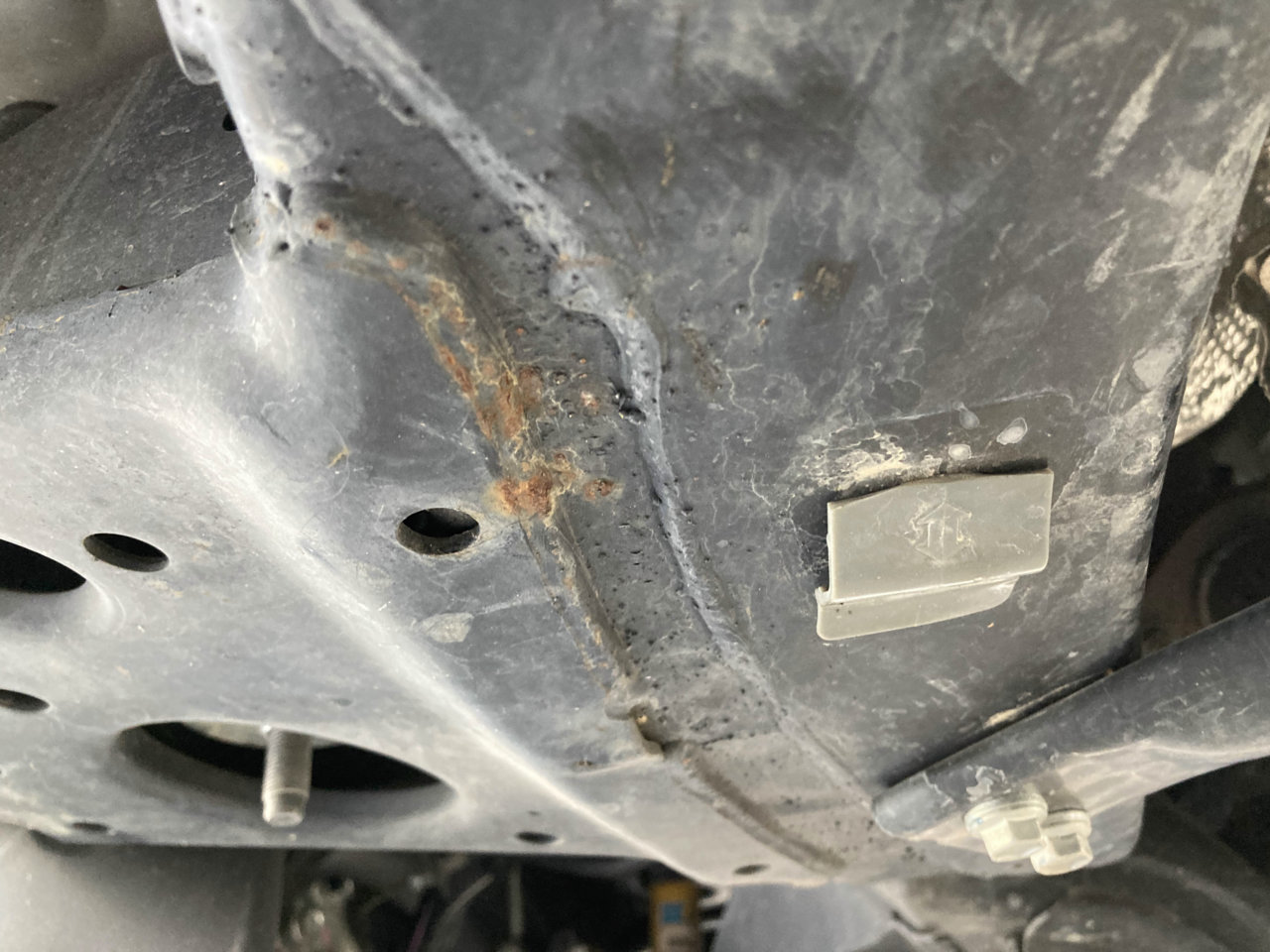

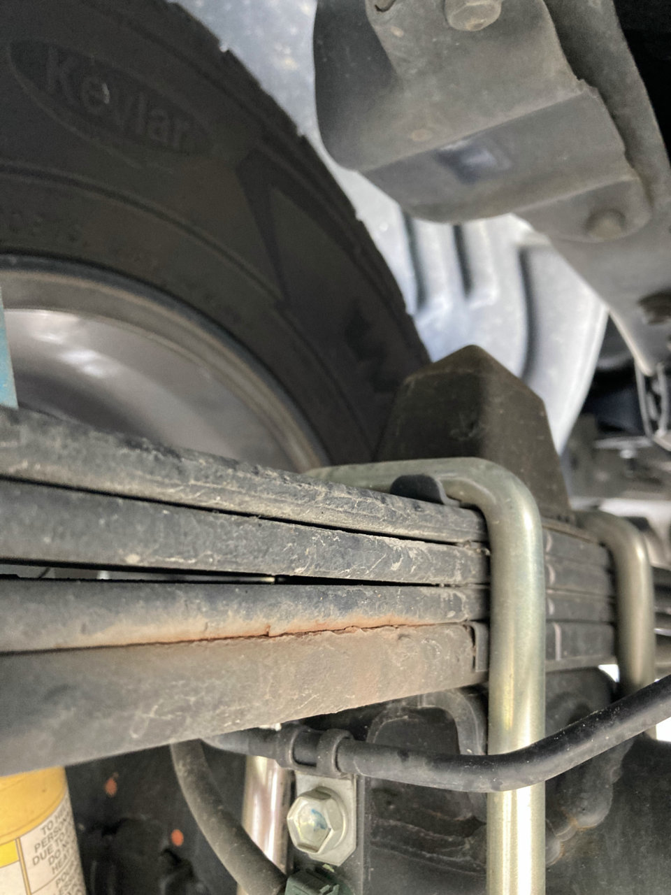

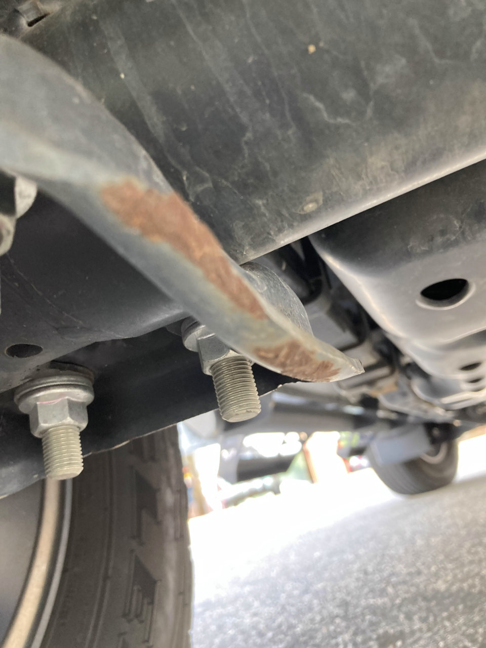

    2020 TRD Off Road - just noticed some rust recently. It was not like this a year ago. I can accept where some scrapes are, but noticing some issues creeping in. No salty roads here. Typical NC humidity but not terrible. Kinda bummed and not sure what to do to stop it. Thought about doing a test spot with DuraCoat.IMG_1848.HEIC.jpgIMG_1847.HEIC.jpgIMG_1846.HEIC.jpgIMG_1845.HEIC.jpgIMG_1842.HEIC.jpgIMG_1841.HEIC.jpgIMG_1849.HEIC.jpg

    Rust? Where? Your frame looks great.

    i'd spray off those rusty parts with brake clean, let it dry, then spray some cosmoline over it.
