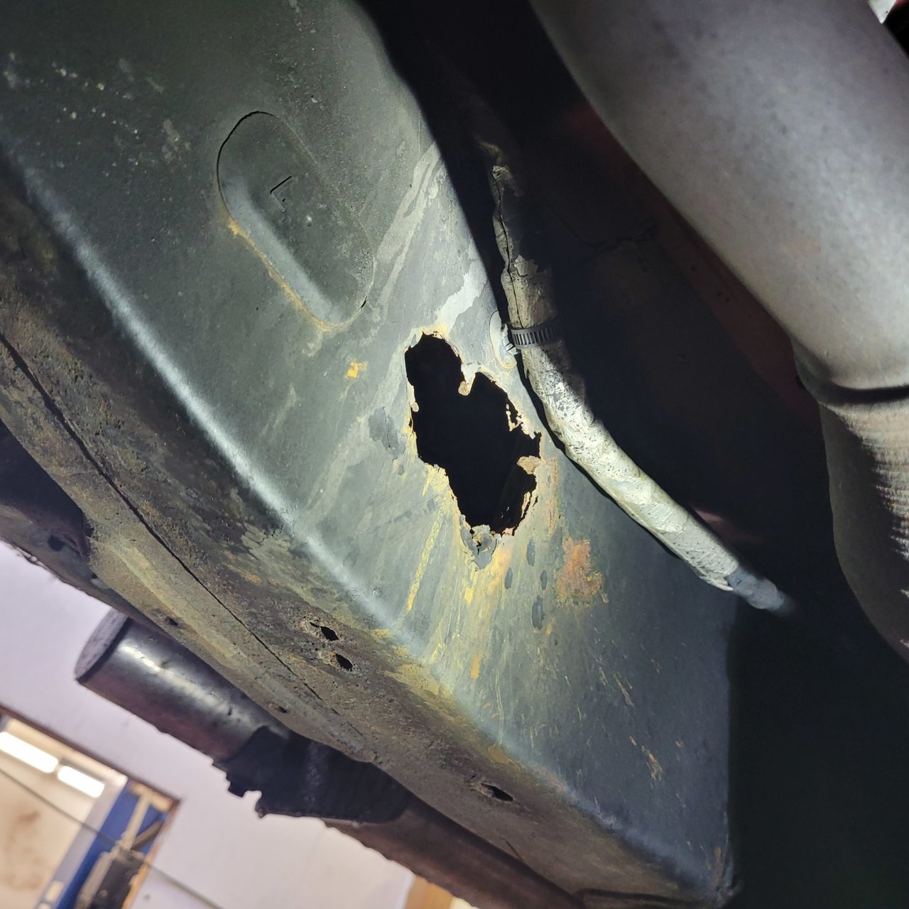

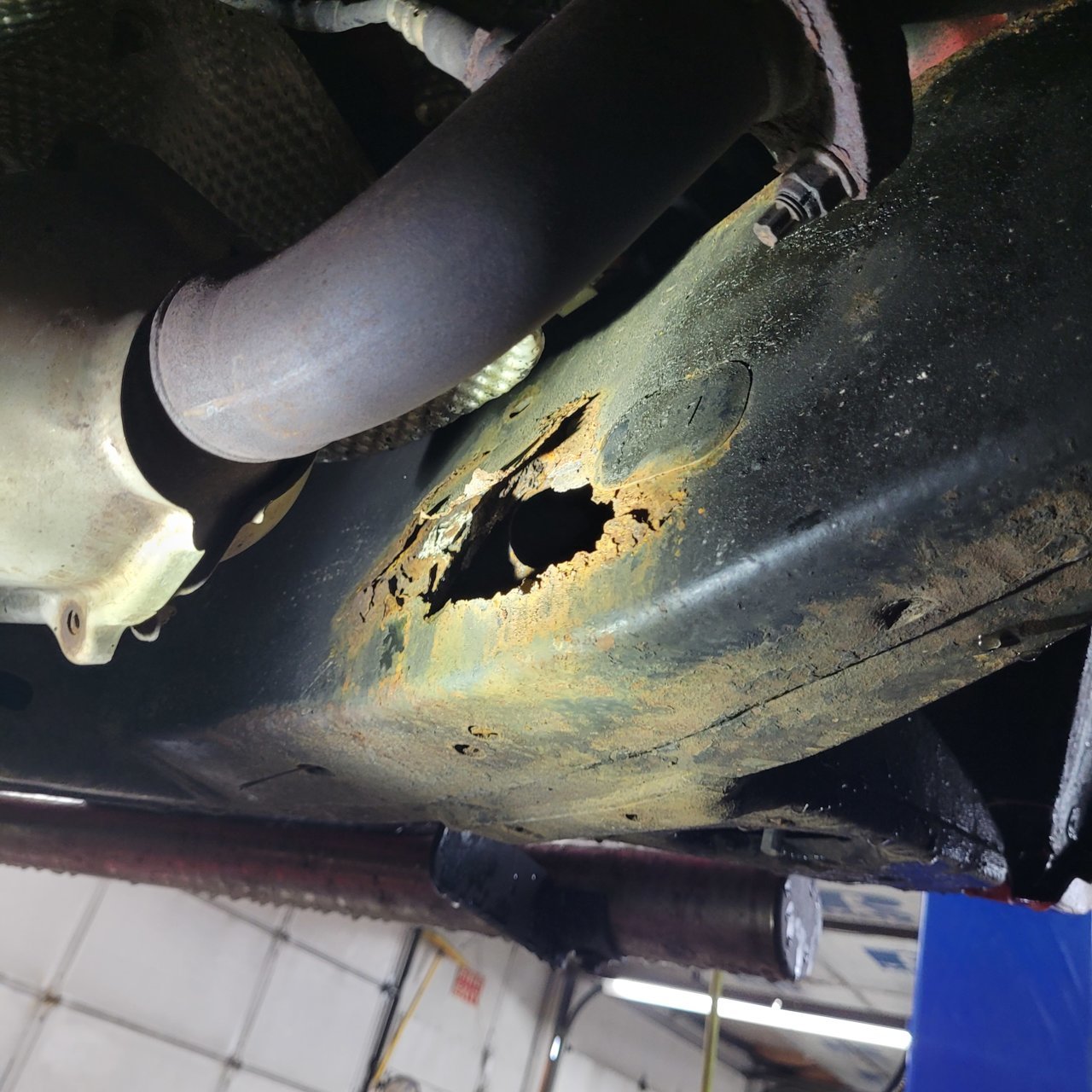

    Got my annual inspection today. And discovered that after doing everything right and taking care of the last thing i bought with my father. I have to either pay 10k or junk it. Can't in good conscience trade it or sell it.
    Called dealership and they would be more then happy to order me a frame but it ain't covered under the recall, call corporate if you want.
    Called corporate Ave was told due to the settlement they are not required to do anything either.

    It's not the end of the world. Do a search and check out some of the recent threads similar to yours where folks had those exact same rusted sections of their frames cut out & replaced.

    Find a good welder/fabricator in your area and have it cut out and patched.
    the overall condition of the rest of it doesn't look too bad based on the limited pictures you posted.
    I'd patch it and keep on driving it. What does the rest of the frame look like?

    Is that the area under the ac drain? I’ve heard of that spot rusting out locally, have the rest of the frame inspected. If the rust is only in that area I’d have it welded up by a local fabrication shop. They can easily plate the area with 1/4 steel and you’ll get many many more years out of the thing

    Like others are saying, if there are only a few spots then have someone patch it.

    That frame looks pretty good other than the giant hole in it. Just plate it. I have one truck that is so rusty you cant even weld to it. I just used gorilla glue when I want to add metal to it.

    Neither in a good area for welds. Especially do to the stain of the arms connecting directly on the other side of the frame in both spots.
    Your right about the patches being the only option though.
    Since the class action toyota is able to wipe their hands of all trucks created prior to 3/9/2010. By saying, "due to the court order legally I can't help you, oh but yes we know it is a manufacturer defect.".

    A good welding shop will make short work of that. Patch it and keep on riding.

    Cut and patch. Golden!!!!!

    Due to the sentimental value of the truck, plus today's vehicle prices. I'd say, if you can afford it, spend the 10 grand. Or if it's feasible to have frame sections replaced, do that
    That way you won't have the regrets of getting rid of it, and in today's market its a "relatively" cheaper solution.

    2005 TRD OFF ROAD 4x4 access cab 4.0 silver 6 speed manual
