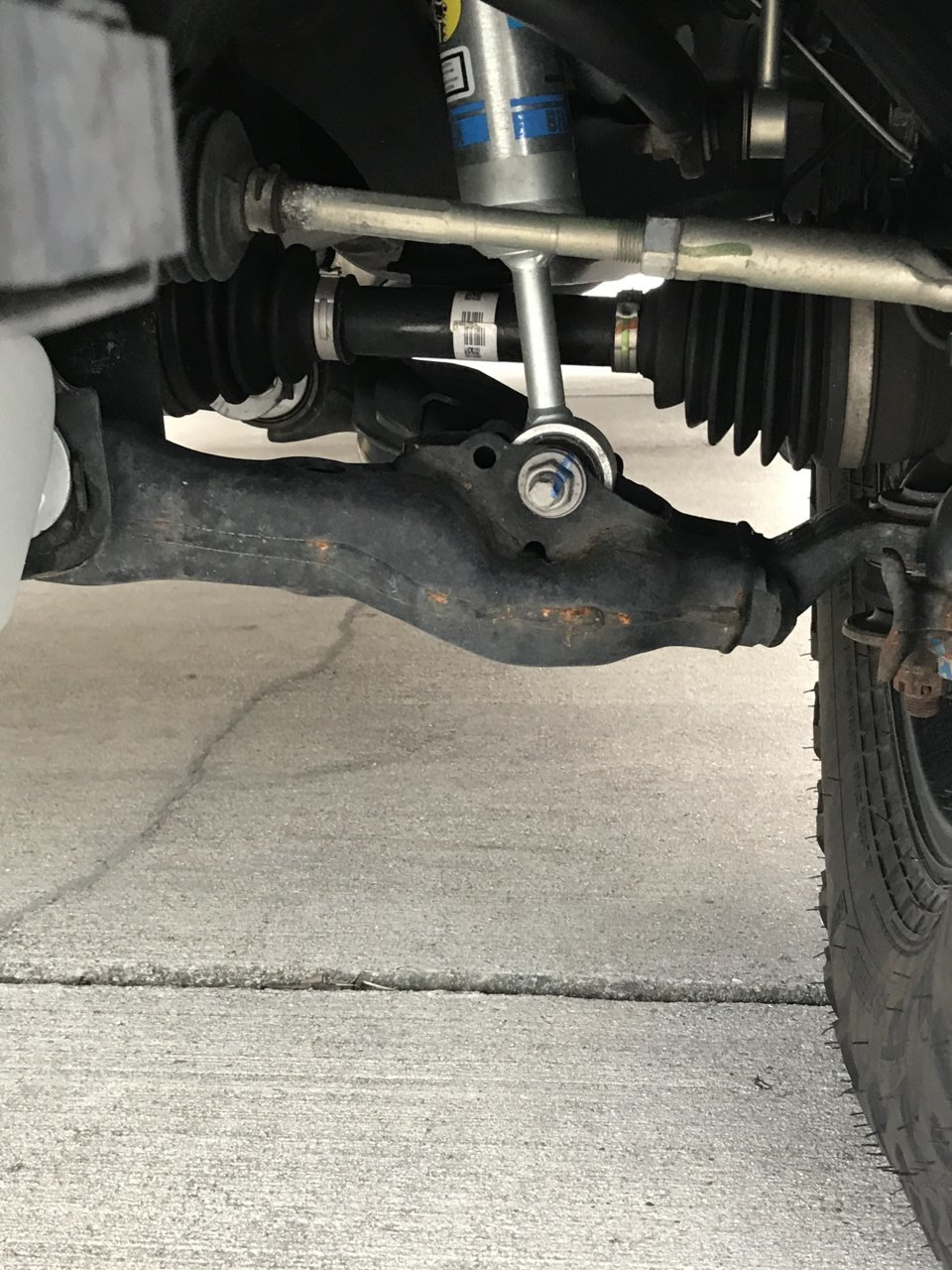

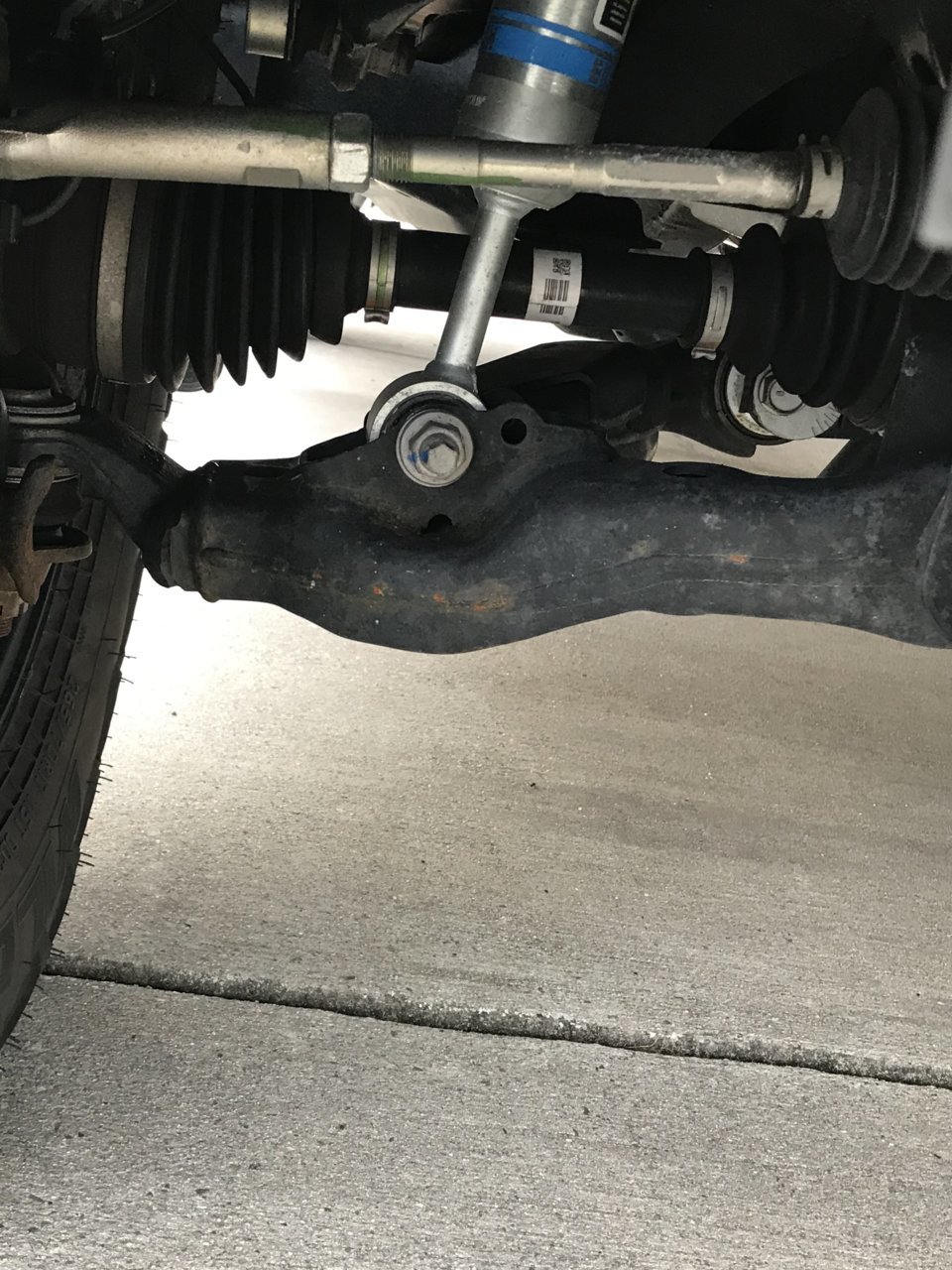

    I have a 2018 tacoma with 9,000 miles and I noticed the other day after washing the truck the rust spot on both sides. Does anyone else have the same issue?

    Surface rust at the welds. Normal

    That’s not a crossmember. That’s a lower control arm. If it bothers you just use some sand paper and black primer paint over it .
    I wouldn’t even worry about that.
    I would be more worried about that fragile ass lower ball joint mount. God every time I see it it makes me curse Toyota engineers. Uniball LCA all the way !

    While common for tacomas, it still recommended that you address it ASAP. Being in the north east, winter driving isn’t going to be kind and those small rust spots will grow to a much more concerning issue if not treated.

    Clean and paint. Or if you are in salt country, the whole undercarriage needs to be treated anyway, including the LCAs.

    My Taco had it. My Tundra has it. Ground and painted, then woolwaxed the whole underside for the winter salt bs. Rust happens, get it before it spreads.

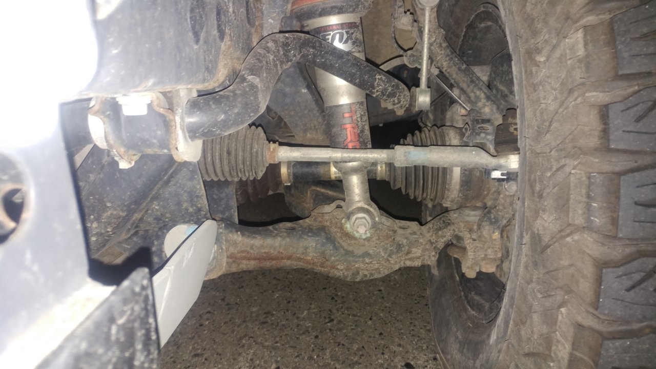

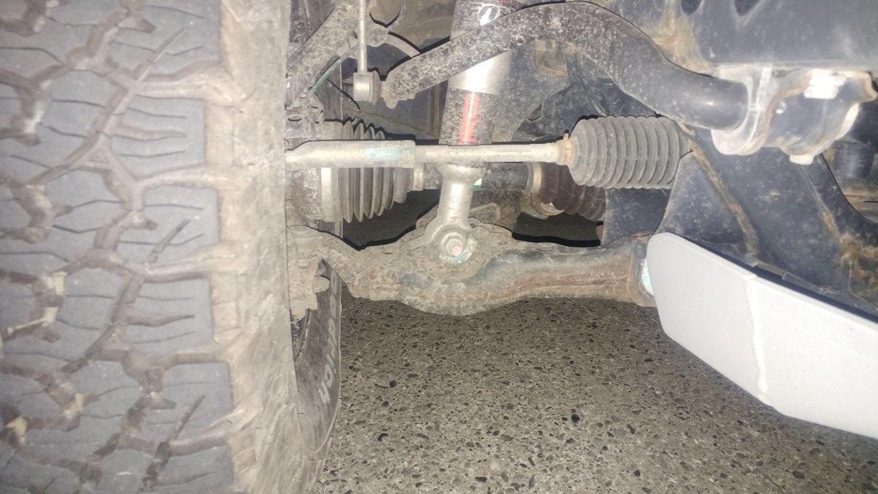

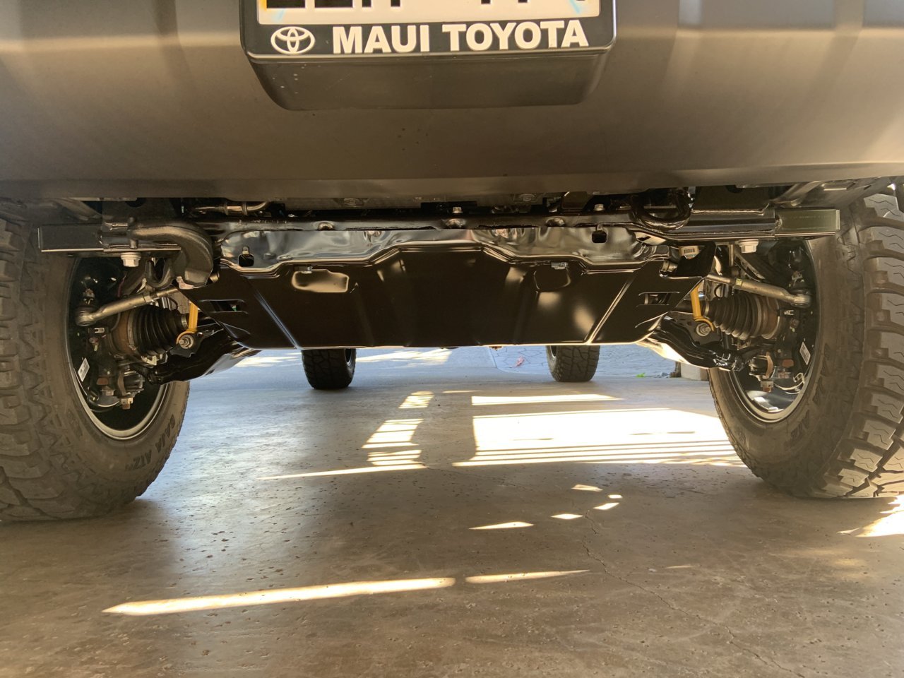

    Fluid film. Live near the beach, drive through salt water and salt spray several times a week.7CDD272E-7926-47B5-A3EE-EE64C0959BCE.jpg

    That looks so clean for a truck that's located in Hawaii
