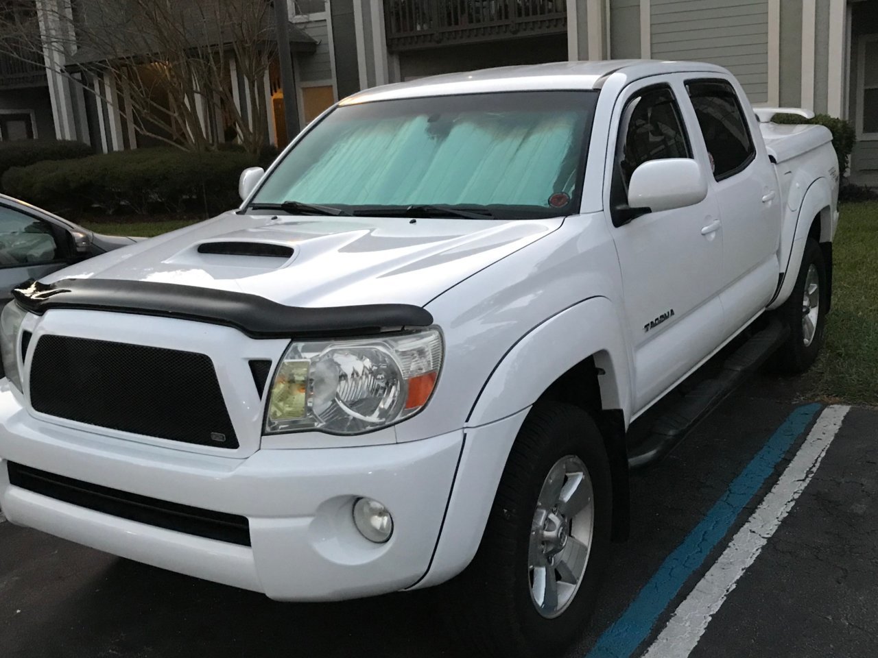

    Has anyone tried this new Rust-Oleum Factor 4 Synthetic Wax? It's billed as an "Electrofusion synthetic car wax" and is supposed to be high gloss and long lasting.
    I have been using Turtle Wax Paste since I bought my truck 12 years ago . Every other year I clay the truck then apply Turtle Wax Ice . I build up a couple of coats then apply a wax on tp of that. Seems to have worked pretty well and the truck looks almost showroom new.
    They changed the original formula a couple years back and now Turtle Wax Ice paste is hard to find in stores around these parts and even online ordering its hard to find. I guess it takes some work yo use and people didn't buy it. I've always been happy with it and got excellent results. Twice I've ordered and Walmart never was able to fill the order after a couple of weeks and reply it is on backorder, but it never seems to come in.
    So I came across an ad for this new Rust-Oleum and just wondered if it's worth trying.

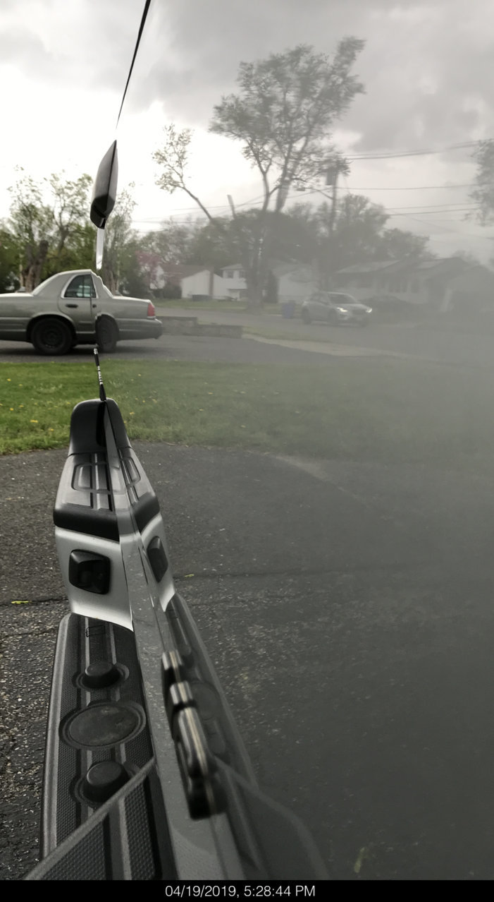

    If you really want awesome results buy a DA Polisher and take the time to buff the paint out. You will be amazed on how the paint will look. Ive been using chemical guys stuff along with there butter wax and im sold mirror finish 60BB8136-4039-44A5-9E17-1B0535119F3B.jpg

    Nice! I thought about buying a polisher years ago. Many times I wished I had one. But I'm old school. I do everything by hand Some times it takes me two or three days I get a little exercise and get outside in the breezes coming off the ocean. Besides I'd might go hog wild with it and burn the paint or the darn thing might overpower me and spin me around a few times.

    The polisher isn’t for applying wax or removing wax. The polisher is used for correcting paint. It is nearly impossible to burn the paint with a DA polisher. Now a rotary on the other hand that is a different story.
    I get the old school aspect but seriously there are better products out there that require less effort. No, I am not being lazy but when I have 3 vehicles to maintain my time is precious.

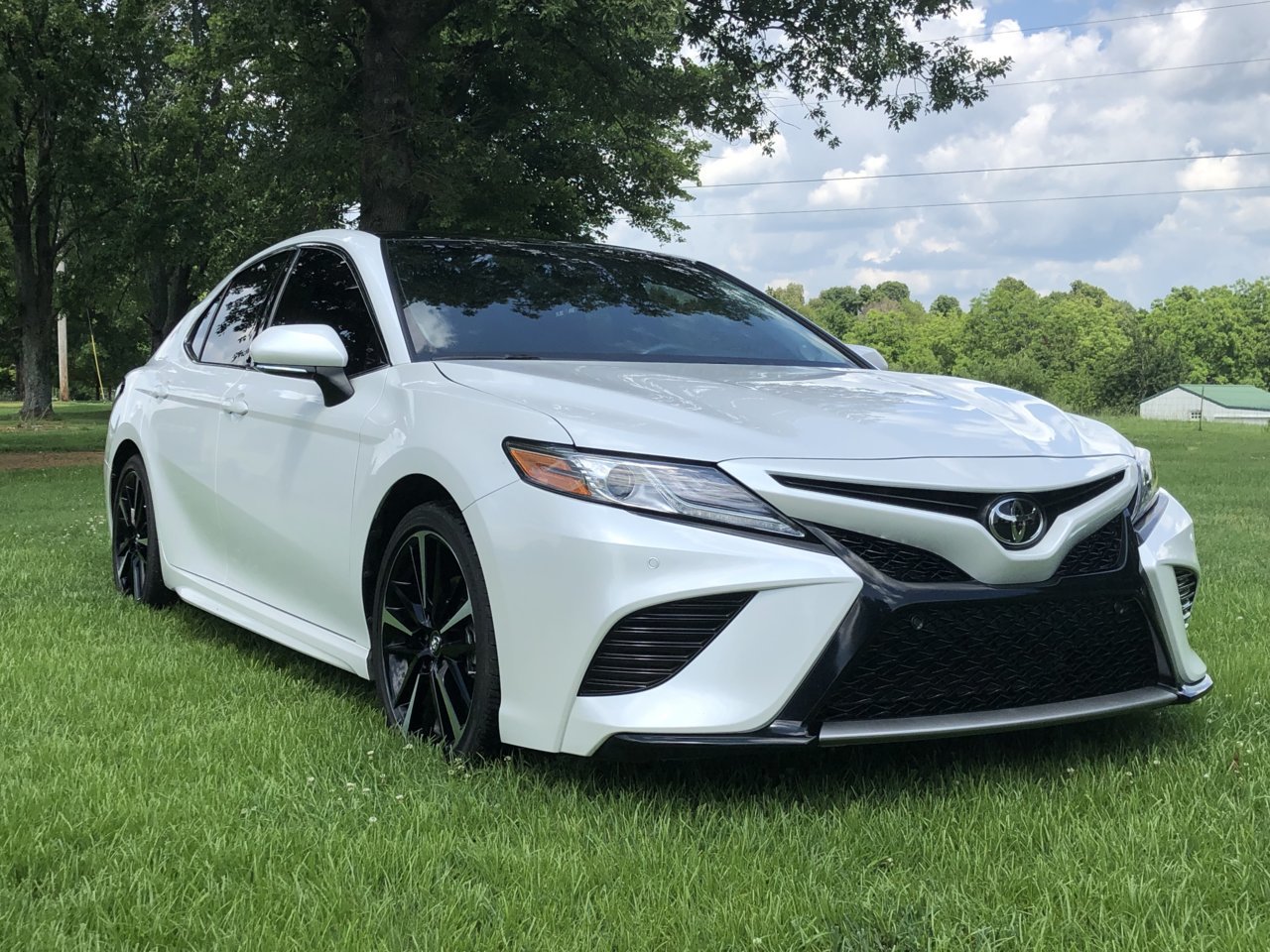

    Ceramic hands down over wax any day.

    That does look sharp! So on old/faded paint, wax will kinda bring it back and hide some imperfections. Does the ceramic stuff do that? Or is it more for newer paint/vehicles?

    Old/faded paint needs to have the paint corrected in order to fix the issue. The wax is only a temporary fix. You can use ceramic on any paint. I have never used on faded paint since I have a polisher. Besides cars for the most part have clear coat. If the paint looks faded it’s due to loss of clarity and that requires a paint correction.
