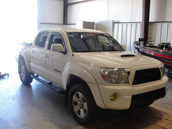

    I just finished painting stock skid plate. I know it dosen't really do shit but I wanted to give my truck a little different look and I love the black on white look.

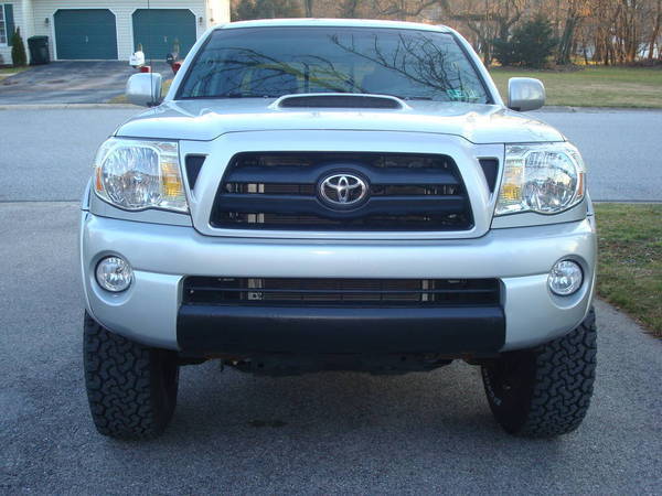

    Keep going, pain the Valance with the same paint....

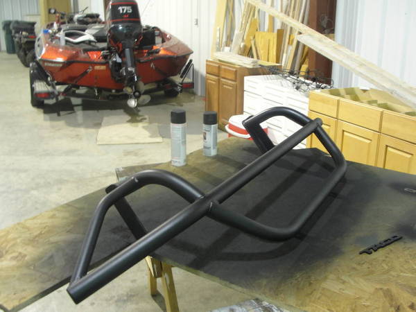

    i just painted my valance and avid light bar with the stuff. that stuff works great!

    Taped it off and painted it right on the truck!
    I lightly sanded it before painting, just break the surface of the clear coat and you'll get good adherence.
    BTW, I used Duplicolor spray on bedliner.

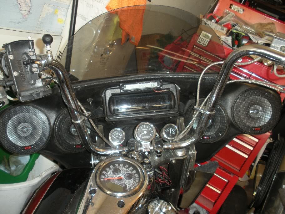

    Here's an example of the texture from 2 coats of the Duplicolor rattle can:
    I used the stuff on the front bumper cover on my '03 Tundra after the paint started chipping on a Caliber-painted replacement after an accident. I wasn't happy with it. I scuffed the paint well, but I was still out there touching up that cover every few months... it just wasn't durable on the front surface.
    The spray-on bedliner paint is intended to be used for "touchups" in small areas that can't be reached with the roller/sponge when applying the canned Herculiner type products.
    I've used the stuff dozens of times on various items, and it's a great product as long as you understand it's limitations and weaknesses. I've used it on a steel entertainment center that I welded up for the big screen, the motorcycle fairing and a couple of other parts, and intend to use it to create the base texture on my center console after I replace my bench with buckets.
    But on the front of a truck? I'd go with something more durable.

    i lightly sanded then used dupli-color self etching primer then hit it with very fine sandpaper again and then sprayed on rustoleam spray on bed liner. im pleased with the look/texture
