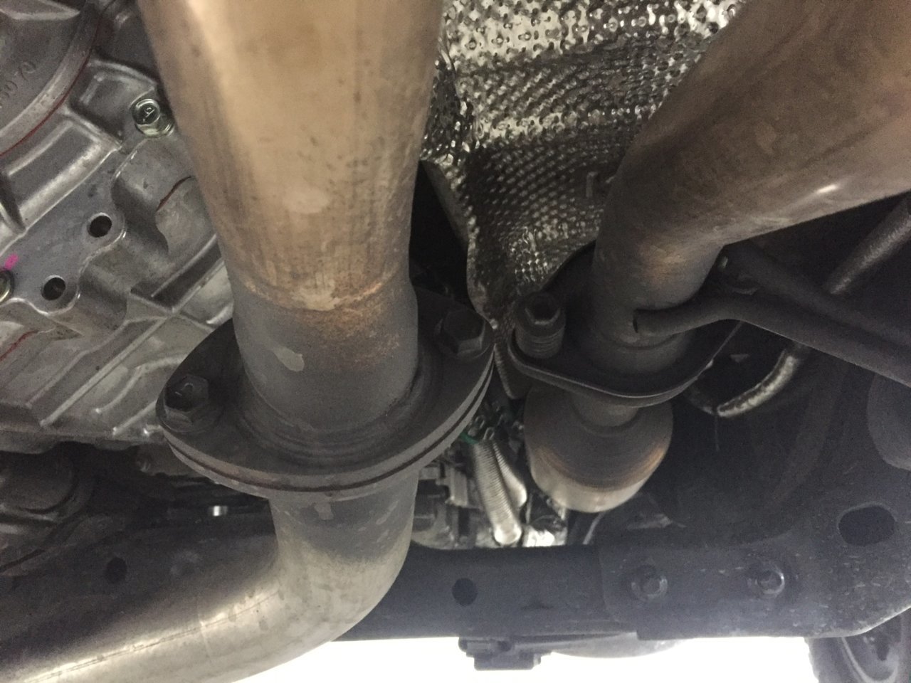

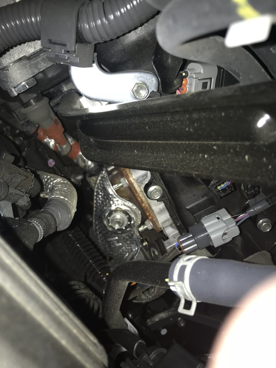

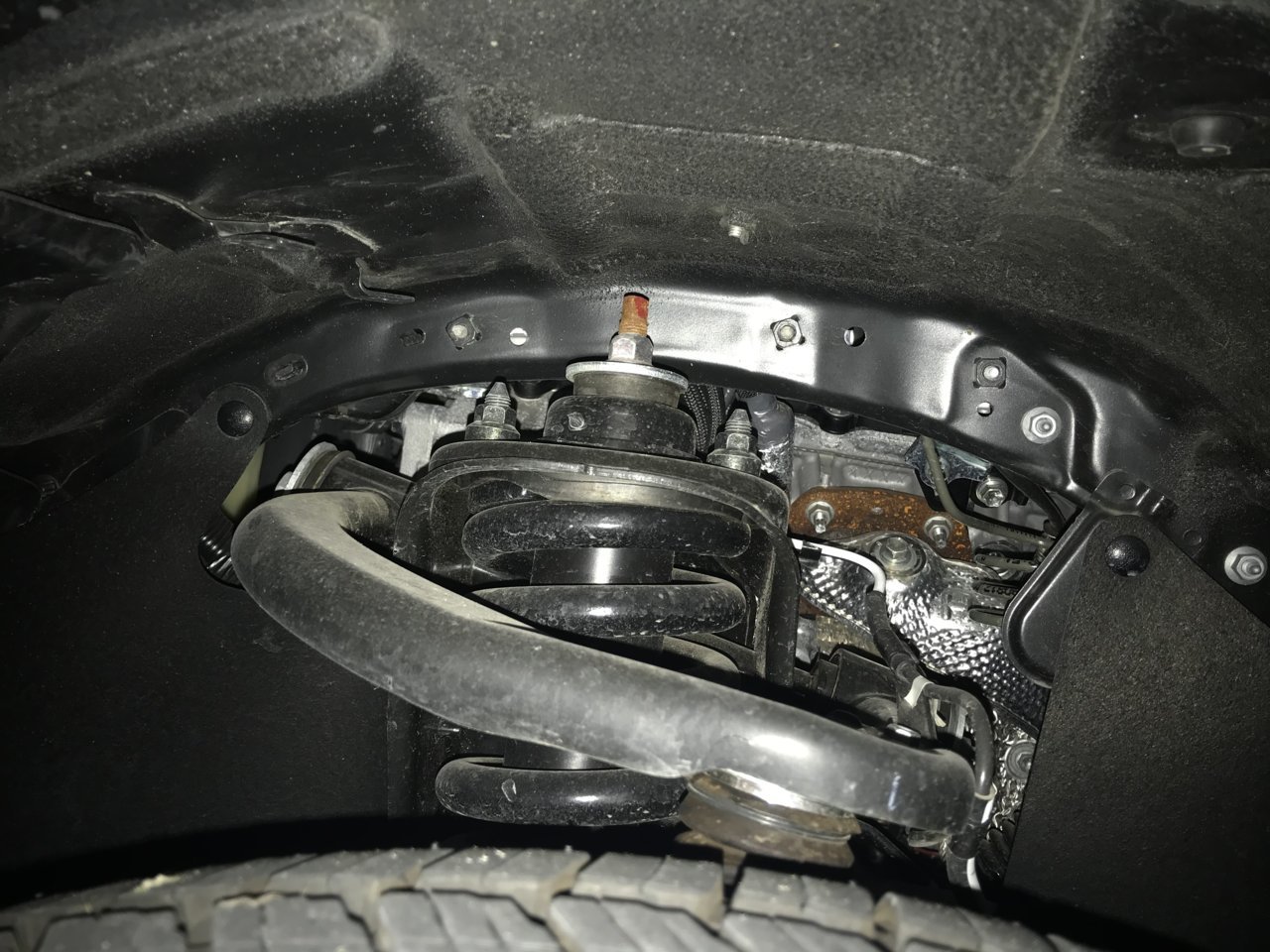

    I am a newTacoma owner!! I just bought a new 2017 Tacoma TRD 4x4 sport. It runs loud in lower gears and it just stalled at the dealership. They reset the code and couldn’t find anything wrong. Said let us know if any issues. Finally I noticed some rust in the wheel well on some metal pieces. Truck only had 12 miles on it. Is there any reason for me to be concerned? Should I push for it to be fixed or is this normal for a Tacoma?i6E5A3F7C-FD6F-42D3-BBDA-ED6E8A78CD16.jpg 4FFEB3DC-6D1E-4A20-9BB1-C1FBD878893C.jpg 7651CF7D-6D96-4810-B64A-D7EB7BB4C8CB.jpg 6E5A3F7C-FD6F-42D3-BBDA-ED6E8A78CD16.jpg 7651CF7D-6D96-4810-B64A-D7EB7BB4C8CB.jpg 4FFEB3DC-6D1E-4A20-9BB1-C1FBD878893C.jpg

    Exposed steel is going to rust. That said, the exhaust flanges on my truck are rusted well beyond what I would expect for a 2017 truck. Those puppies are
    made out of some cheap-ass steel.
    Best you can do is spray it down with a preventative like AFC-50, Kroil, Fluid Film, etc.

    Holy smokes.... lol
    That is normal!!!

    Probably gets too hot to keep any kind of lube on there. It's all down to the quality of metal used. Maybe an extreme high temp paint would have helped?

    Will just burn right off and your truck will smell like ass for a while, and leave your flanges with a permanent blackened seasoning.

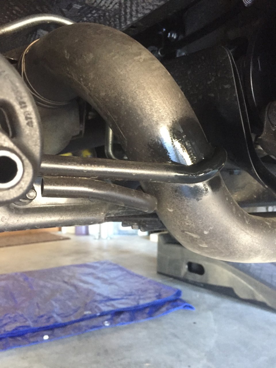

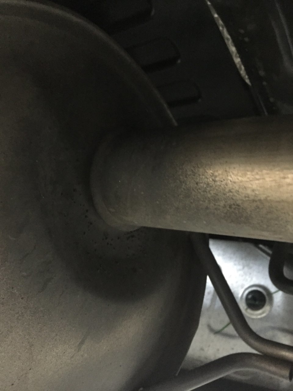

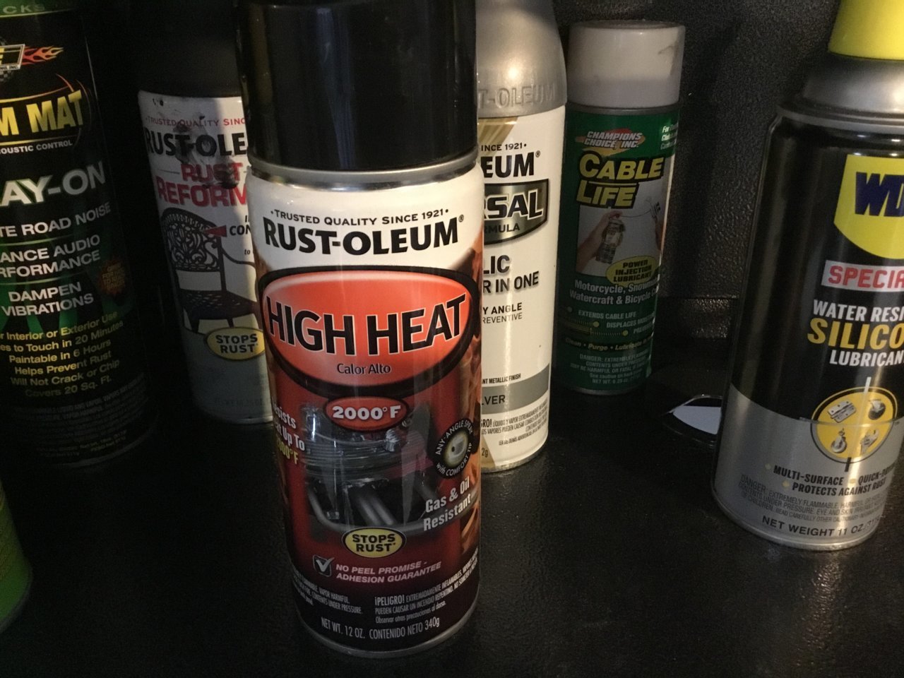

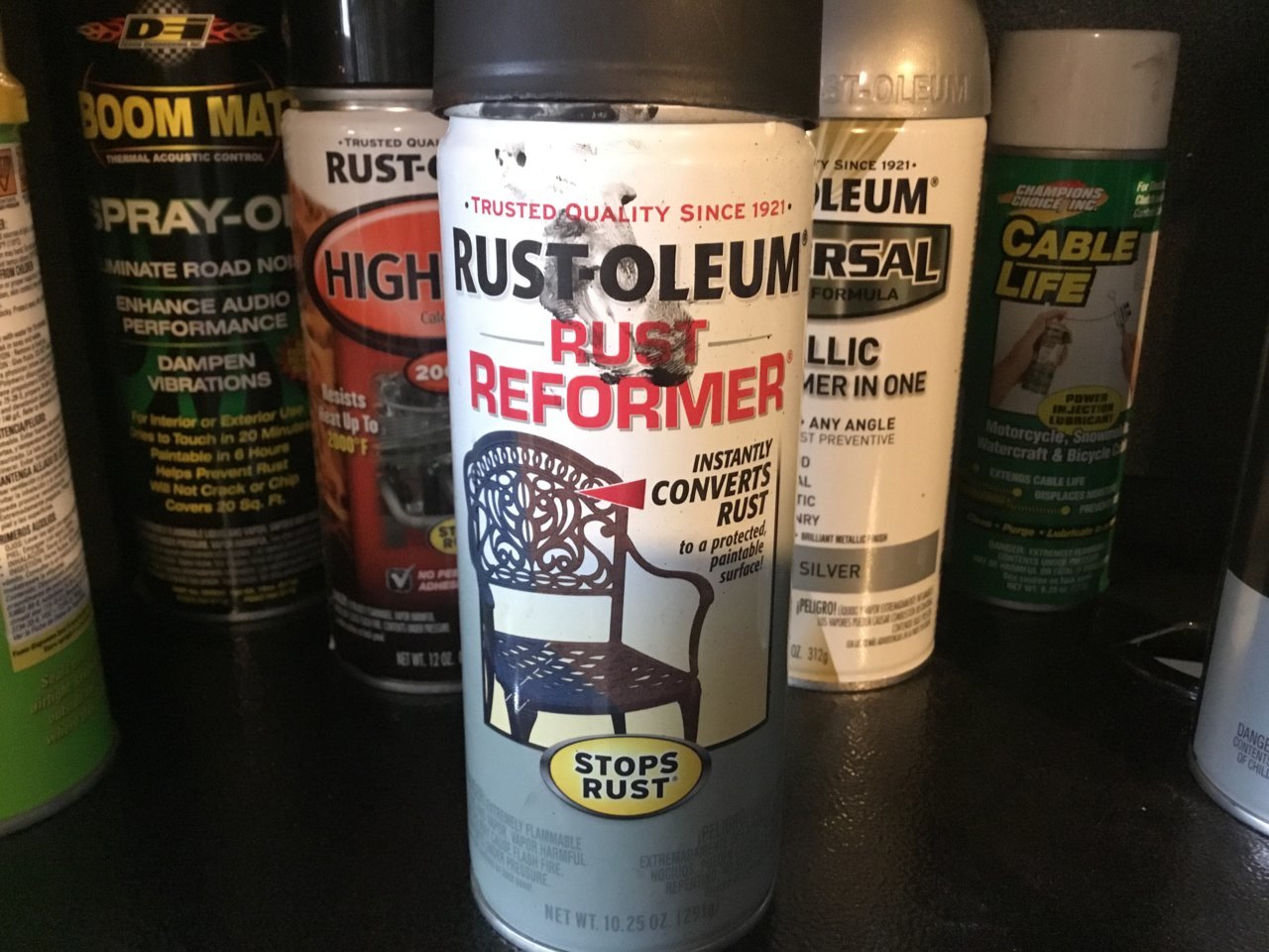

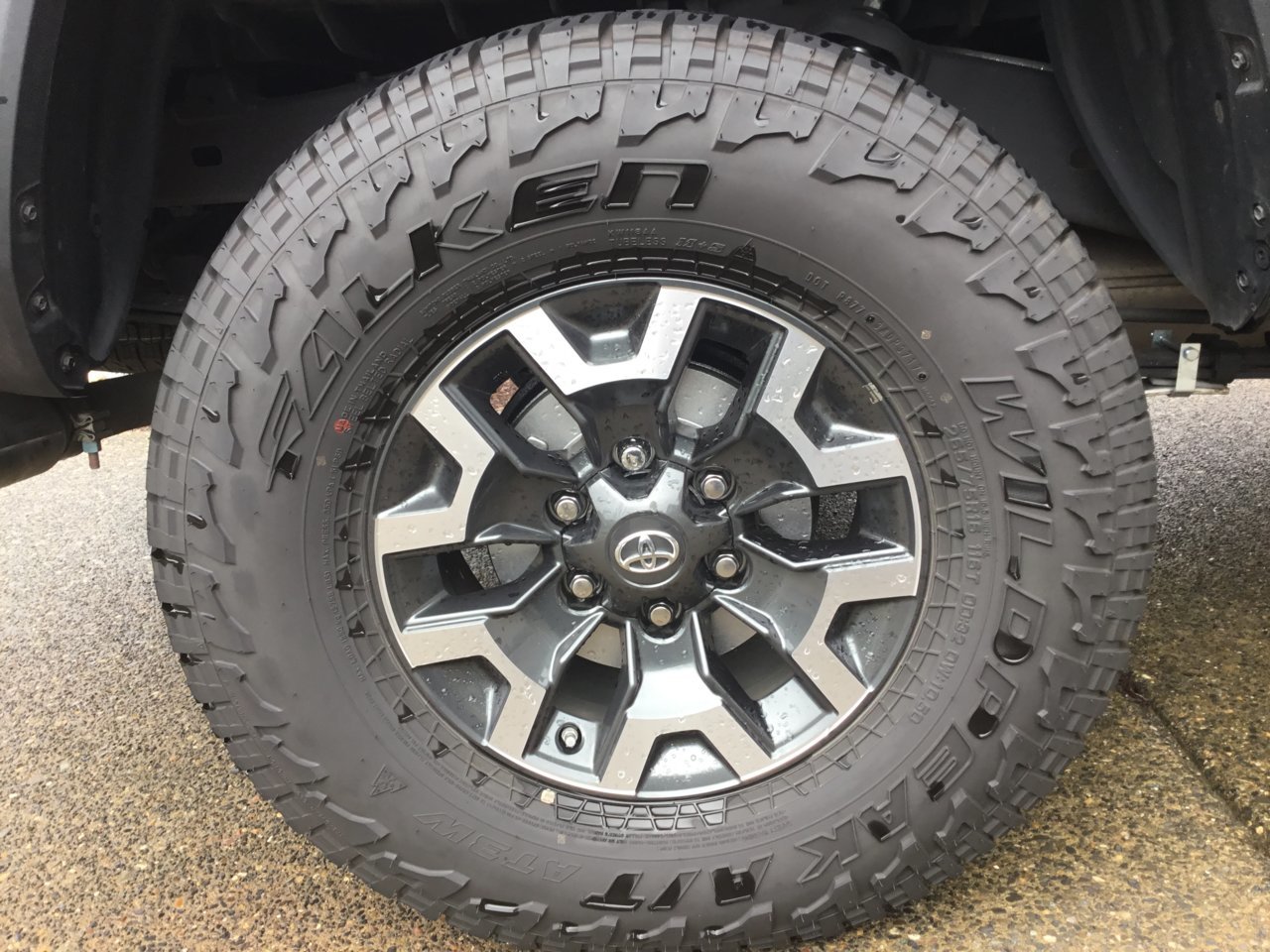

    If salt isn’t used in your area, rustoleum and high temp paint work well and touch it up every year. Less messy than oily films.
    Rusty on the inside, black on the outside of exhaust.
    Sprayed drums. Helps to keep rust layer from forming on inside of wheels over the years.
    3CC94D9A-94CD-4362-B520-B1991D97D176.jpg 26F43926-5751-4CFE-A8F1-9BB82BCC6BF9.jpg 57DF1B48-64A0-44EB-9E3D-D9C6932676B8.jpg 76AA930C-CAFF-42DA-BDBC-E0222C11589C.jpg C746543C-C19C-4960-B175-234EA84968E0.jpg

    Keep the rust at bay and touch it up once in a while.
