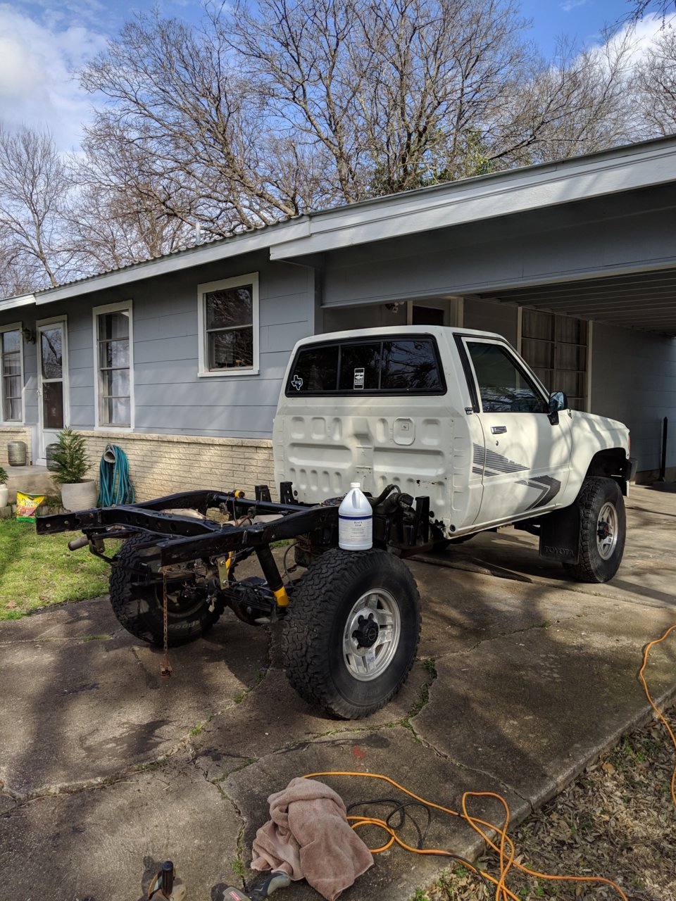

    I have an 80's Toyota 4x4 that came from Colorado with a decent amount of surface rust, I lightly knocked it down with a wire brush and used Blackstar, it's $80/gallon but we'll worth it to me. I tried a few other products first and basically consider my $ wasted on them since I've found Blackstar..IMG_20190203_153546.jpg
    Blackstar only before any paint, you don't have to paint it but I ended up doing it anyways

    Blackstar is another of the rust converters. I've used a half dozen of these products, but never Blackstar. They do work very well for stopping rust on exposed steel. I'm sure some are better than others. YouTube has dozens of videos on these products, but no definitive video showing which is best (not that you can trust YouTube videos, LOL). The only thing I don't like about them is that they don't wick well into the folded metal areas like door skins and under rivet/bolt heads. That is where FF nd the other oil based products shine.

    I am pretty impressed with it, used it on my 2019 welds at 3,500 miles which were starting to orange up a little already
