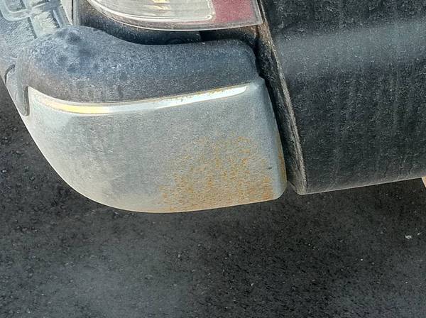

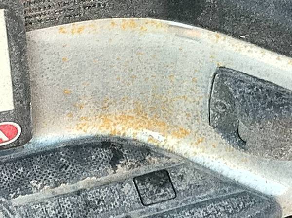

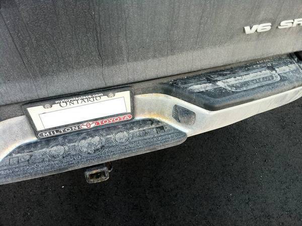

  9. Jan 3, 2011 at 10:13 AM
    #29
    Sighless
    Sighless Well-Known Member
    Mar 29, 2010
    #34219
    107
    TORONTO
    10 SR5
    just came back from my dealer, they tried to tell me it was stone chips.. i asked them to show me a stone chip on the bumper.. Their repsonse? the stone chips are so small they cant see them, but they are there!!
    i asked for the service manager, he came out looked at the truck from about 6ft away and said order a new bumper..
    i tried to play it out and tell them i didnt want another chrome bumper, i wanted something painted, or even the black bumper off a base model.. but the were very persistent that i had to receive the same chrome bumper that came with the truck..
    They also mentioned if the second one rusts out, after my 3 year 60k warranty is up they will not replace it..
    [​IMG][​IMG][​IMG]
  10. Jan 20, 2011 at 11:56 AM
    #30
    Spindrift
    Spindrift Member
    Apr 23, 2010
    #35824
    8
    New Brunswick , Canada
    Tacomo SR5
    Hey Dude, I bought my SR5 V6 in August and I just about s*** when I seen the rust on mine the other day. I tried to clean it off thinking I had got into some road grime somewhere. It does not clean off easily so I have left it and will be seeing the dealer about a replacement , ( not a clean up). This should not happen. Let's keep everyone apprised of what we find out.
