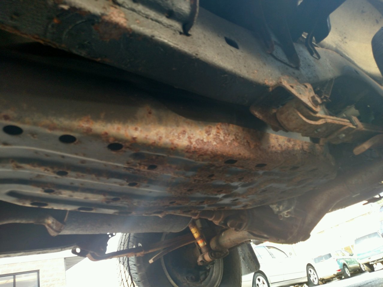

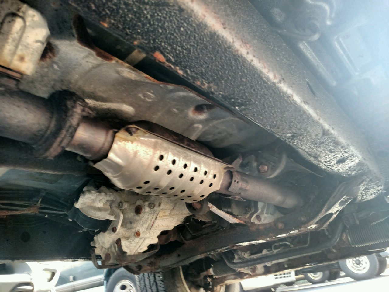

    Good price, crazy low miles on this late model Tacoma. They said it was inspected by a Toyota dealership and they said it was just surface rust. They have paperwork from Toyota. I don't trust dealerships so I wanted to know what you guys thought?
    I would be buying this to build an overland rig.
    Thoughts?

    I'm no expert but that doesn't look bad. The main problem spot is right we're the rear leaf spring connects to the frame and that looks good. I would take a hammer and test it before I bought it tough.

    Unfortunately I cant. It's in another state so if I buy this truck its 100% gamble. One owner truck, super low miles. Its the rust that has me worried.

    If you or pay someone to refinish the frame I'd go for it

    That get's a big nope from me. That looks terrible.

    What state is the truck in? Do you know if it spent any time in the rust belt? What year is the truck? That doesn't look bad for a 20 year old truck

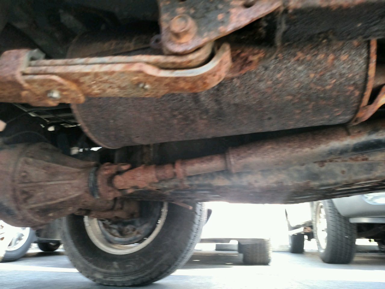

    Its not just the frame, look at the rust on every nut and bolt. That thing is going to be a pain to do any kind of maintenance

    Philly, PA. 03. Definitely in the rust belt.
    I am considering everything.
    So many mixed reviews!

    Sorry man. I'm looking at the same pics you are. See if you can find a third party to inspect it in person for you.

    Frame rust doesn't look bad.
    low mileage on a 14 year old truck in philly may mean it's been a stop and go queen.
    Issue with that is, most consumers do maintenance on cars based on miles not hours of operation. Idling time needs to be considered with maintenance.
    having lived/driven in both NYC and philly for the majority of my life, I wouldn't buy a used car that spent 10+ years in local traffic and local weather.

    Stay away from it. Spend your money on one with no rust.

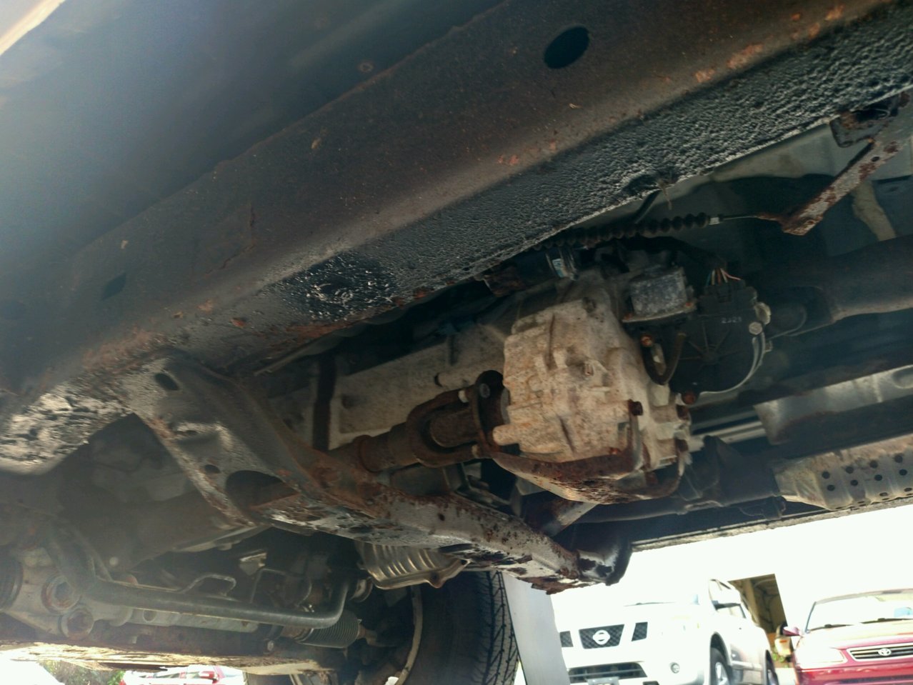

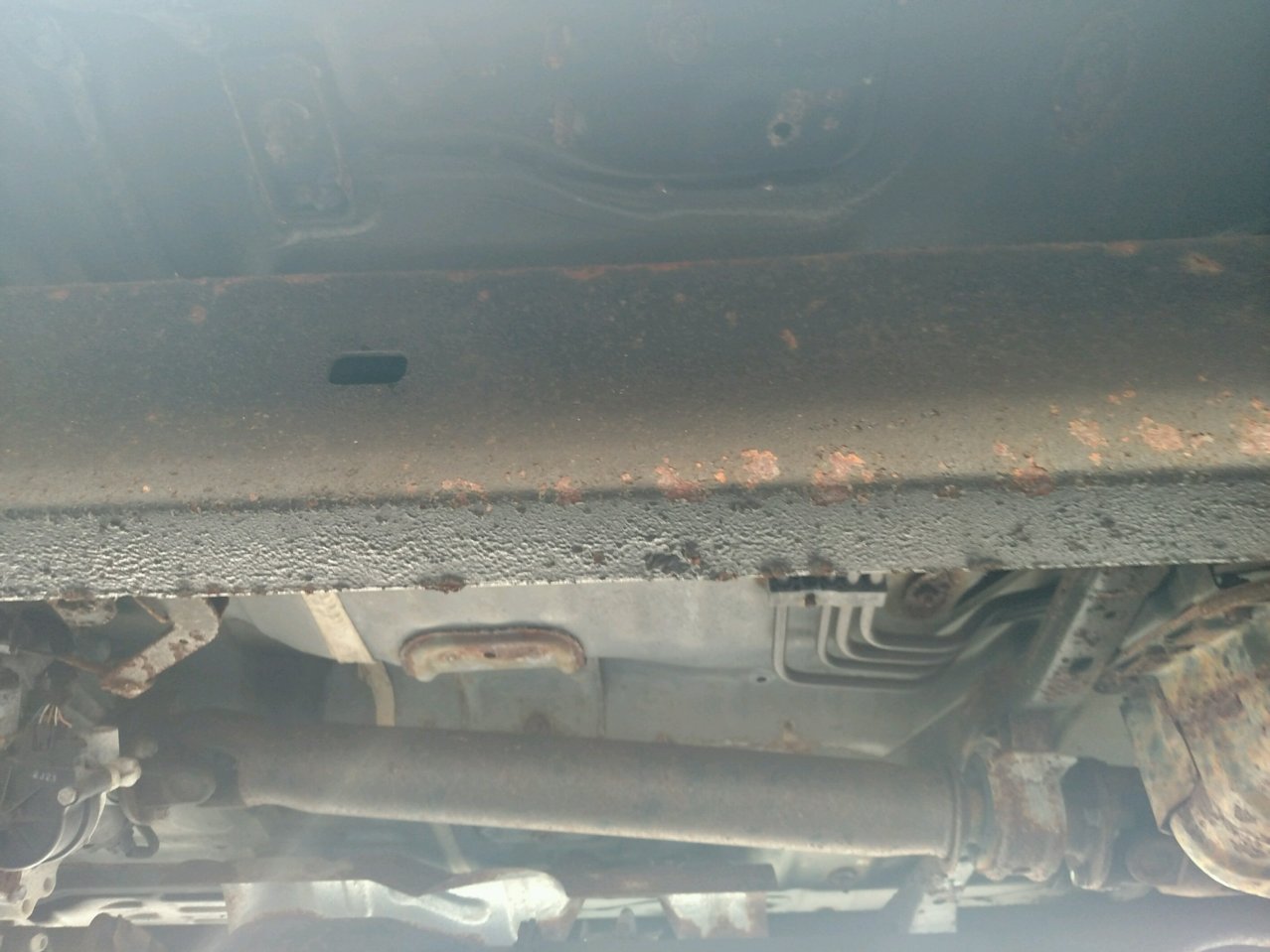

    Doesn't look bad for a cold weather state truck of this age
    Though, I would definitely want to bang on the frame with a hammer, just to be sure.
    The critical areas to check are:
    where the leaf springs attach to the frame, right behind the cab, as this is usually the first spot where these frames start to rot
    Frame rails by the gas tank and catalytic converter, as these are commonly rotten spots on good looking, but rotten frames
    Also, poke a finger or something through the square holes on the frames rails to see how much rust chunks and flakes there is in there. If full, not a good sign, but the hammer test is what is really going to tell if the frame is good or not.
    Can look okay from the outside, when inside it isn't okay at all.... If buying this truck would be a gamble for you because you can't find anyone to check it for you, you should pass

    Wow, some parts look like were stored next to Titanic.:eek:

    I'd pass, but I'm a rust phobic. One it starts, it's like a cancer. It's not just the frame, everything looks rusty under there, and I'd be especially cautious with the sprayed over areas.

    The frame does look solid, I wouldn't worry about that.
    But that's a lot of surface rust all over everything down there. I'd hate to have to work on / unbolt anything.
