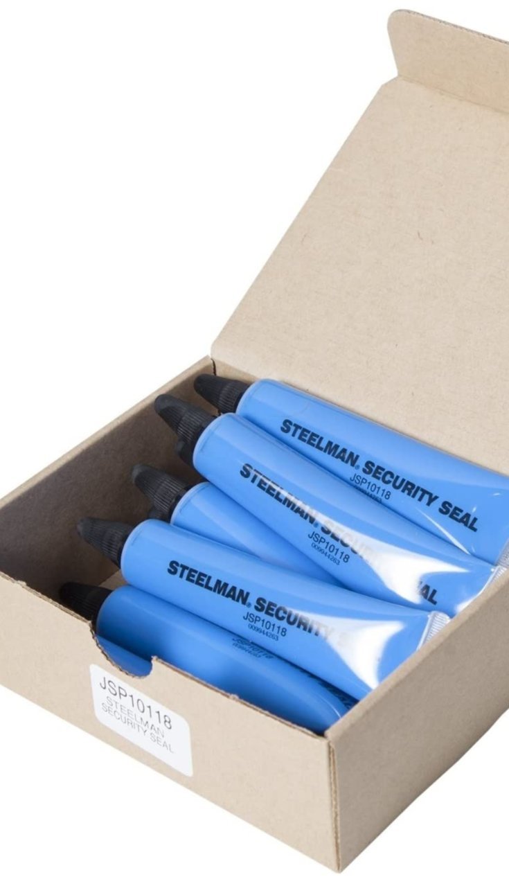

    265/70/17 ATs on 17x8"wheels and 0 offset Morimoto XB LED Fogs Reinforced tailgate 2011 Honeycomb grille URD Short Shifter and cue- ball style knob
    The blue stuff is likely just a tamper seal. If the oil was changed at a quick lube or box store type place corporate requires the techs to put it on any drain plugs removed. Then if someone comes back and says you forgot to put oil in, you owe me a new engine, it's obvious when someone has drained it.
    Same idea as torque striping a bolt, just run a bead from the bolt onto the pan or whatever the bolt is secured to and it dries/hardens so if it's moved it breaks. Pain in the ass when people glob it on then you can't get a 6 point socket on it next time
    Here's the stuff we used to use when I was doing oil changes in college
  16. Oct 22, 2022 at 5:32 AM
    #56
    Too Stroked
    Too Stroked Well-Known Member
    Jan 24, 2017
    #208501
    3,922
    Tom
    South shore of Lake Ontario
    2021 4Runner SR5 Premium
    Old trick to get you into the Service Department so they can recommend all sorts of (expensive) stuff you probably don't need. There is indeed a cutoff date on the program (12 years from the first in-service date) and unfortunately, your truck is well past it.

    @VXEric huh...like an anti-tamper seal...never seen that before, but Ive always changed my own oil..interesting in the days of people being "Im suing you" happy, makes sense!
    VXEric likes this.
