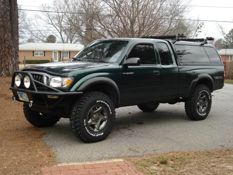

    this is pitting and that means it has worn through the clear and paint on the wheels. you'll need to do some sanding and prep to repaint and re-clear if you want them looking like new.
    https://www.youtube.com/watch?v=ksWqmlXlDMU
    can also use the excuse to change the color like so
