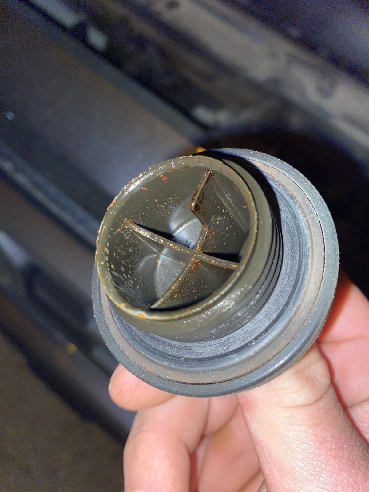

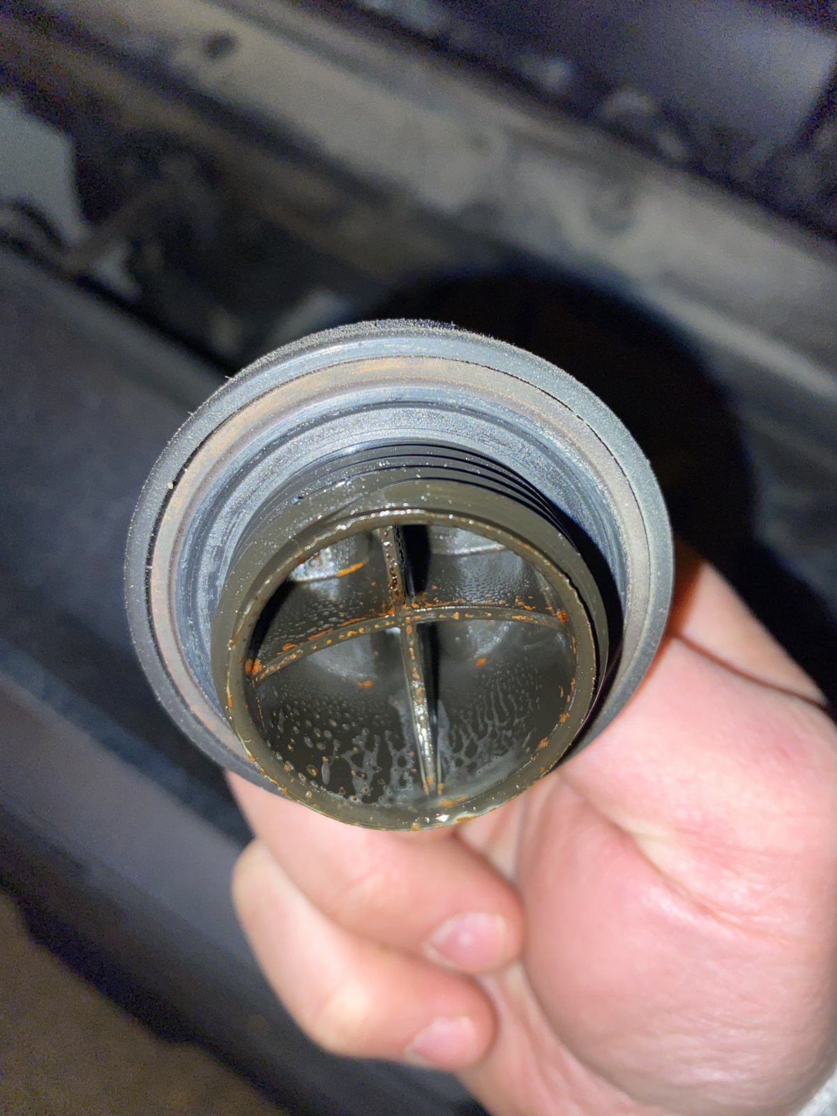

    Hi, I was doing a general inspection of my oil level. I checked the oil cap and noticed that there were rust particles and a little moisture coming out of my cap do you have any idea if this is normal or not. I read on other forums that this could be completely normal in winter, thank you.

    Condensation is completely normal and that's a minimal amount to be honest.

    Are you making many short trips without the engine get to operating temperature? If so try to occasionally make longer trips.

    Normal.
    Nothing to worry about. :thumbsup:

    Whatever you do don't look down the oil filler tube lol. I don't have winters so it must be normal everywhere. I'm sure it has to do with the filler being a tube and an area for vapors to get trapped.

    Oxygen + water + plain carbon steel = RUST
    This equation is undefeated in the real world and is accelerated when heat and salt (even in the tiniest of quantities) are added.
    That's perfectly normal, but I would make sure that cap is screwed on tight.

    In a cold climate, I would change oil after winter is gone and regularily take some longer highway trips to burn out any condensation.
    Before pvc systems when there were only road draft tubes, one would have the oil dipstick full of a milky froth.
    And that was before synthetic oil. No wonder engines didn't last nearly as long.
