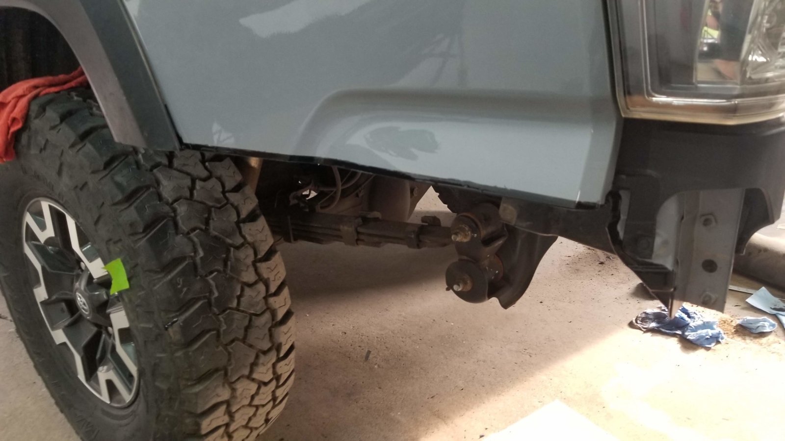

    Hi all. I'm getting ready to install a high clearance rear bumper on my truck that requires cutting the bedsides. Living in the salt belt, I've been debating what the best strategy would be to protect the cut edges from rusting. Looking for opinions on what others have done in the past, especially those that deal with salt, and who have some years and evidence of how it held up over time.
    Some options I've considered:
    1. Prime with self-etching primer, finish with rattle can
    2. Prime with POR-15, finish with rattle can
    3. No primer, use Toyota touch up paint pen, finish with clear coat touch up pen
    4. No primer, coat with Steel-it
    I'll be adding edge trim to help protect the edges, so the underlying result doesn't need to look pretty since it will be covered, just needs to keep my bedside from rusting out (hopefully for the next 10-15 years). I've also debated goobering on some Fluid Film or silicone to encapsulate the edge (after painting) before adding the edge trim.
    Any suggestions? Thanks in advance.
