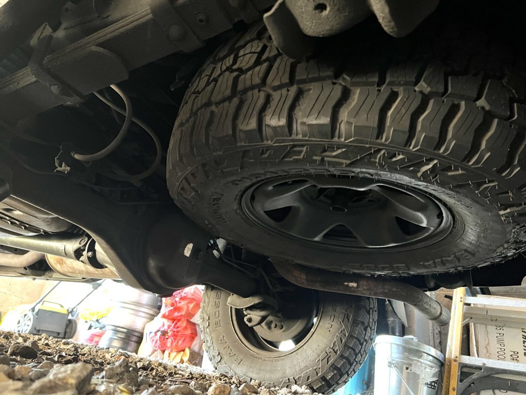

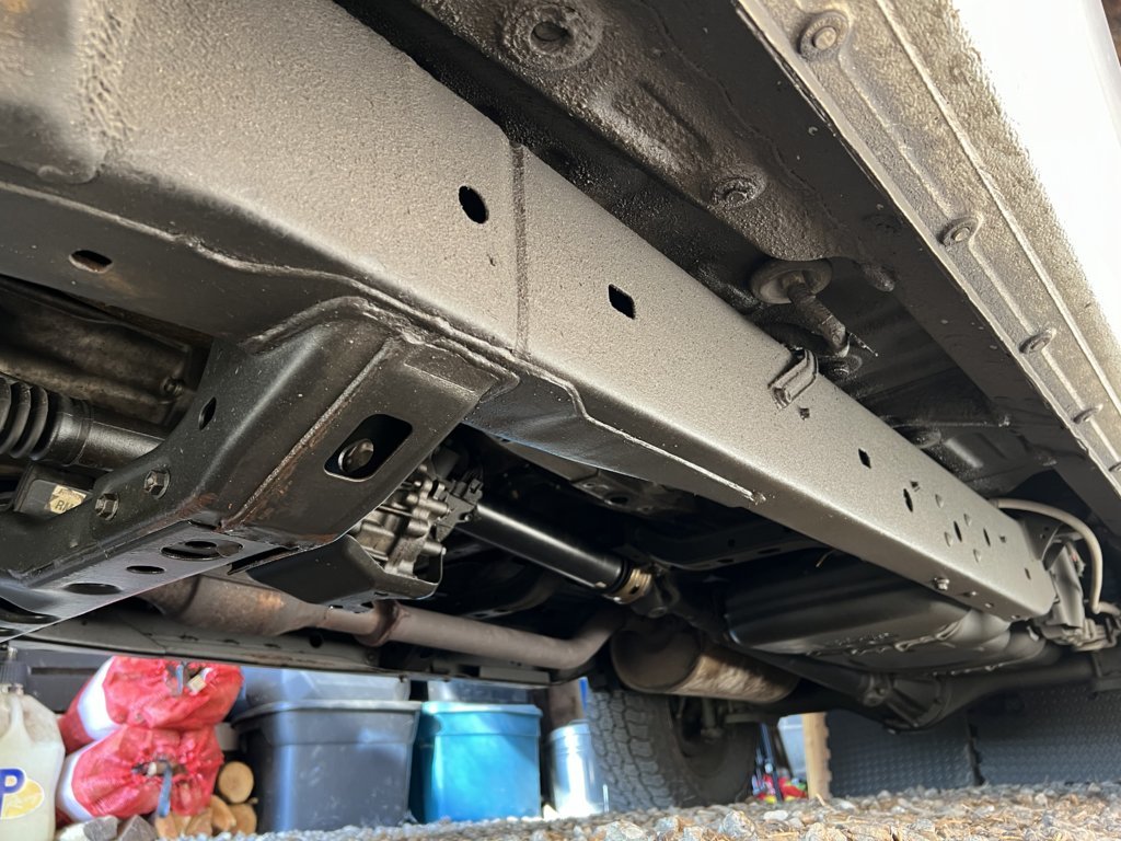

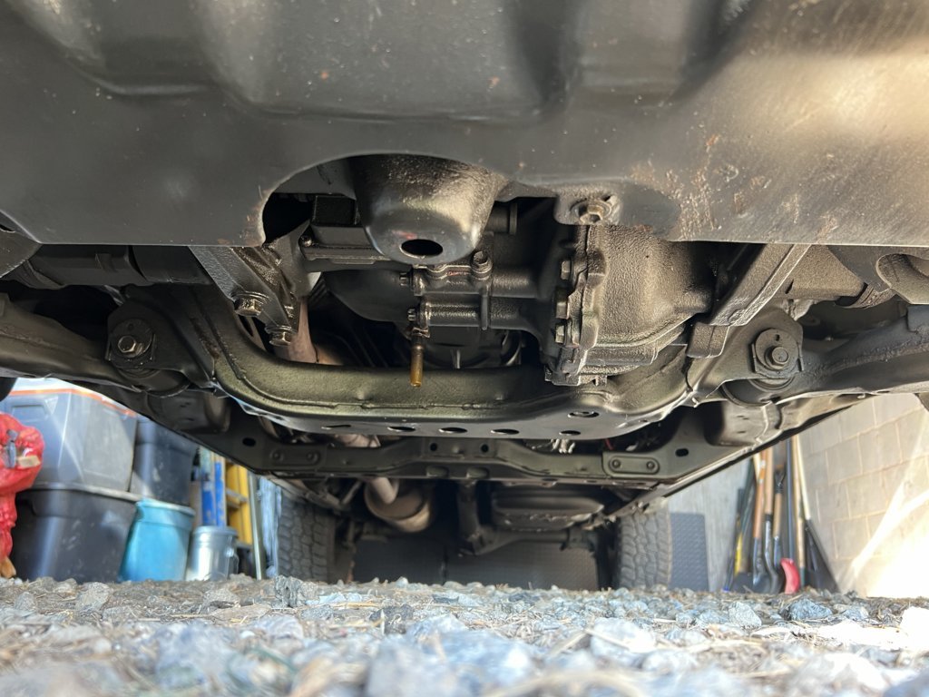

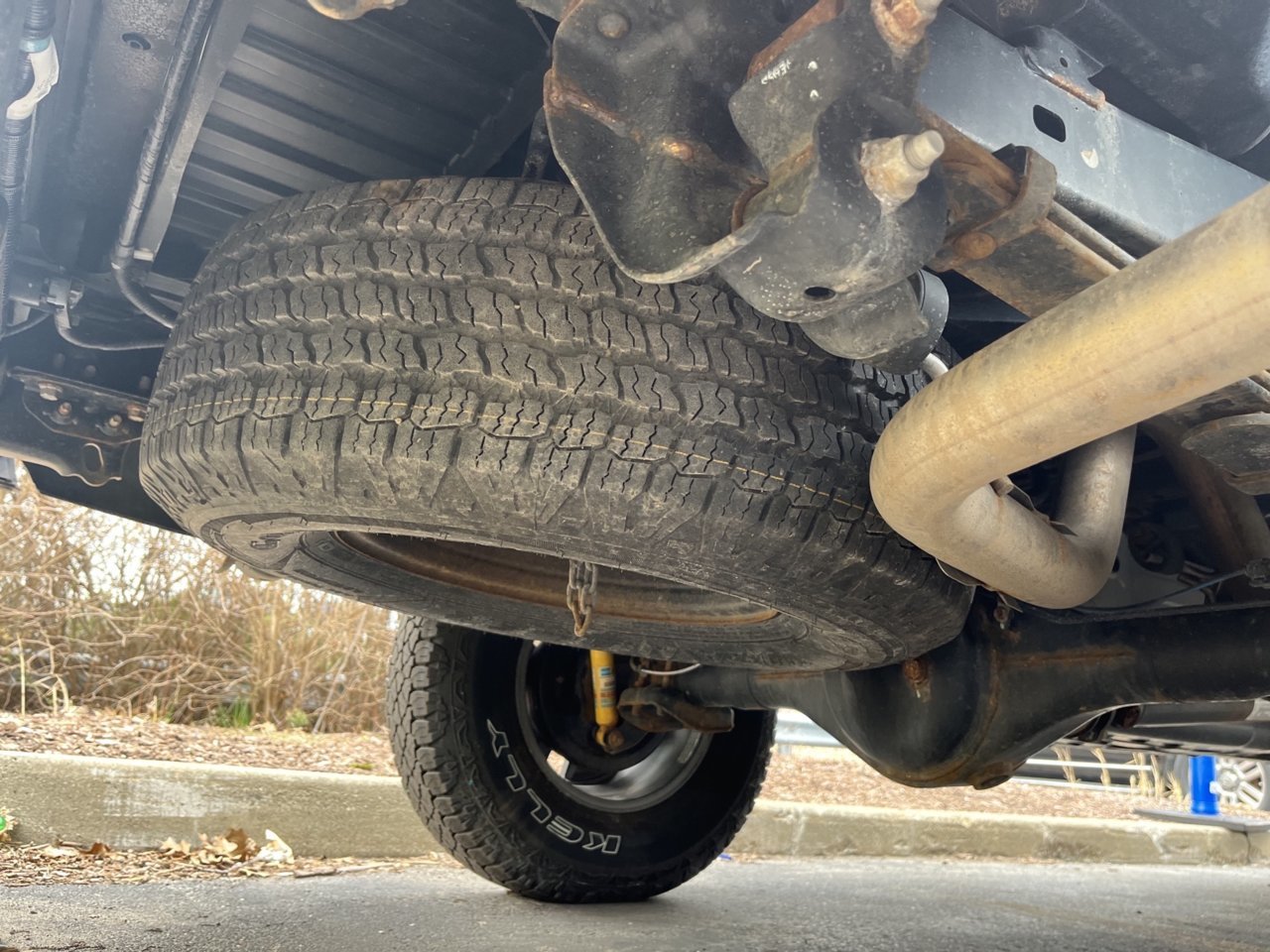

    New Hampshire Oil Undercoating treatment from a dealer at Kalispell, MT March 29 evening and picked up the truck March 30 morning. Glacier Undercoating's owner, Guy, explained that they plastic bag the exhaust system before shooting the product, so there will be no odor of product burning from the exhaust and entering the cabin. He was pleased when I told him that I'd removed the spare before my five-hour drive to have the frame treated, and due to the low miles and having been garage kept, the hot water pressure wash cleaning ($100) that I was prepared for was not required. $275 (still no sales tax in good ol' Montana, has been a saying there for many years). I will be typing up the small print list of area Uber drivers that I found at my hotel shortly before I was to pick up the truck, which should be helpful. Nice folks and this is a sideline business as their primary work is in construction. Guy went through NHOU's extensive training program, and they've practiced on their own vehicles quite bit before going public. We talked about making their location easier to find without generating too much demand, so future signage will likely consist of larger address numbers on the road frontage. Great experience and a nice spring break trip, breaking up the driving so that the first leg of five hours was the longest. NH Oil Undercoating's website provides great background information on the products, training and instruction, foundations of the company and product, and an interactive dealer map so I was pleased to find that one of the dealers west of the Mississippi was close enough to visit during spring break. Great weather last week, and this first week back at my K-5 school is back to near freezing nights with chances of rain and/or snow.
    Spring has sprung! (Long time reader of advice, first rustproofing treatment.)

    Looks reasonable, but there is no substitute for crawling under there yourself. They still only pee-coat the frames with black paint. Be sure to check the frame right next to the Cat/converter. That's where mine needed to be welded for a fix.

    I agree. Crawled underneath this afternoon to hoist the spare back up under the bed 8 days after NHOU protection treatment, still thick, adhering well but not solid since come smeared on the back of my fingers when I brushed against the hitch cover. Nice thing about the food grade base oil, is that a wipe with a paper took that little off my hand. It looks great under there! (better there than coloring my hair! So I stayed well clear...) Sorry, I could not resist the rhymes. Determining the thickness of the metal requires closer inspection, particularly in the tighter angles and crevices, which may also be stress risers. It would be nice to look at the other side of the steel from the outside rust areas.
    The "For Stock Rigs Only" forum had a post that included a short video clip of a Taco that jackknifed leaving a gas station, broken between bed and cab, heading down the road held together by the driveline. Reminds me why I like burritos better than hard shell tacos... :rimshot:

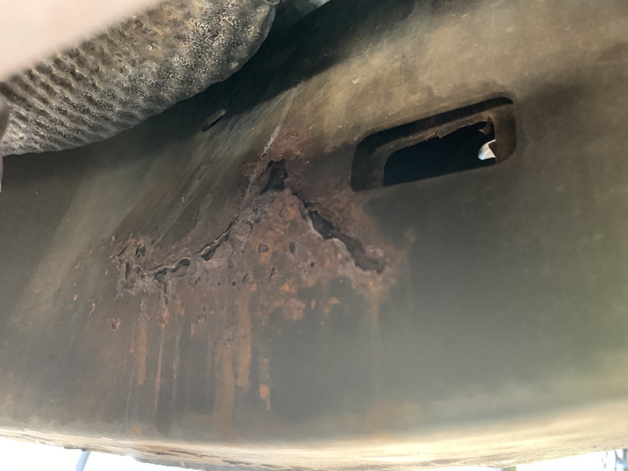

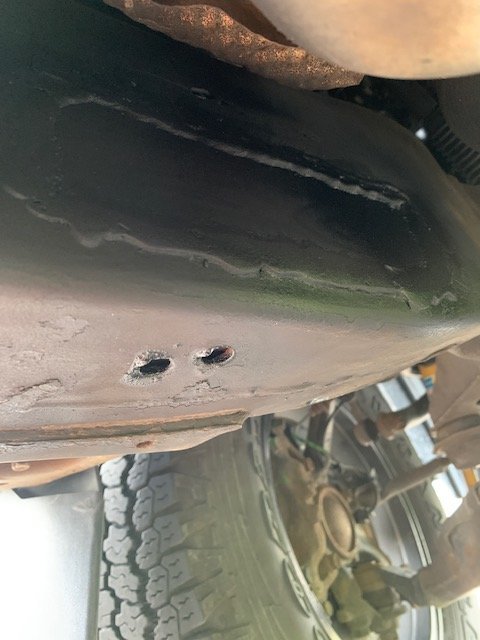

    I don't know if I posted these images her, but these are before and after the repair. The shop primed, painted and undercoated the area.

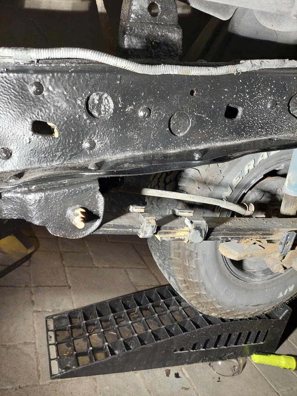

    20221021_203714.jpgHi guys, just looking for some opinions about the frame on my 2008. The frame for the most part is in excellent shape, except for the rail section beside the muffler and gas tank.
    I noticed some delamination, so as you can see in the picture I got rid of the rust between the rails and coated it with por 15. Just wondering if it looks safe enough to continue driving, or should I be looking at repairing it?
    I gave the sides of the frame a good hammer test and it seems solid. Thanks for any thoughts.

    I just had my 2005 at my mechanic up on a lift. We went over the condition of the frame. I am starting to get that same splitting between the two frame sections. Mine is not as bad as yours. Your frame is fine to drive in my opinion, but I am not a state inspector. I plan on costing those areas in ospho. It is a chemical that converts the rust and stood the rust. Then I will paint it and coat it with fluid film. As soon as I get time in the next few weeks. Already ordering the ospho from Amazon. I will up date here and my page on progress and results.

    @srspicer Thanks for the reply. I'm looking forward to seeing how yours turns out. Did you check the frame in behind your gas tank too? Mine was actually a bit worse on that side compared to the muffler side.
    I think I caught it just in time though, if i left it for a couple more years I'm sure I would be dealing with major frame repair. I'm hoping the por15 and a soaking of fluid film every few months will save it.
    After a bit of research, it sounds like this is a very common area for rust on these trucks, and also easy to miss since it's hidden.
    If this fails down the road I'll be looking at getting one of those safe t caps installed, but hopefully it doesn't come down to that.

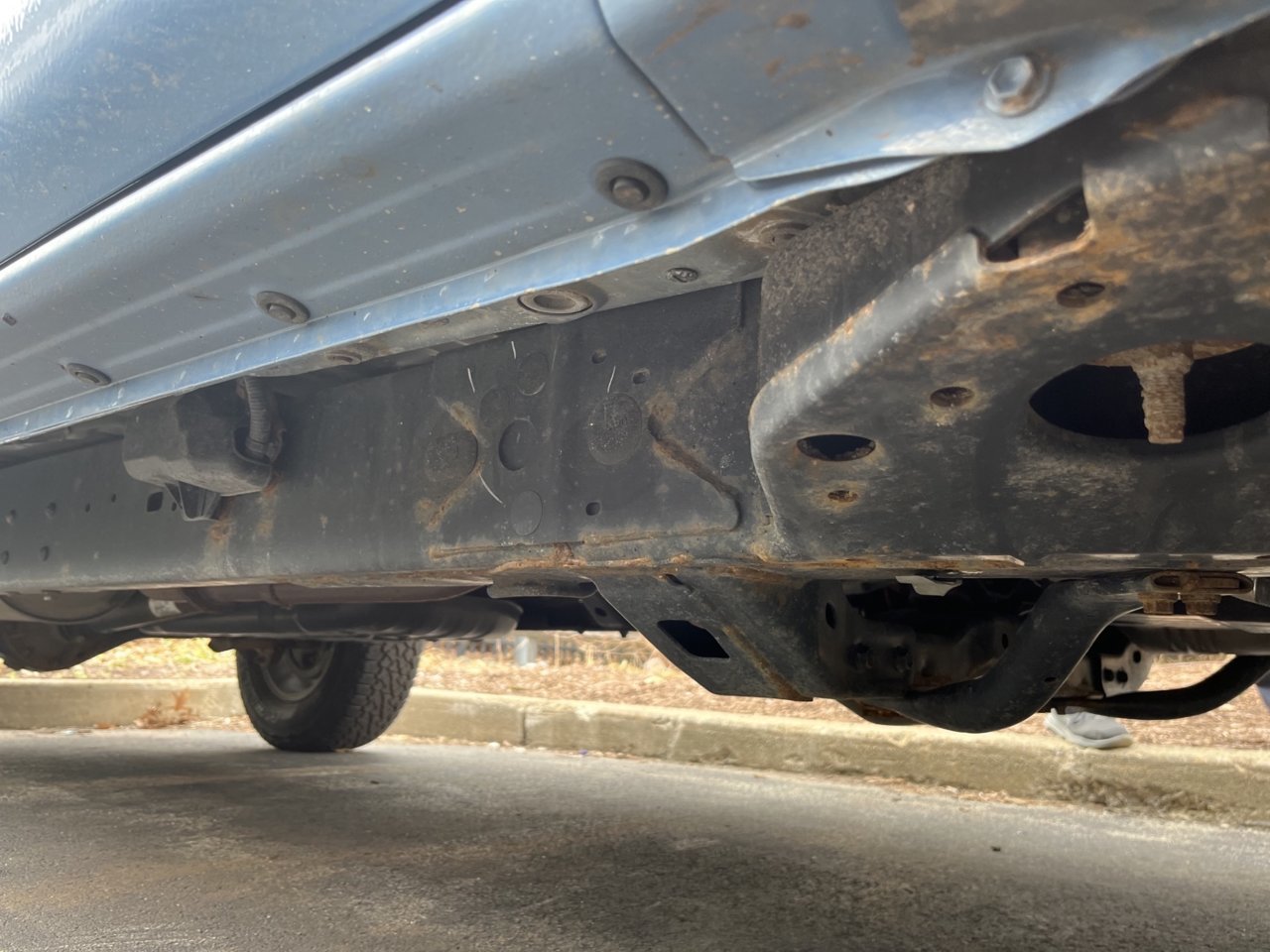

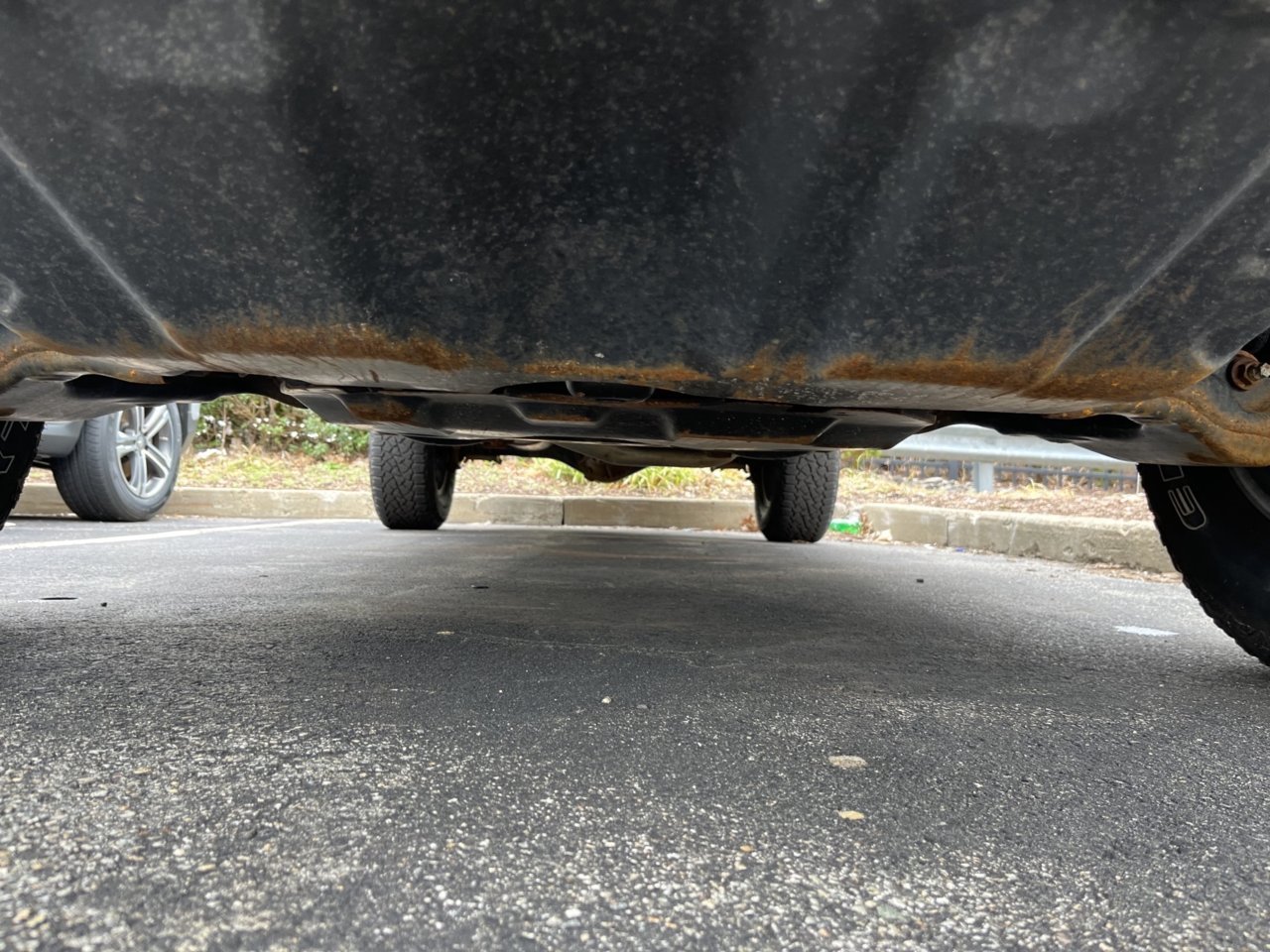

    **Ten year update!**

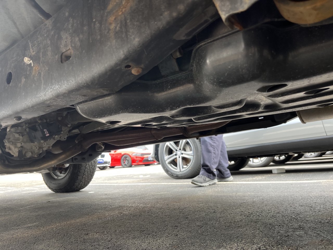

    This is my 2011 I’ve had since 2014. I’ve been having it professionally treated with Krown annually since I brought it home. I’m currently at 220k+ miles on the original frame and components.
    I live in Rust Belt, PA coexisting with the DOT that absolutely loves its salt and corrosive brine road treatments.
    If ya have any doubts about the effectiveness of Krown; look no further.
