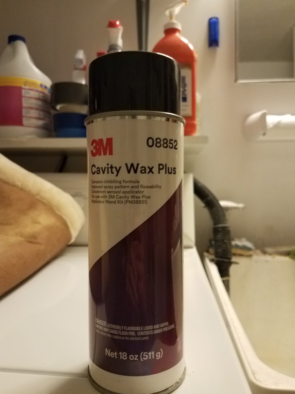

    I really didnt like the smell of the Fluid Film type products or that they were oily or sticky. Went with Cavity Wax, no smell and it dries enough that you can work on things without getting it all over you.
