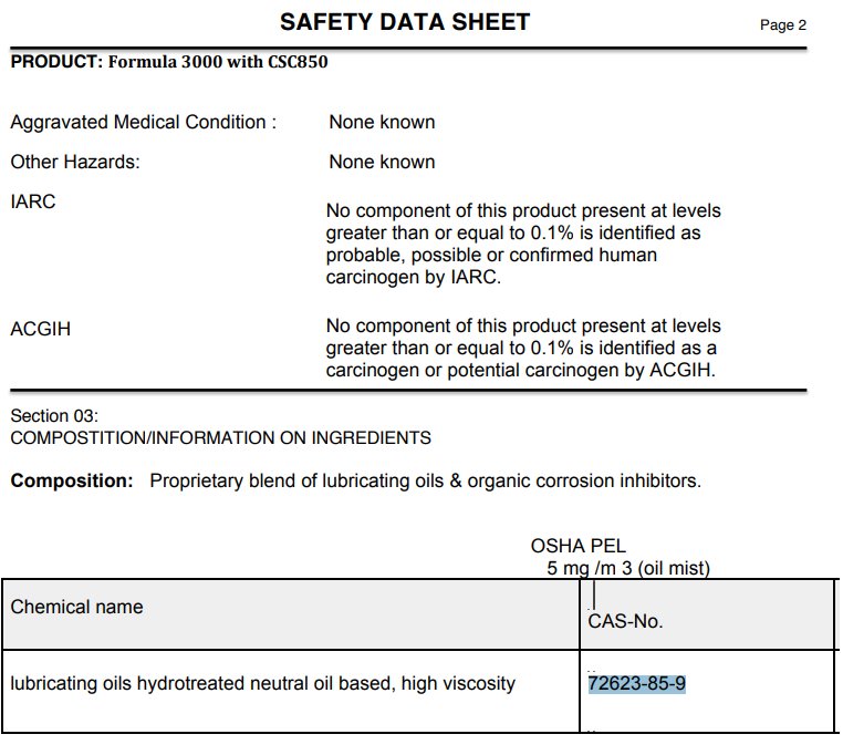

    The Link is safe. the .gc.ca is a canadian government domain. The tldr of the article is Corrossion Free Formula 3000 is the shit. I have been using over a decade and always impressed with its effectiveness, non-toxic, staying power and continual creeping even after several years. While it seems to stand up to a pressure wash well, it will wash away in areas of wheel wash, control arms, etc... The Blaster Surface shield may be bringing some competition here

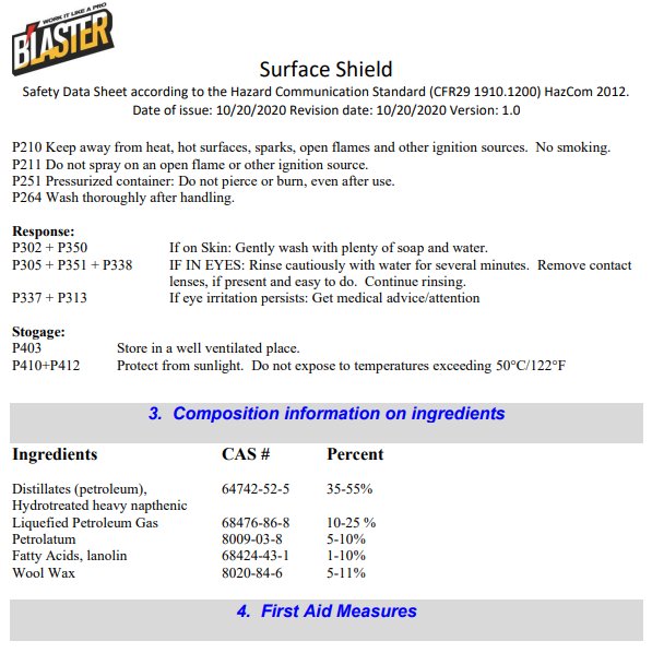

    Looking at the SDS for Surface shield, looks like the youtoober is slightly inaccurate in his description of the product. It is somewhat lanolin based but also a little bit of everything. The base oil is just a viscous petroleum based oil.
    IN comparison, Corrosion Free is only one thing.
