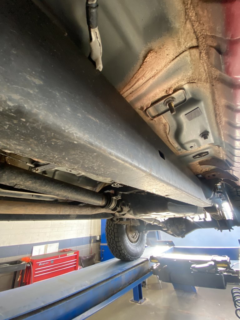

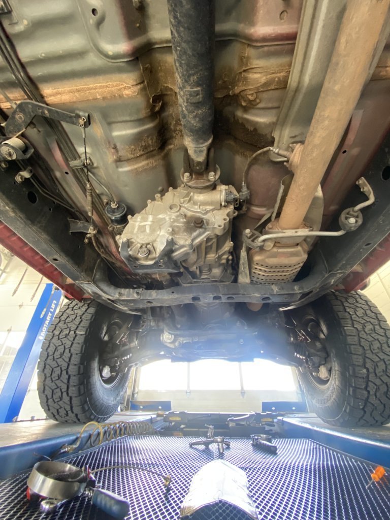

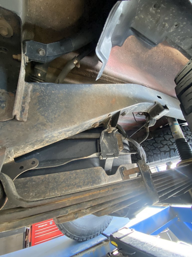

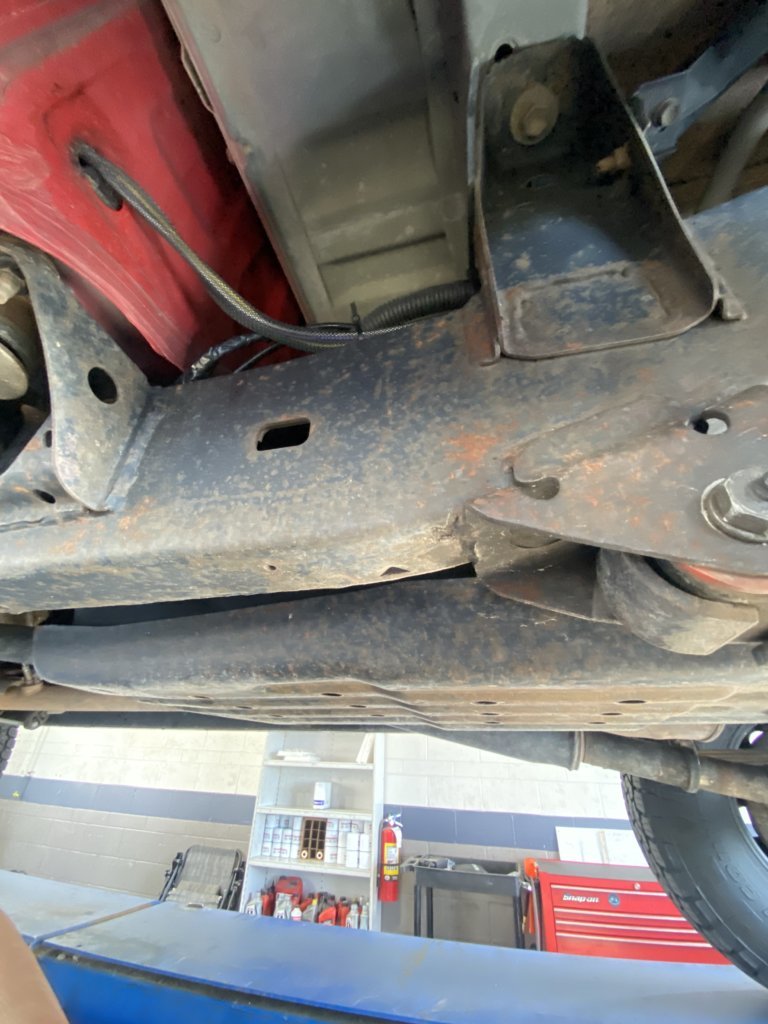

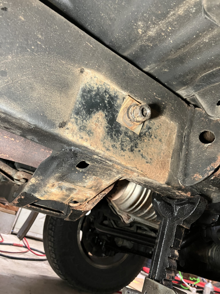

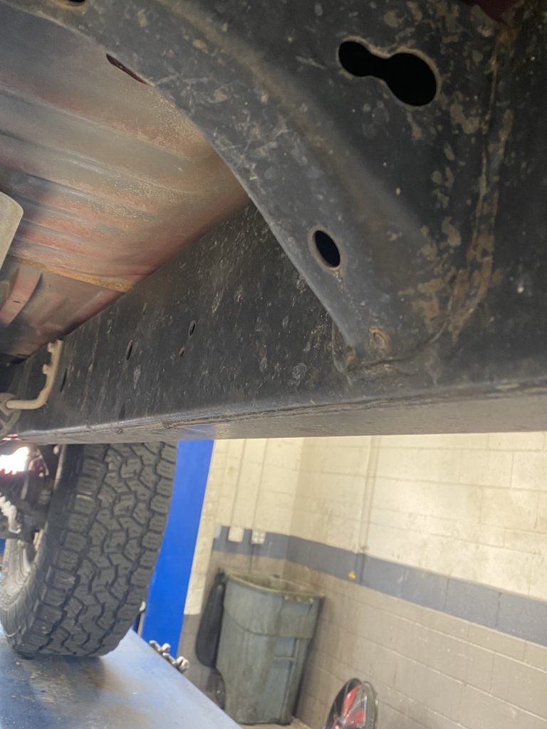

    Update.. still haven’t don’t much because other projects took place and now I’m going to box my frame up with some plates from KP off-road that I’ve some of you guys told me about on here recently. Now for the frame it does have minimal rust, but I know how bad it can get so I’m trying to figure out the best technique to make it last as long as possible when I’m done. I will include pictures of my frame, should I just be using a phosphorus solution to remove the rust or tear up the original paint and all bringing it to bare metal? What brands do you guys recommend for frame paint, heard good things about Eastwood and rust bullet. Was thinking about doing rust bullet metal prep and black shell before coating it all in Waxoyl at the end which I used in my rear axle a few months back and it’s held up great. Just don’t want to screw this up and I want to make sure I am removing all the rust for good. Any and all help I’d greatly appreciated IMG_1419.jpg IMG_1416.jpg IMG_1420.jpg IMG_1418.jpg IMG_1421.jpg

    What would you replace the factory paint with? It’s better than most coatings available to the average person with a small budget.

    Looking a heck of a lot better than my '02. Mine has been a west coast truck from day 1 (even assembled here), but just being parked outside within a couple miles of the ocean has taken its toll.
