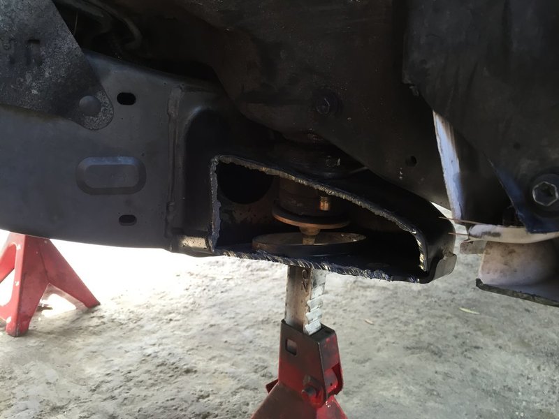

    Found this picture that makes it clear why the "cats" part of the frame is such a major problem;
    See that big round hole in the back behind the cab mount? That's right at the cats but from the outside.
