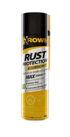

    Krown rust prevention in a spray can . A case is around $50 . It’s whats used in Canada where there are extreme winters BB328062-054E-40F7-B40E-2D6FC0A685A8.jpg

    Krown is great, thinner than fluid film so it creeps better and doesnt smell like a dead animal
