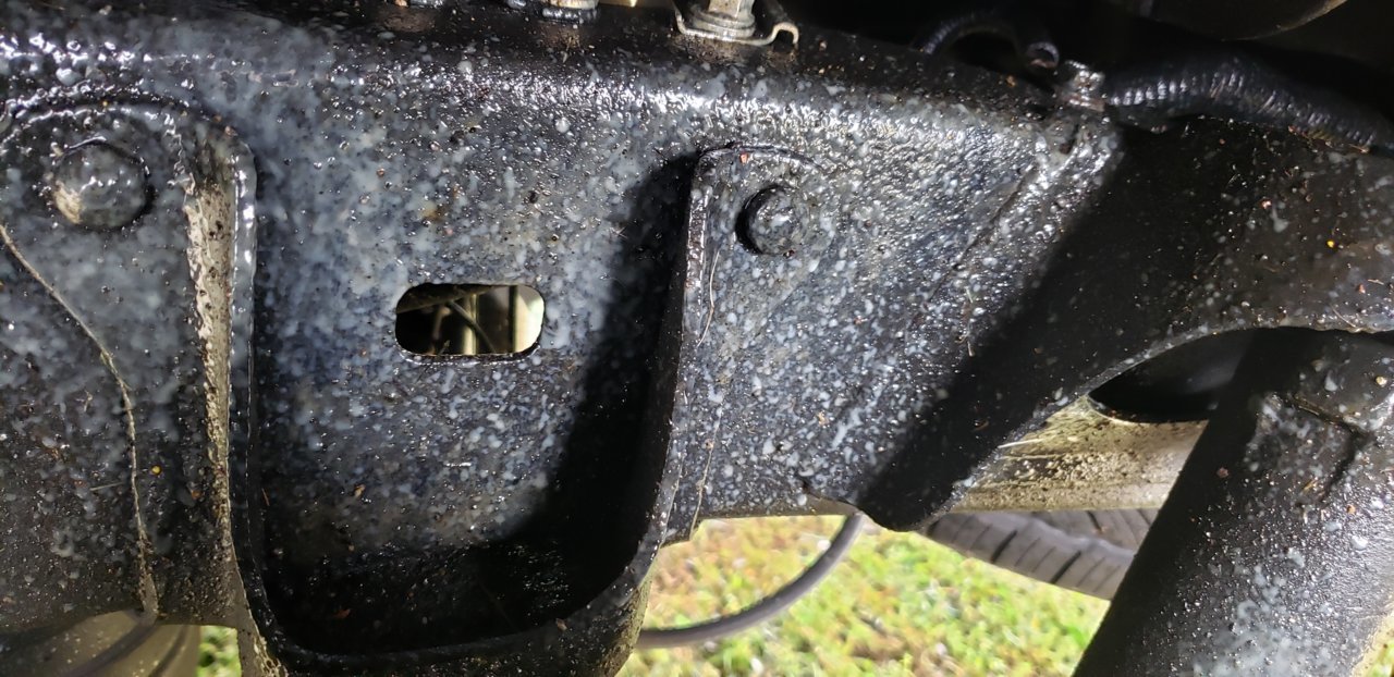

    Using the pro gun with woolwax I can get a thick coat on everything under there. Inside all the boxed areas, up into the bed area , fender area and everything and everywhere I need to get. A gallon is plenty for 2 Tacomas or similar size vehicles. The pic is to show how thick I put it on. Anything that looks like rust in the pic is just leaf particles stuck to the film. 20200924_130123.jpg

    Guess I do a tundra and a Tacoma. Tundra definitely takes more I guess
