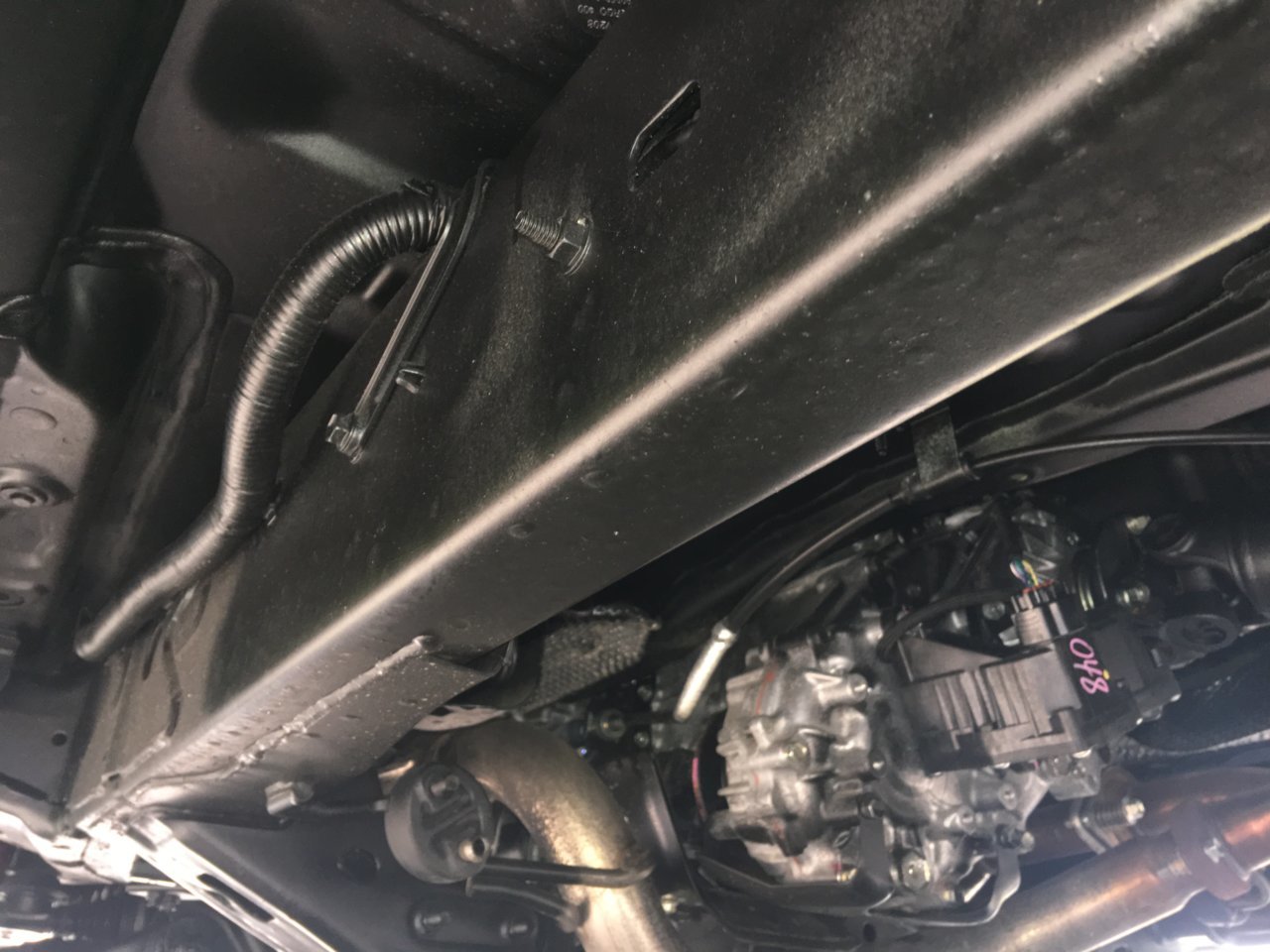

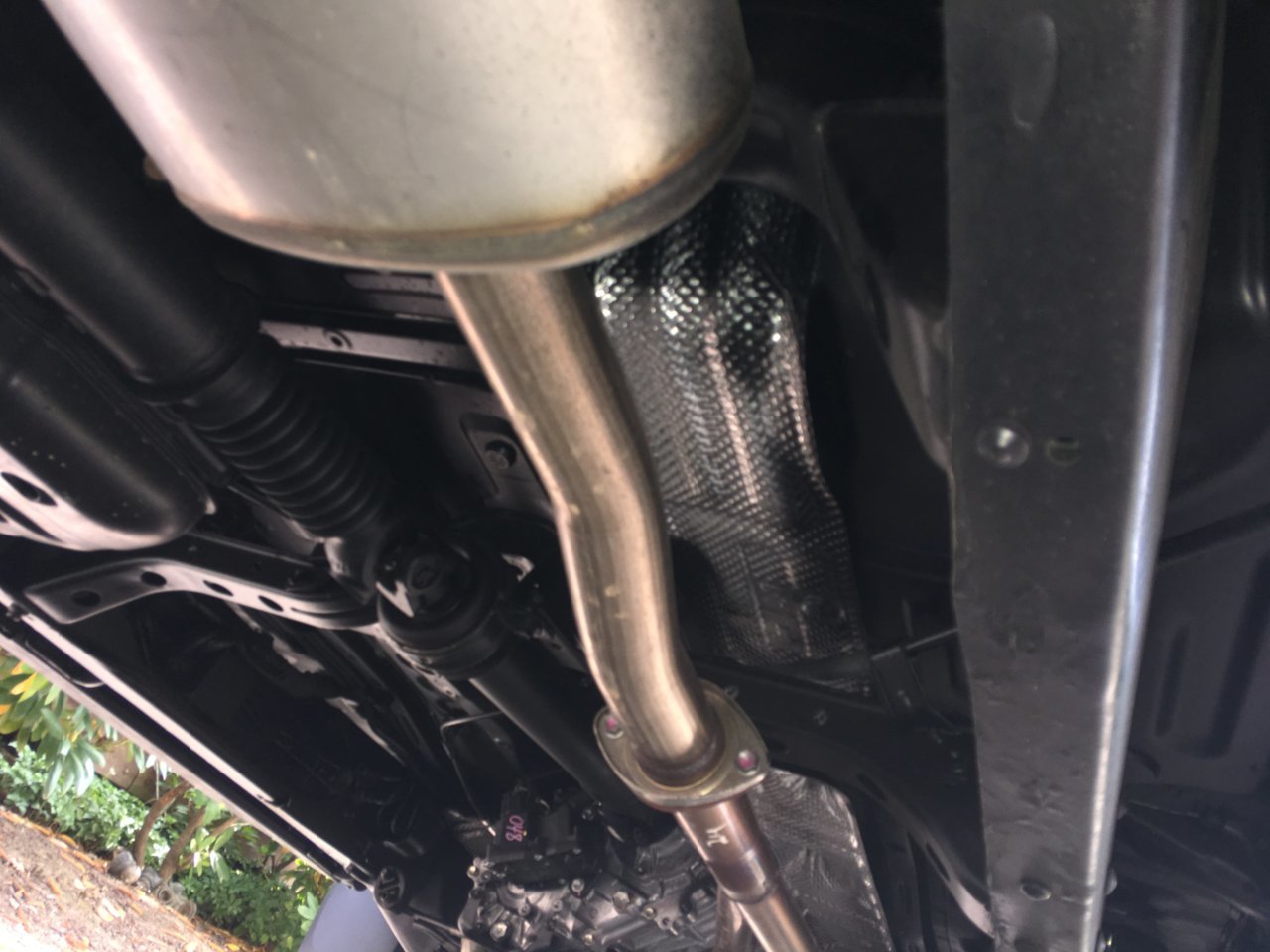

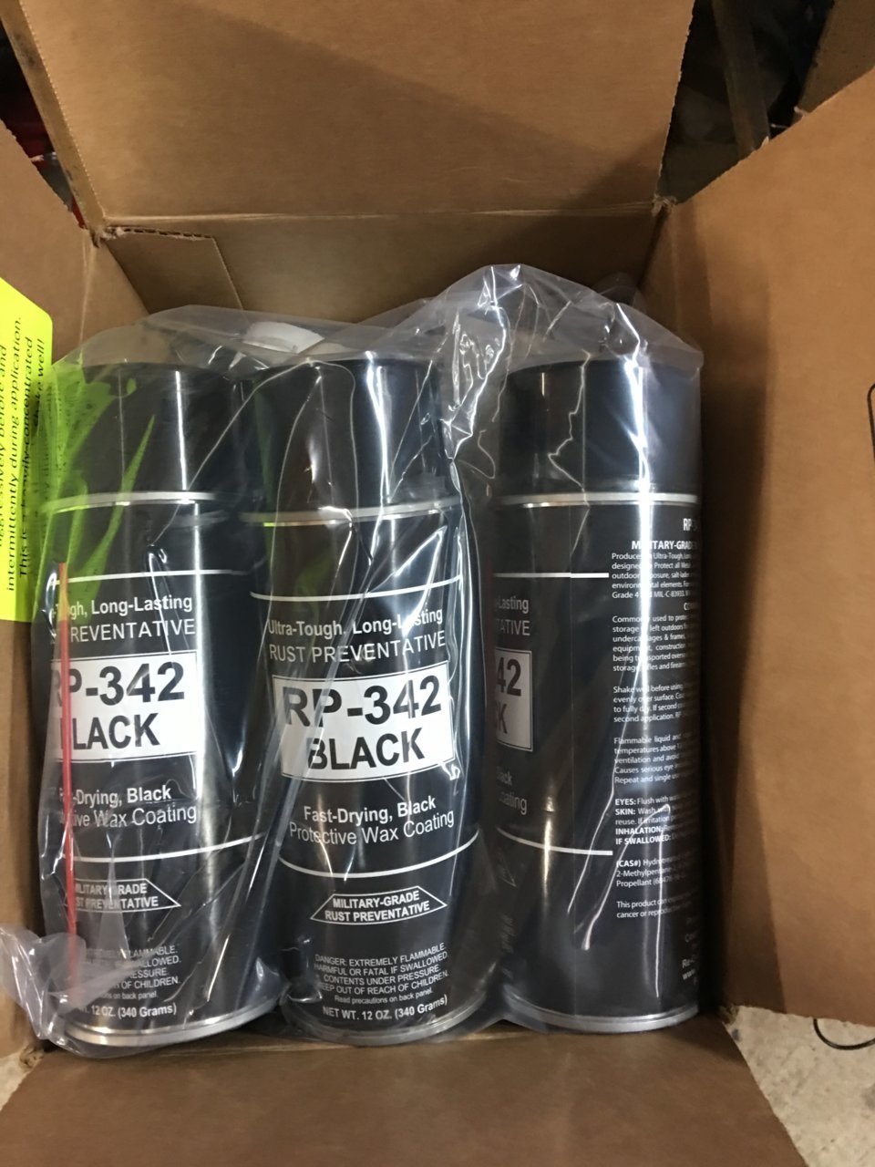

    I got the 6 pack and have 1 can left over, I did the 2 coats.
    As my pictures show I went with the black instead of clear so I can see how well it holds up and could map coverage.
    Also deciding factor is that it cannot be washed off and does not attract dust bugs etc.....
    Photos were taken in May and I hit quite a few dusty roads here in Ohio
    https://www.cosmolinedirect.com/cosmoline-rp-342-heavy-spray-military-grade-rust-preventive/

    As far as applying the rp-342 cosmoline i don't agree with that video when he says it takes 2 coats, and a 12 hr cure time. You have an option to apply a second coat, but its not mandatory. Cosmoline will dry in an hr, or so. After that the vehicle is good enough to drive off. It took roughly 5 cans to coat the chassis on my truck. I suppose i could of used more to do a more through job, but i'll keep an eye out to see what i missed down the road. I used amber, and it still looks great after 3 months. Could of used black, but more expensive.
