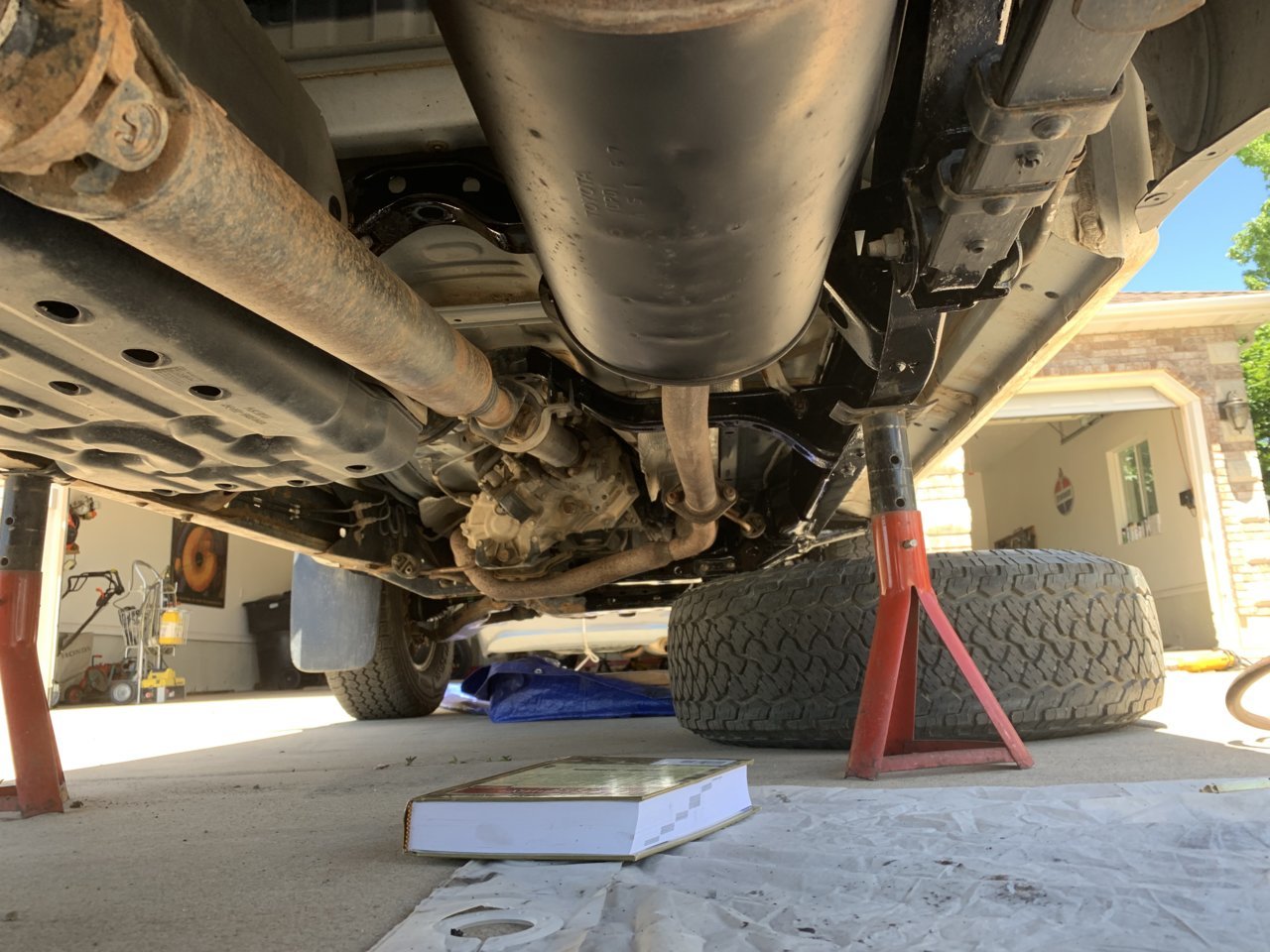

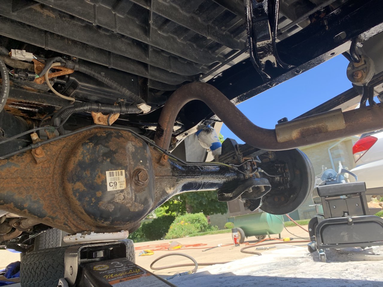

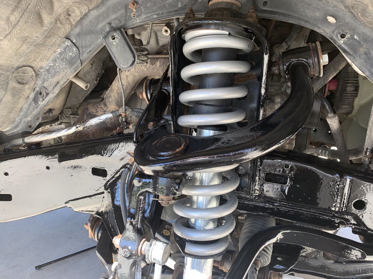

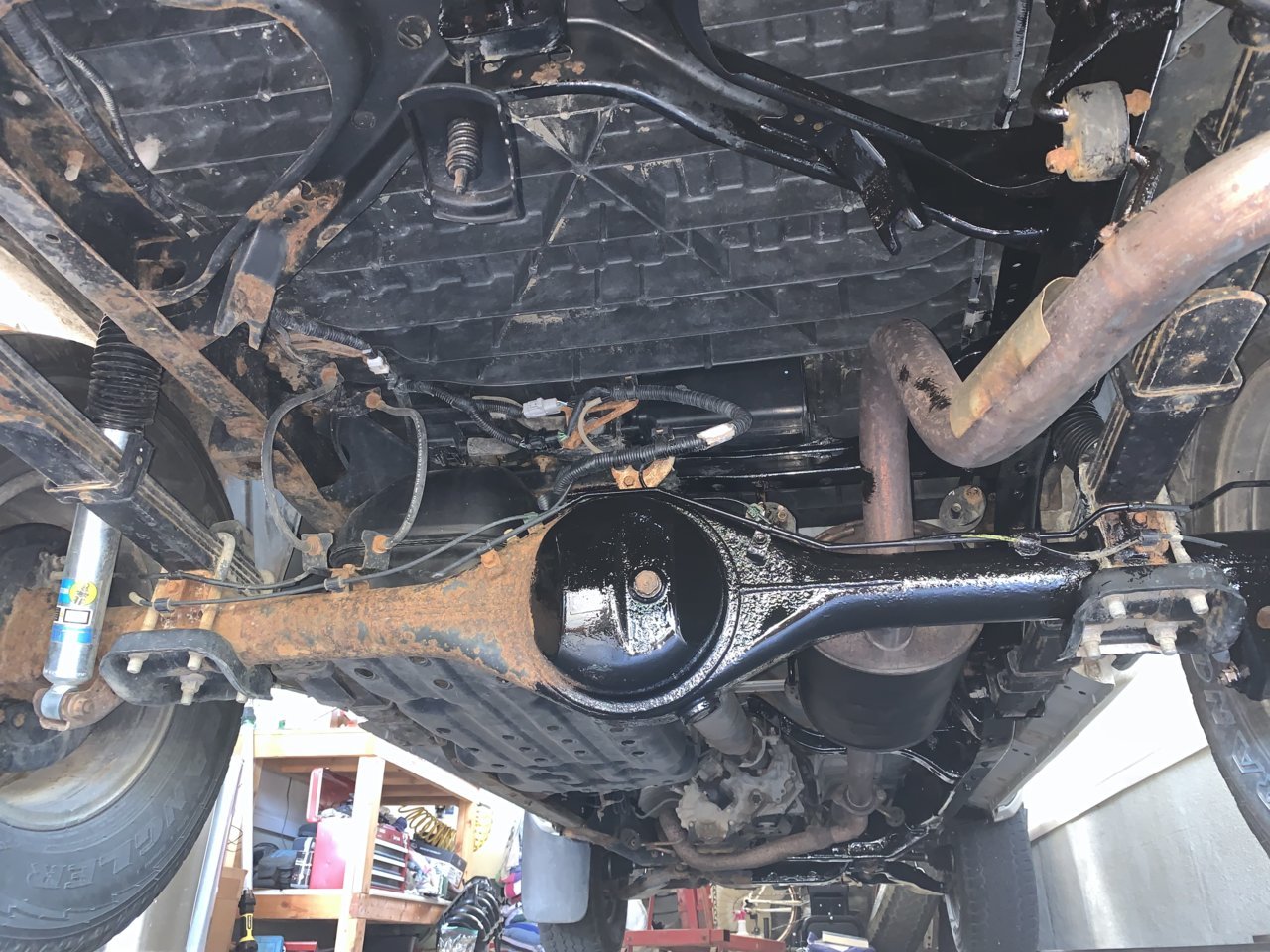

    2nd dealership passed the frame as well. There’s no 10 mm hole which is what they base their replacements on. I’ll be spending the next few weekends prepping and painting POR 15 on my frame. Here’s the progress so far, passenger side is done.
