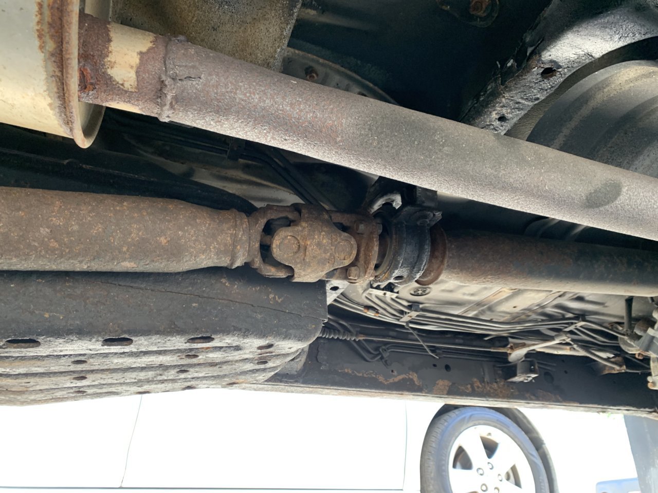

    Hey everyone,

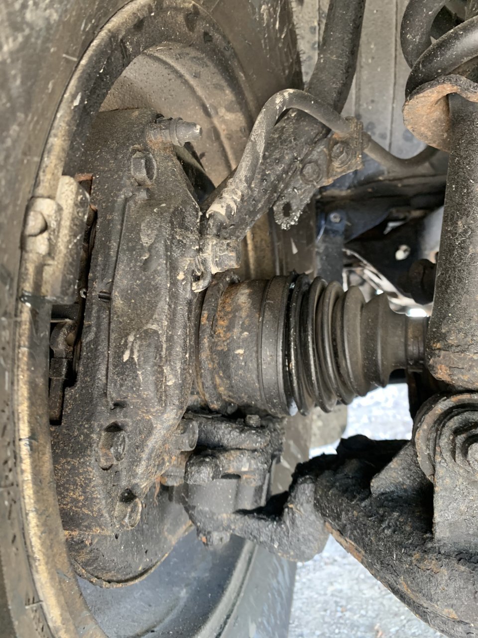

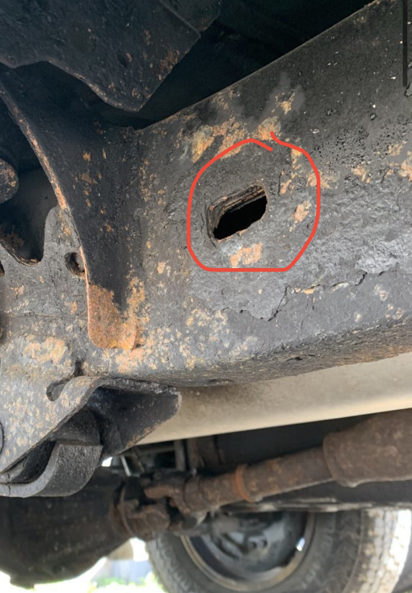

    New to the forums here and mainly got on to learn more about the platform and hopefully get enough knowledge to buy a decent first gen. I looked at this one today, it’s from NY 2001 Tacoma double cab and has some rust but wanted to know how bad the rust is and if it’s worth it. Any opinions are greatly appreciated!

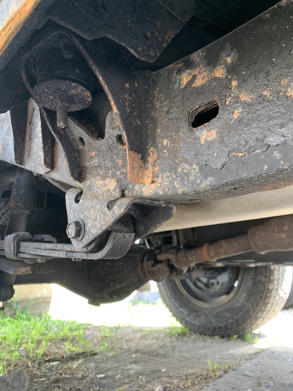

    I am from WI and no stranger to rust. This looks like they painted over it at some point to cover it up as the paint is now flaking off and exposing pitting in the metal. It all depends what you want for it and your expectations. The rust is probably much worse than what is currently visible. 1 year of winter driving and it will turn much worse. If they are trying to hide rust, what else are they hiding? I myself would pass and find something else.

    Looks like they hosed it down with undercoating which will trap moisture. Fix would be to powerwash it well treat the metal and paint it.
    The body rot would have to be all removed, treated, primed and repainted.

    I really don't like that first pic, you can see the metal delamination quite well. I'd take a hammer and tap the frame well before plunking down any money.

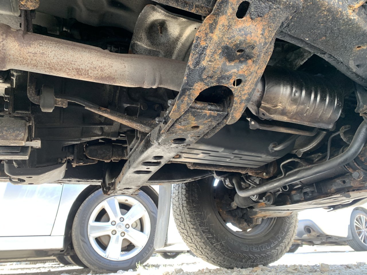

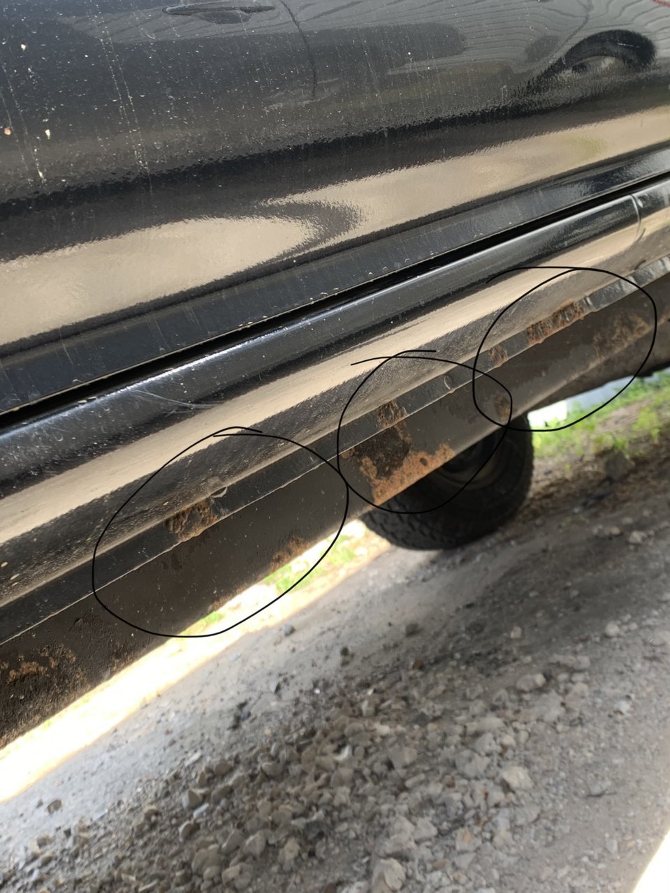

    It doesn’t look terrible but, as others have said, it looks repainted. The rocker panel rust doesn’t look great as that’s the body not frame. Also, the worst of the rust will come from inside the frame rails not the visible portion. I’m not sure if any of the 1st gens were ever eligible for frame treatment or replacement but I would be interested in knowing if the owner ever had it treated. For that part of the country it doesn’t look bad at all. Good luck my Tacoma friend!

    First photo , like someone else has mentioned the metal is delaminating in the drainage hole. When looking at older vehicles, bring a tool with you to test probe frame areas. Small screw driver awl, etc. That truck in my opinion is just way too far gone. Best advice I would give you, is to keep saving, and get the best , newest vehicle you can afford without going in over your head.

    This one spot tells me there is probably significant rust inside the frame. Whatever that coating is in the outside could be hiding any spots that are rusting through or on the verge of rusting through.

    Doesn't matter that you are moving around in the southland. Once the rust has started, it doesn't stop. And what you can't see is much worse that what you do see.

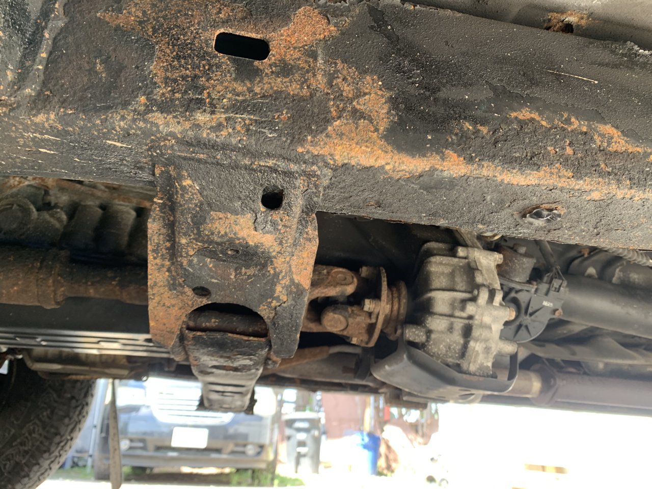

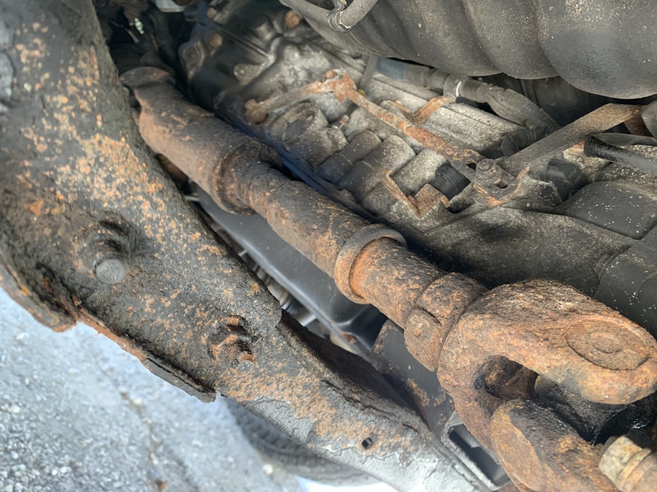

    At that price, my opinion is that it’s not worth it at all. I paid 11k for mine completely rust free. And depending on where you’ll be in Florida, if you’re living beachside the salt air will have effect on it. I live in Florida and see it first hand. It’s not nearly like living in the north east though. I personally wouldn’t pay more than $4k for this truck. That frame is going to be toast pretty soon based on the flakes on the outside, the inside is probably worse.
