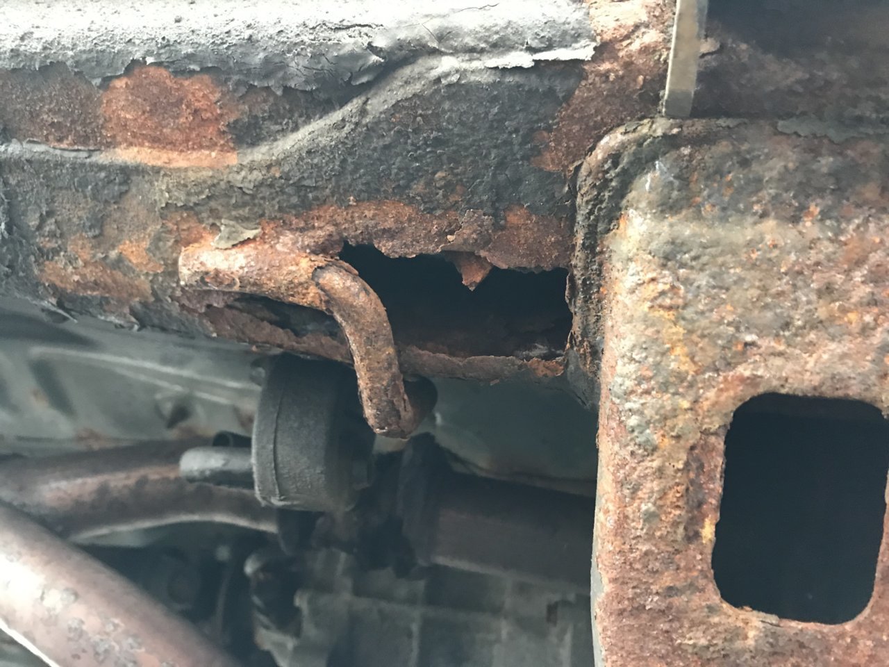

    What are any members experience of Toyota going beyond the 12 yr from date of service on Tacoma frame rust recall?
    I bought new 4/23/2007
    Was checked around 2012?ish and rust proofing applied.
    4/19/2019 checked again by dealer (46600mi) for any rust through. Just ahead of the 12yr from date of service end date for the recall. no rust through found.
    12 yrs from first date of service ends 4/23/19
    2/4/21 state inspection finds rust through approx 3x3 hole right frame rail (49300mi)
    My rub is; I know it’s passed the 12 yrs from date or first service which was 4/23/19 but < 3000mi and 21 months later and I have this hole in the frame that I can’t believe if inspected properly in 2019 when the last dealer inspection was done would not have been found.
    Called Toyota today 2/4/21 after the state inspection found this hole and they said I’m beyond the 12 yrs. sorry.
    Anyone had a anything similar issue with better results than I?
    Now I have this pretty nice < 50k miles truck with a hole in the frame. I not a happy camper!

    The problem is, you went to a crappy dealer. There very well might not have been a hole at the time of inspection, but guarantee there were spots that were paper thin. When my ‘06 was coming down to the 11th hour, I inspected it myself. There were no holes. I found a suspicious spot and gently tapped with a hammer and a 12mm hole appeared. Then I got it inspected and approved for a frame.
    Unfortunately, Toyota corporate doesn’t care at all about the circumstances. 1 day past the 12 year mark and they aren’t obligated by the courts to do anything about your rusty frame and they’re not going to pay for it.

    I had to unload my 2009 because of the black waxy crap they put on there. It was flaking off left and right with a good amount of rust behind it. Tried to get the dealer to do something about it, but they would not. It was solid as can be in the problem areas, but with the 12 years being up this year I decided to trade it in to avoid issues down the road. They sold the truck less than a week later. Hopefully the person who bought it knows what's gonna happen eventually if they don't take care of it.
