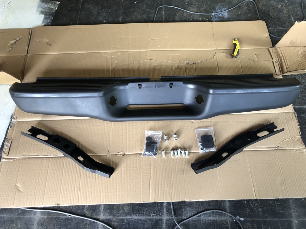

    My new bumper arrived today with all the hardware. It even came with new bulbs. Neat. Might spray it with rustoleum black hammered.

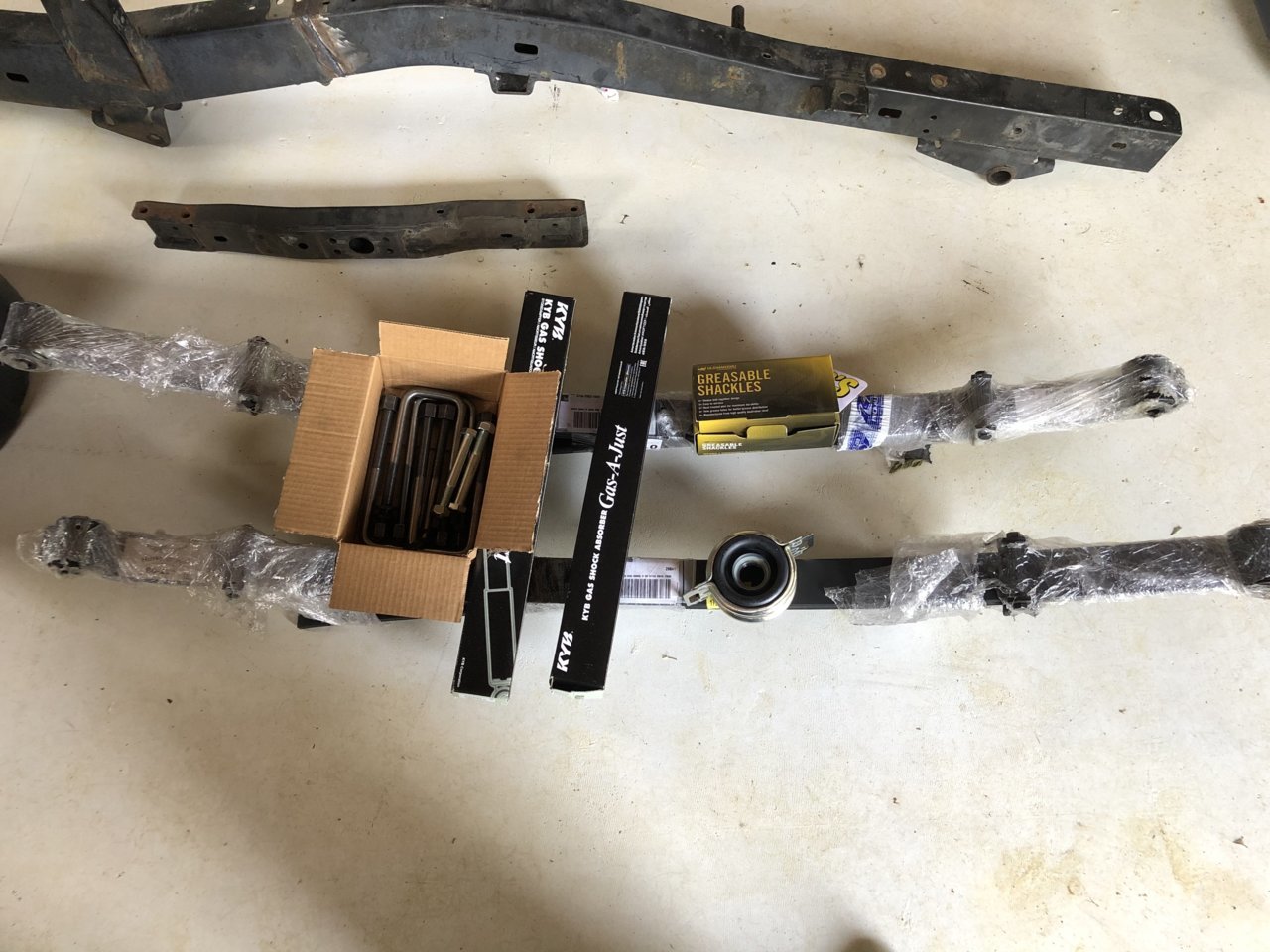

    I also collected all my new rear suspension components and spicer center bearing for the drive shaft.
    Husky springs, u bolts, and forward shackle bolts
    KYB rear shocks
    Old man emu rear shackles
    SwampYota and gzig5 like this.

    Are those essentially stock height leaf springs or are you adding a lift?

    Where did you get your bumper? :)

    No lift. The springs and rear shackle are all stock height. I don’t know enough about lifts to devise a lift plan yet. Maybe later, pipe dreams.

    Ebay. “2003 tacoma rear bumper” one of the first few results. Shipped out of Los Angeles.

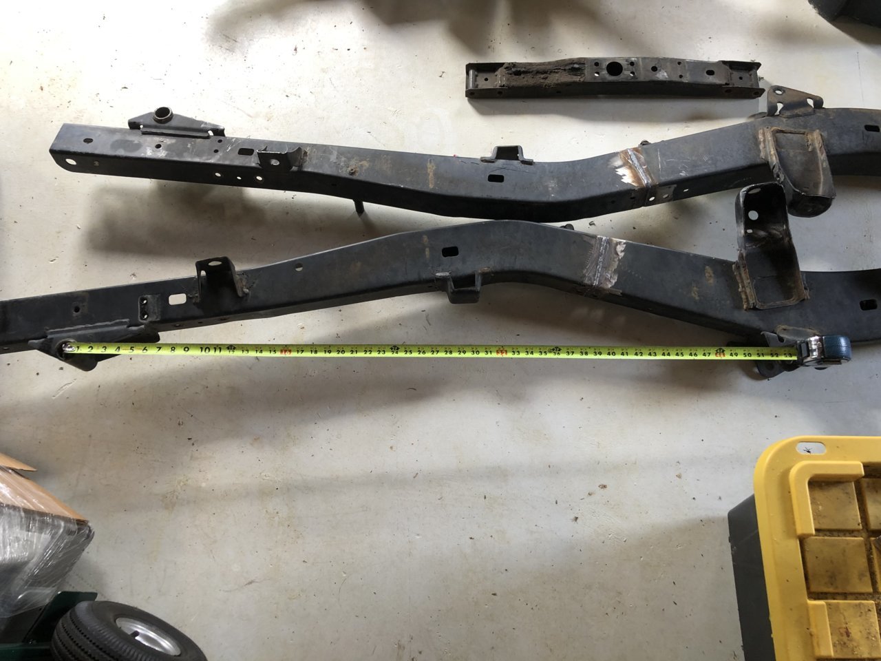

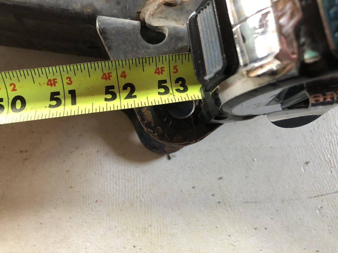

    I am trying to fix a mess that my truck's original owner had done on his frame. They put the front leaf spring mount on the driver's side in the wrong place.
    Can you measure and post the measured distance between the rear shackle mount hole and the front leaf mount hole?

    Sure I can post measurements when I get to the house. Do you have the long or short wheelbase?

    1999 Tacoma 4wd Extended cab long bed.

    Good, mine is the same except for the year.

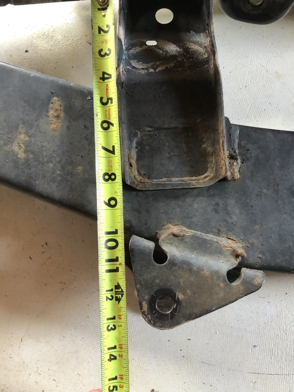

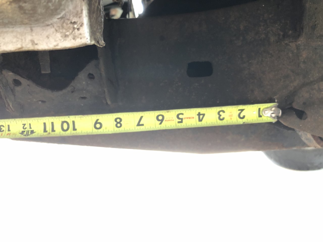

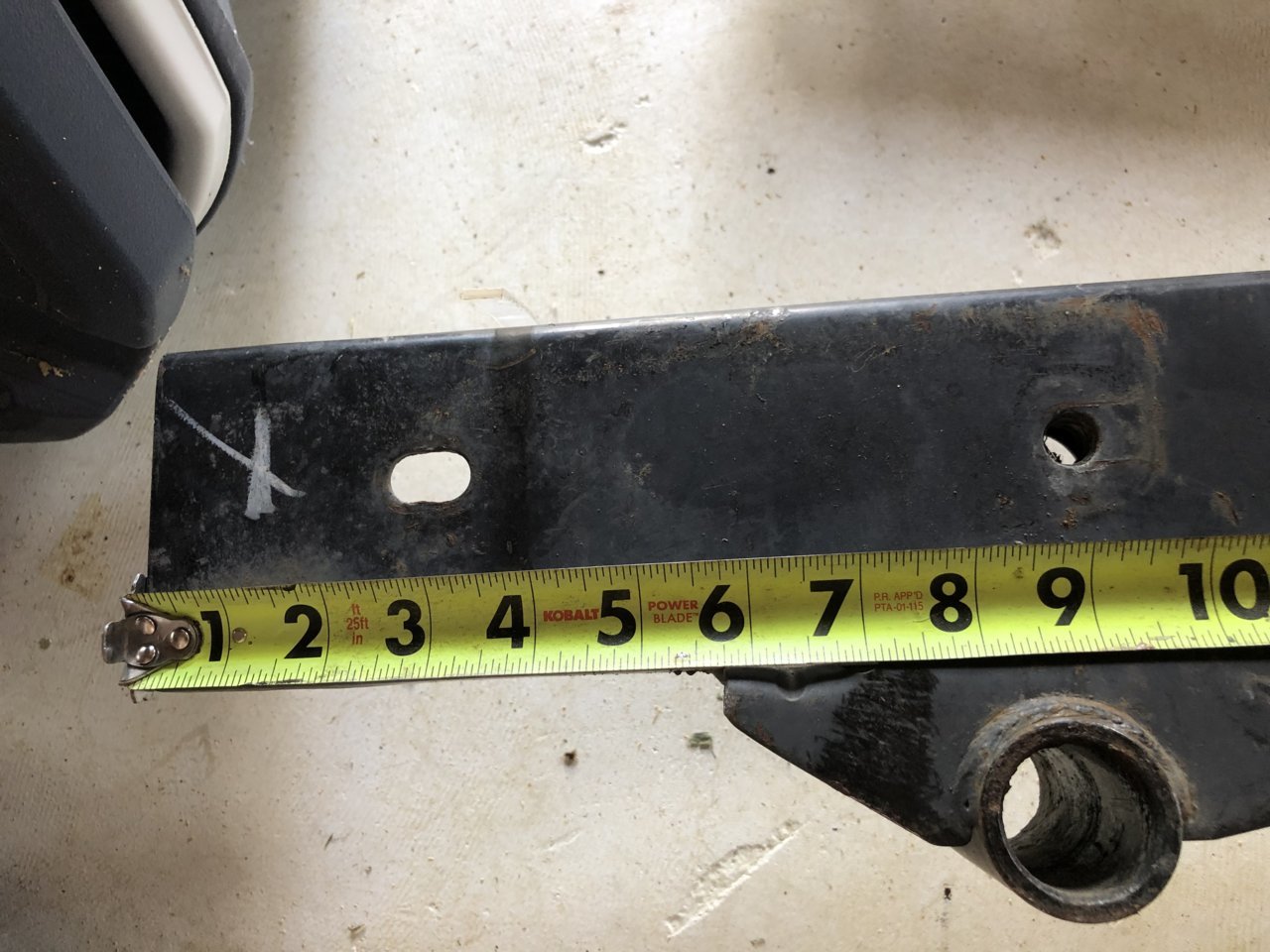

    I took measurements from my new rails, which matches the measurements on my old rails, so no issues there. I also compared measurements between left and right rails. All things came matching equally.
    Distance between forward spring mount and rear shackle mount bolt hole center points: 53 1/8 inches
    DEF4991B-9102-40EA-92DD-C972EA551076.jpg 1F6DBC80-8ED9-4141-A405-2502909187C1.jpg
    Distance from rear end of rail to rear edge of rear shackle mount: 5 3/4 inches
    Distance from forward edge of forward spring mount to rear edge of rear cab body mount: 8 inches.
    Also, the forward spring mount is almost inline with the tall bed body mount bracket, offset by about 1/4 inch to the front.

    Awesome!
    This is extremely helpful and what I was needing.
    I may try to find the brackets or remove the ones on it and put them on correctly. Saves $200.

    No prob. If yours are not rusted out, I imagine cutting em off and rewelding would be fine. Safetcaps also sell the mounts by themselves if you need them. I’m not using safetcaps because I have new half rails and will be replacing the crossmembers too, but I might get their center bearing crossmember reinforcement pieces , since I can’t find a replacement for that crossmember, that’s the only one that welds to the rails.
