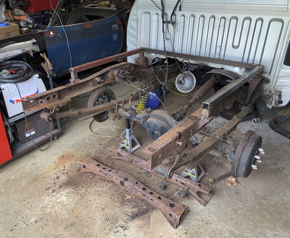

    Nice, getting after it. That rear diff looks really clean compared to everything else.

    One of the most asinine things I've seen in 40+ years working on cars. The body is nearly perfect and the suspension components don't look too bad for 20yrs in the salt-zone. But the frame is a complete train wreck from about midway back. At least fixing it is pretty straight forward, and in this used car market even if you had to pay someone to do it, the resulting value of the truck makes it a lot less painful.

    Yeah that is pretty wild. Did you have to cut off all of the bolts or torch them to get the bed off?

    Actually, I was able to get the large bed mount and bumper bolts and others to break loose after soaking in Kroil for two days.
    A bunch of the smaller M8/M10 bolts holding brackets, cross-members, or the fuel tank sheared or the heads rounded off because the heads shrunk from rust loss. Frustrating. I would rather have them break so I only have to get the stub out. If they round off it needs to be cut/ground off and still get the rest out of the hole.

    That's essentially what I'm doing. Here are the rear half rails I got from @Tour991. Cut in half so they could be shipped standard without freighting. They arrived last Friday. My wife texted me a pic of the bundle and said she couldn't bring it in the door. It was heavy. Had to move it with a wheelbarrow and then unpacked it in the shop. My brother picked them up Saturday and returned them Sunday welded back together. He did a clean job of it I'd say. He had to heat and bend one of the tall bed mounting brackets because it was slightly twisted. Other than that, its a solid set of rails free of rust.

    Very nice! Don't take this as a comment on your brother's welding (they look good) but I would strongly recommend grinding the welds on that joint flat and adding 4"-6" or longer gusset plates across that junction and welding them in on all three surfaces. If I had a choice, I'd do them on the inside to keep them out of sight. I don't doubt the welds are good, but a joint like that can see a lot of stress and could crack alongside the weld. In industry/engineering you will never find an butt joint on a stressed member like that that isn't reinforced with extra gusseting.
