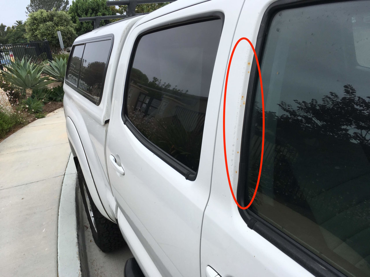

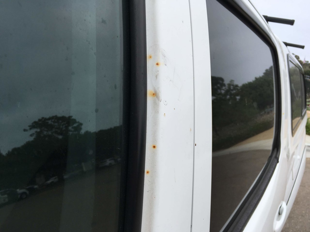

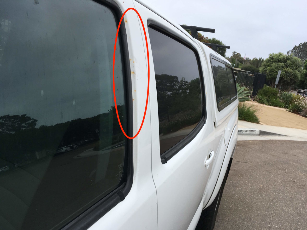

    Where are these spots exactly?
    Pics above are close up and can’t tell

  2. Apr 2, 2018 at 6:30 AM
    #22
    Canufixit
    Canufixit Well-Known Member
    Aug 9, 2012
    #84402
    2,066
    People ask me "CANUFIXIT"!
    New England
    2020 Red SR 4x4 Taco
    "Access" Tonneau cover. Bed Mat. Hitch, Timbren SES
    rail dust that rusted in place and affected the underlying paint??

    Yes I agree and this is why you can clearly notice it on white. I bought a brand new pearl white Lexus and noticed tiny rust dots on it. They can be easy removed with my finger but made the dealer buff the whole car.

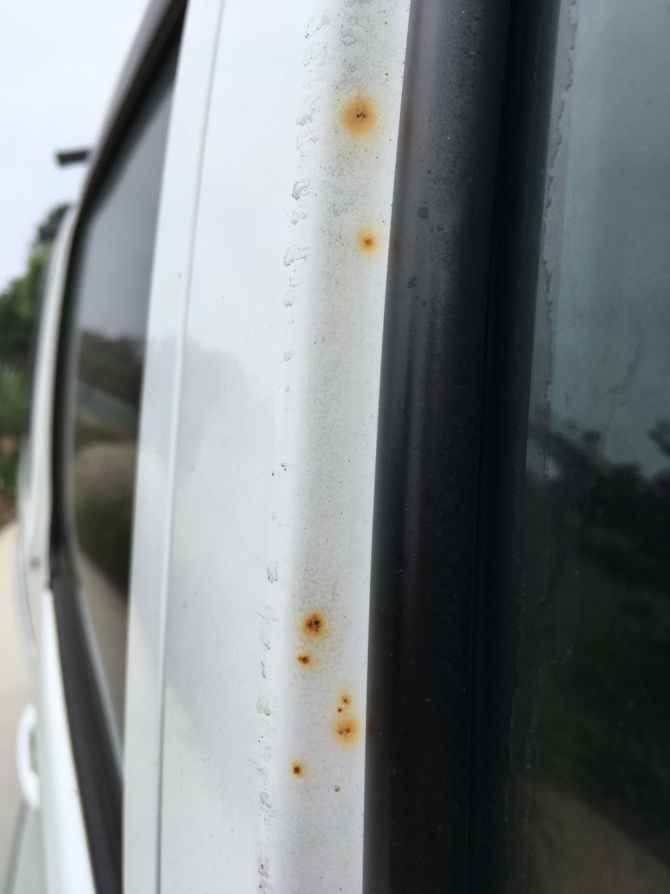

    I bought a white 4runner and after every winter I clay bar it, try clay barring yours and see what happens. On mine I know its surface contaminants because it's on the plastic bumpers, door handles etc.
    The O.P looks like the surface contaminants have set in and may have affected your actual paint

    Its a safe bet Toyota will not warranty any paint issues. The vast majority of these issues are from lack of proper paint care and not a paint flaw.
    Its hard to tell in the phots but is it clear the paint has flaked off exposing the metal panel?
    If this is the case a repaint is the only perfect fix.
    If it doesn’t seem like the paint is flaking you should wash the truck and use a clay bar to clean your truck and also find a product like Iron-X to spray on the truck to neutrilize and help remove embedded contamination.
    Very often industrial fallout, rail dust, brakedust etc embeds in the paint and will start rusting. You just need to remove the embedded contamination. If you don’t the corrosion will eventually eat away the paint and it will flake off and rust horribly.
    Clay bar your vehicle yearly to prevent this.

    I see tiny rust spots on these areas all the time and clay bar them off to keep those areas under control.
    But in your case, it is too late because it already ate through the paint.
