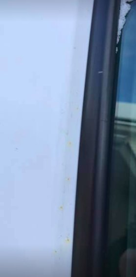

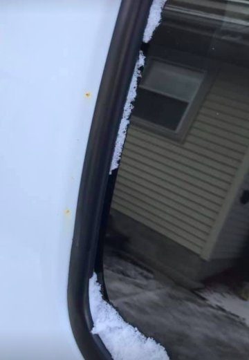

    I know I am resurrecting an older post but checking to see whether anyone has found any solution or heard anything from Toyota on this? I just noticed a numbed of spots on my doors. I swear they appeared almost over night.
    I did clay bar them and that improved it but has not completely fixed the issue.

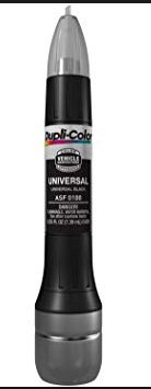

    There is something similar. The Dupli-color pen has the sander piece, touch up paint and a clear coat. Color is pretty spot on, not perfect though.

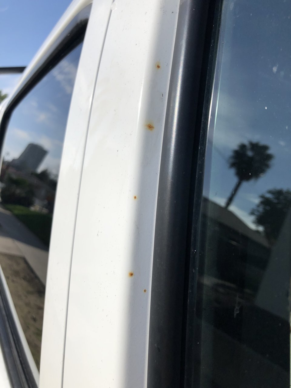

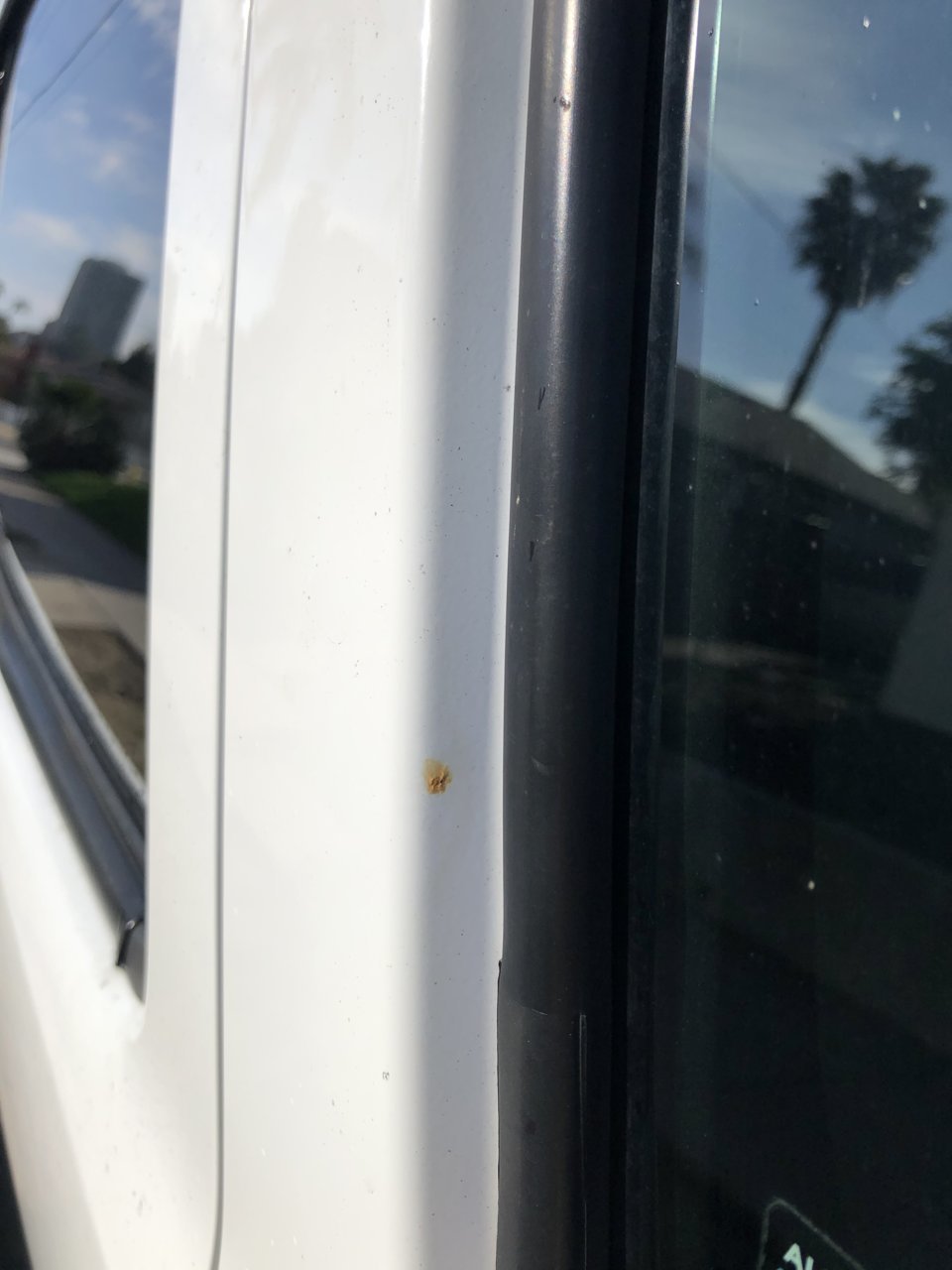

    2015 with 34398 miles and I noticed all four window jams have rust spots. A95E6E34-F716-44C2-9705-A94DD88D86F6.jpg 6590ED31-30DC-4439-A0E3-10BE6D434A1F.jpg

    I have the same thing in the same spot on my black truck. It's rock chips, if you look closely you can see the tiny impact hole where the paint chipped away and it then rusts.
