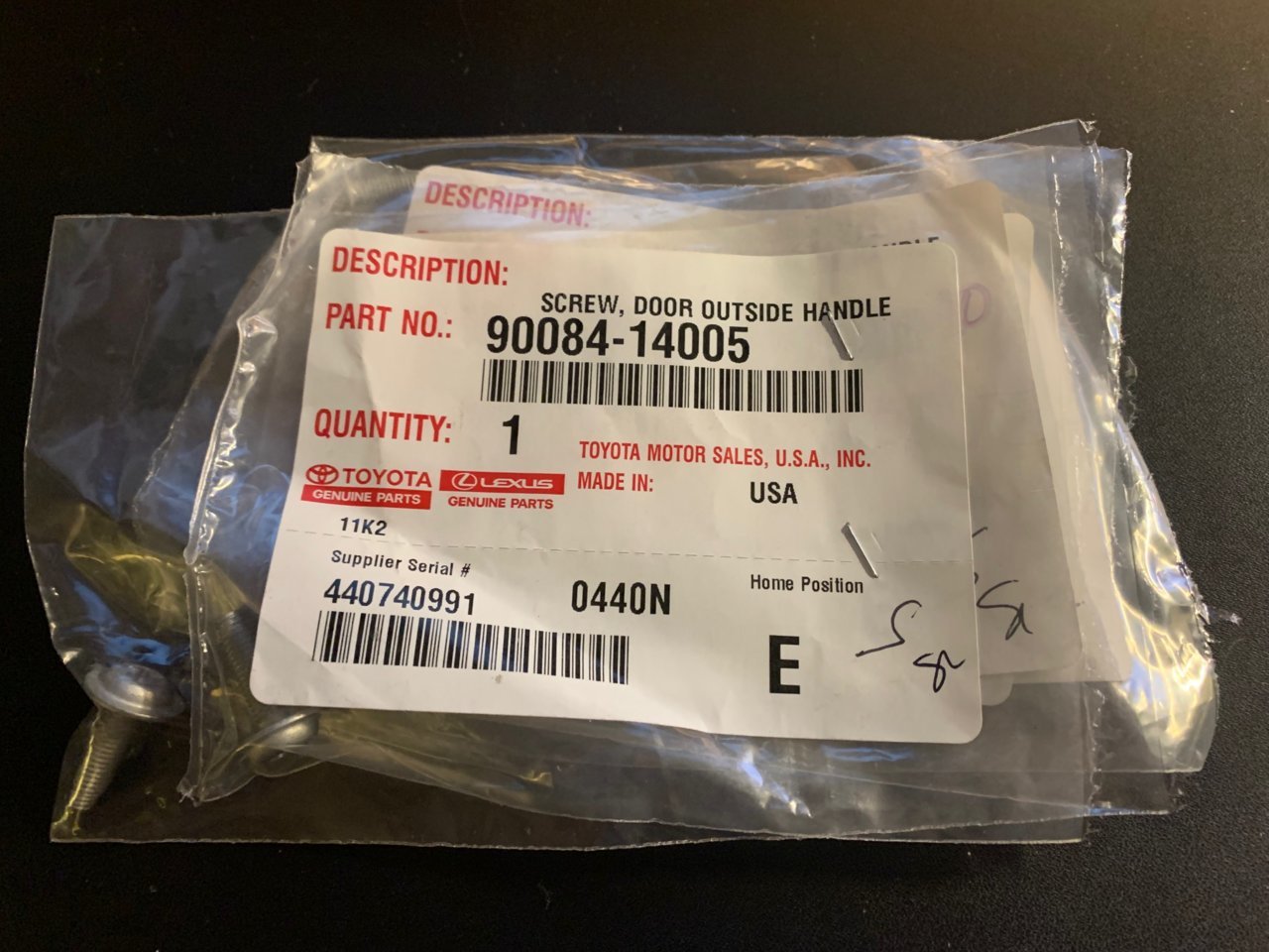

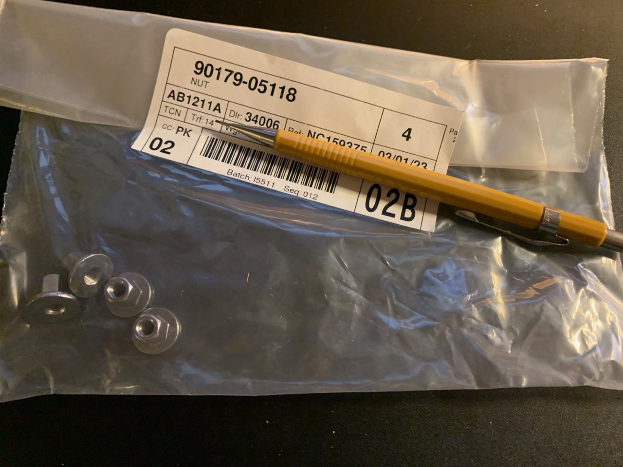

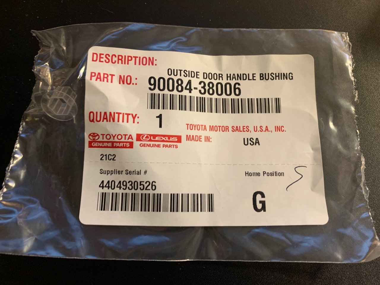

    TLDR: I'm looking for the 3rd gen equivalent part numbers that I've listed below for 2nd gen. Or, maybe its the same part numbers?
    I've got this issue on my 2018 DCSB and wondering if any other 3rd gen owners do too?
    Door hardware that rusts and causes these streaks:
    I've found the same issue with 2nd gen owners. I've even found the same issue on other model Toyota's, even .
    Based on the 2nd gen link above and referenced hardware, I've purchased the nut, bolt and bush. Here are the part numbers:
    I've called several Toyota dealer parts departments, they say I need to buy the entire door handle assembly at $100 plus for 3rd gen. I'm having a hard time believing that. I'm thinking this hardware did not change on 3rd gen from 2nd gen.
    Has anyone done this fix on a 3rd gen and can confirm these parts are the same please and thank you? before I start taking things apart.
    If they are different, can the nut, bolt and bush be purchased separately? Any help greatly appreciated.

    Update: The truck went into the body shop last week and had the hardware replaced and the paint corrected where it was stained. They used the hardware I noted above (same as 2nd gen) and did all four doors for me.
