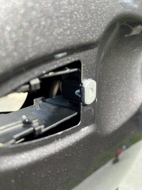

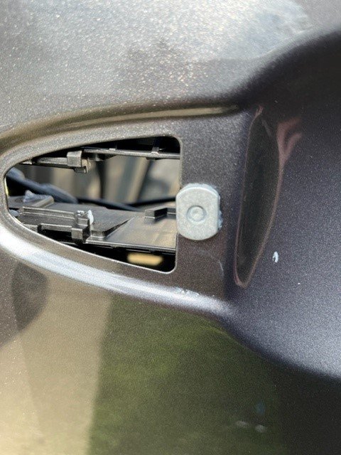

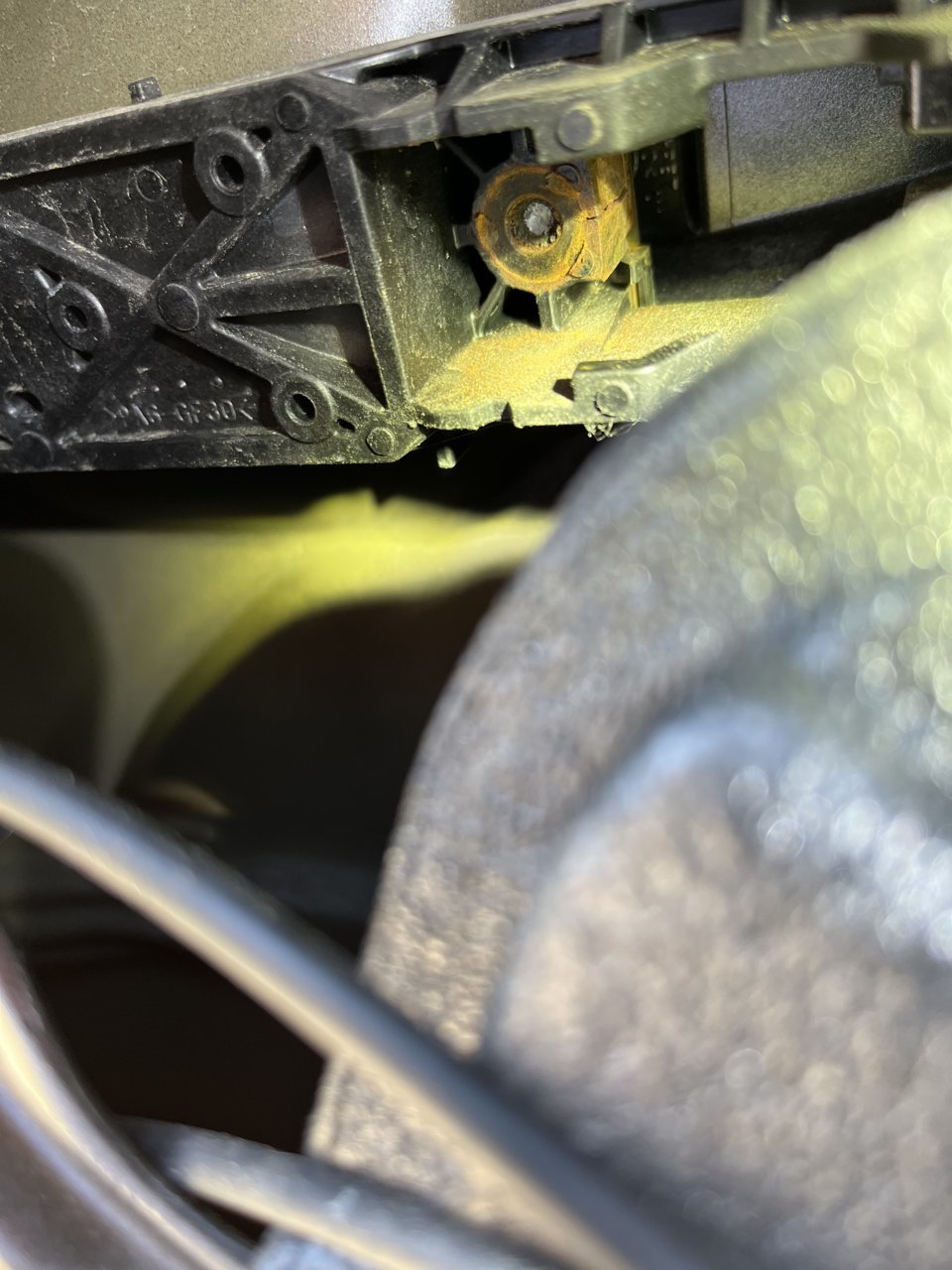

    Ok, took the rear drivers door panel apart, attempted to remove the t30 bolt, it broke just like everyone said. The exterior retaining threaded insert style bolt apparently rusts and swells. This cracked the plastic interior handle base. I’m ordering a new base. I will update what the retaining nut insert it comes with. I do not think it has what OP bought for a nut, it appears chamfered on 2 sides. Not saying they won’t work, but it does not look like a round one.

    Replaced the door handle base. The nut insert is only available with the handle base ~$80. Th OP's parts will not work on 3rd Gen.
