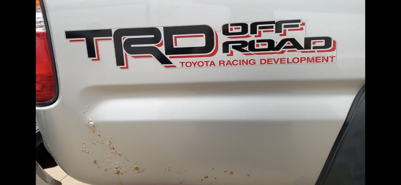

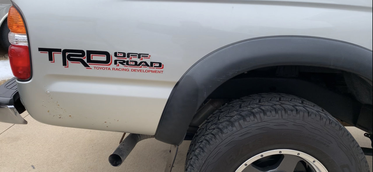

    This is a before, spray that 5$ chrome wheel cleaner on:
    Then after- spraying the area and lightly buffing with rag, then rinsing/ drying/ spray wax:
    Was careful not to rub too hard as those bubbles would rupture, but it did remove the rust without damaging the paint, no swirls or scratches.
