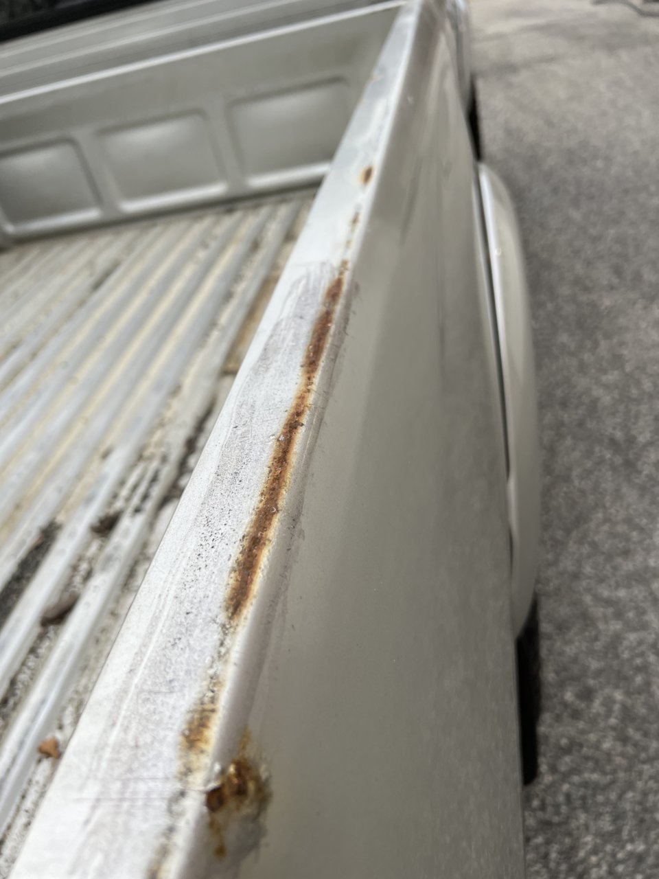

    I pulled the plastic liner out of my 2003 the other day to check on the bed (and to decide if I want to just go with a Rhinoliner instead) and noticed that the plastic liner had started wearing through the paint in the rear corners of both top bed rails. What’s the best way to repair this myself without having to go to a body shop. B4807039-8B5A-4516-A73E-9FDC8CF60A87.jpg DAC93E76-1C1B-4A52-B12C-559C2DDA1F92.jpg

    I'm curious what others will say here. If it were me I'd probably spray on some bead liner. I'd tape a line 1"-2" down from the top of bed rail and wire wheel the rusty spots down to bare metal then sand the rest of the rail. Then primer and paint.

    Thanks. My neighbor suggested taking it to a Line-x place (I think that’s what he called it) and said have them spray the whole bed and top of bed rails. I’m assuming that’s the same thing as the rhino line stuff I’ve read about, just installed by somebody else?

    If you can afford it, I highly recommend Line-X. They did a great over-the-rail liner job on a 2002 Tacoma I had years ago. It will take care of the rust issue, and will look great for years to come. I've seriously considered taking out my plastic liner and having my bed done with Line-X also.

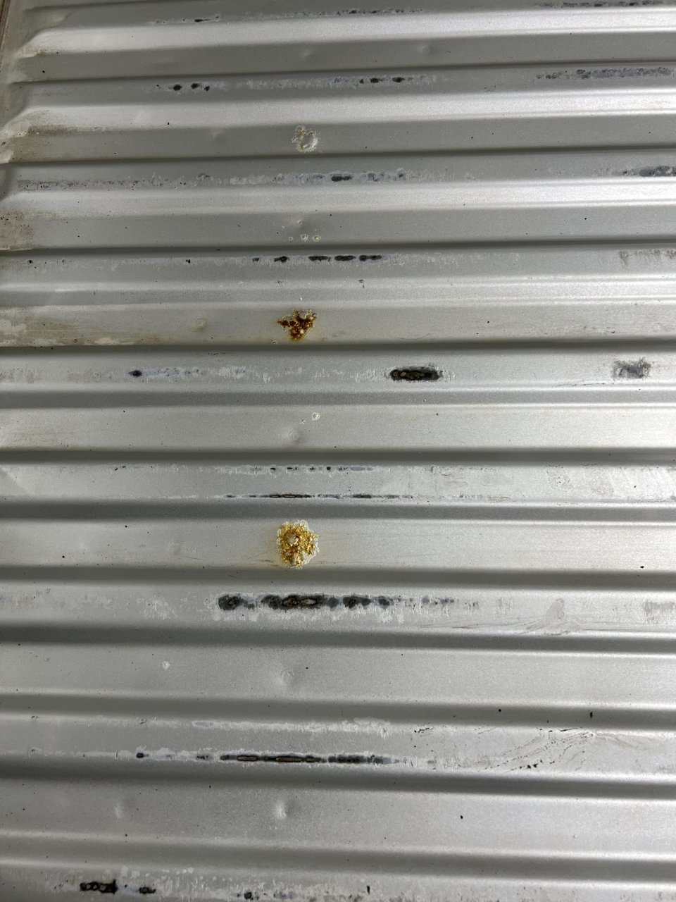

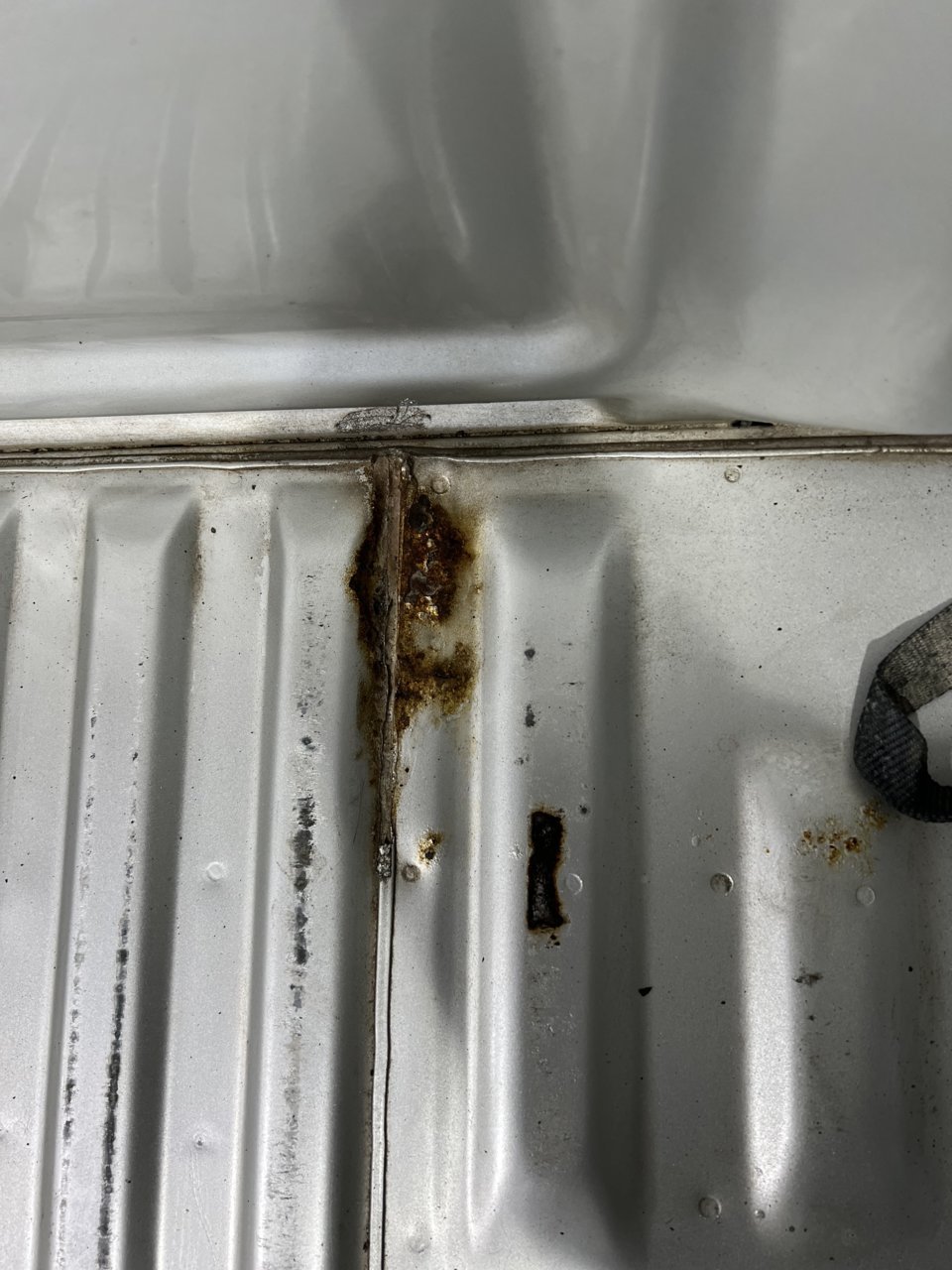

    Started cleaning up the bed today and noticed a couple of rust spots. Should I treat these with something like Gemplers Rust Converter before having a Line-x coating install? Or would the Line-x do the same thing?

    Sadly I'd say most of those look like they're rusting from the other side up. If you were to clean them up with a wire wheel / flap disk, chances are it'll end up being a bunch of holes that'll need to be addressed before anything can be sprayed on. I could certainly be wrong, but that's exactly what the bed on my tundra looked like before patching it

    Oh. Should I lift the bed and treat those from underneath before even considering the LineX? I’ve pulled the bed before using my lift, so it’s not that big of a deal. I replaced my emissions canister and gas tank last year with bed off.

    I can weld in some small patches if needed. Does anyone sell bed-patch kits?

    I'd definitely give it a peek, might get lucky and it'll be fine! To my knowledge no one sells anything but the entire bed floor unfortunately though. I used sheet metal for mine
