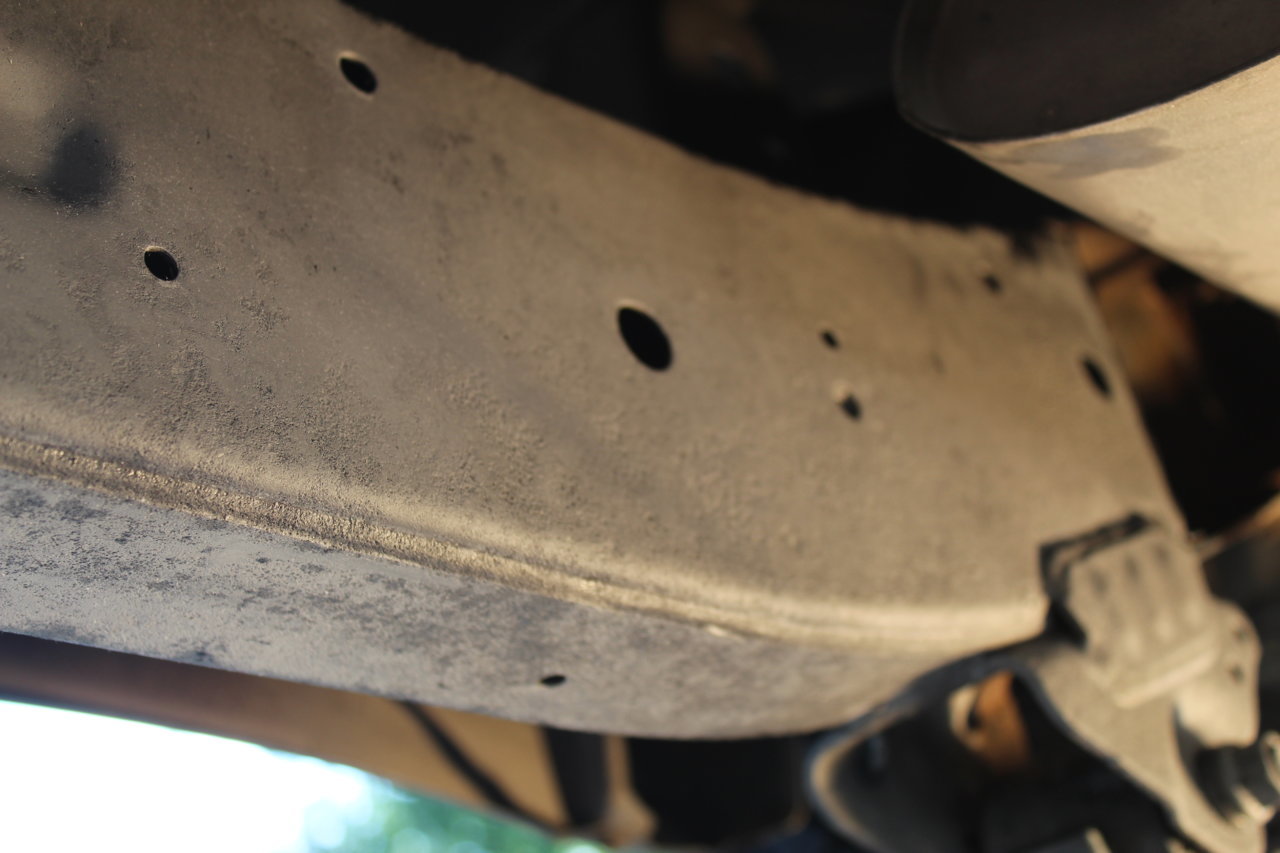

    i am looking at making that puny little drain hole a bit bigger for better drainage
    what size would you recommend
    i remember a special type bit works best but forget what its called... i want to say a conical bit??
    would this type of bit work well?

    Existing drain holes are 1/4 I think, so 1/2 should be good.
    Do not use regular drill bits, as they will cause burrs and you do not want anything to get catched onto burrs around the drain hole. Yeah, step drill bits (that's what they are called, by the way) are a better choice as they tend to make less burrs. If you do end up having some, insert the tip of a small file into the hole and file them down

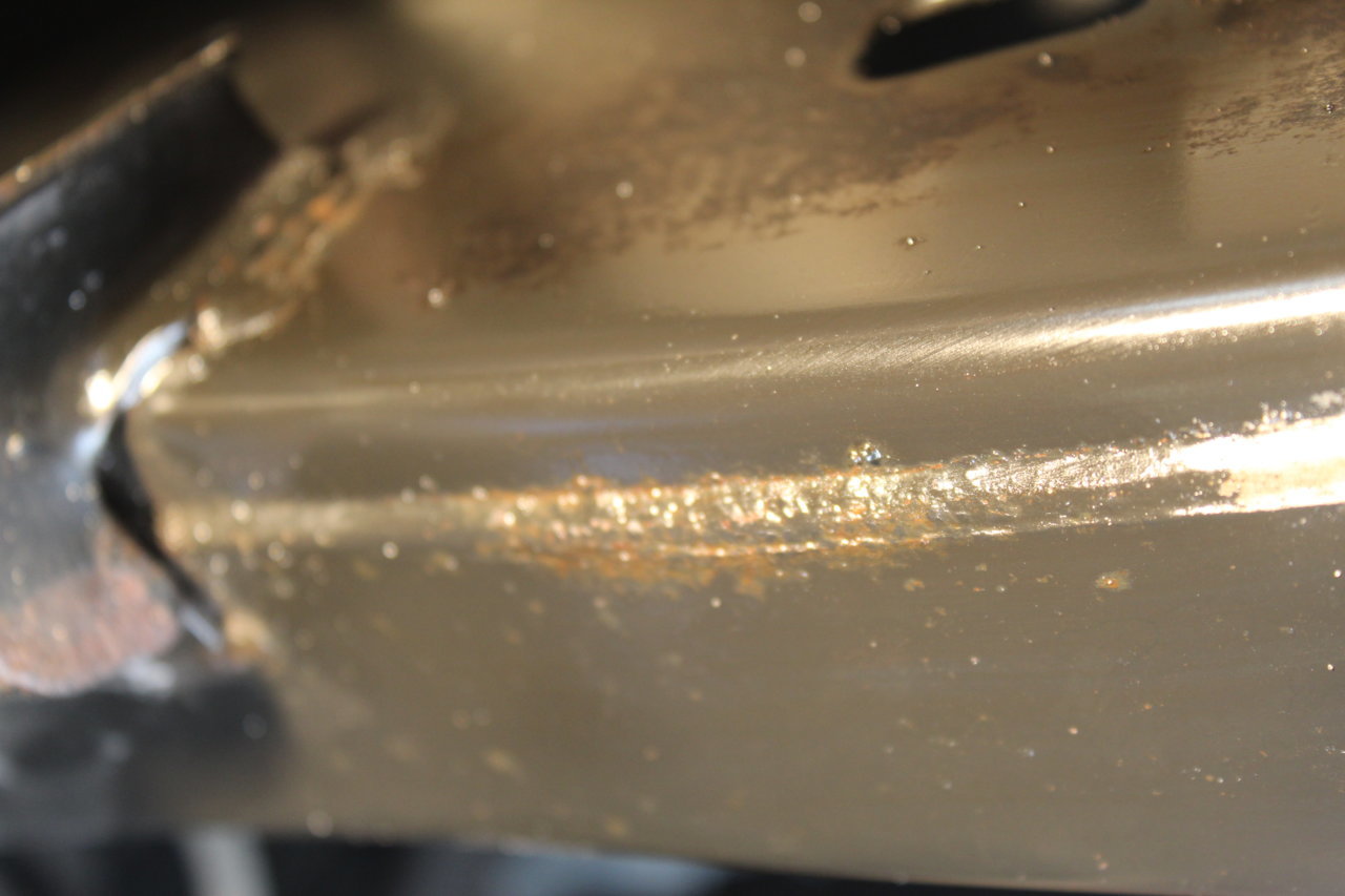

    onakat, here is a spot i just found on the inner rail in front of the cat where it appears bubbling under

    the area is out of focus. The "rust spot" is too blurry to see what's going on :(
    Anyway, I think you are worrying way too much about that frame :) I'd swap mine for yours all day :p

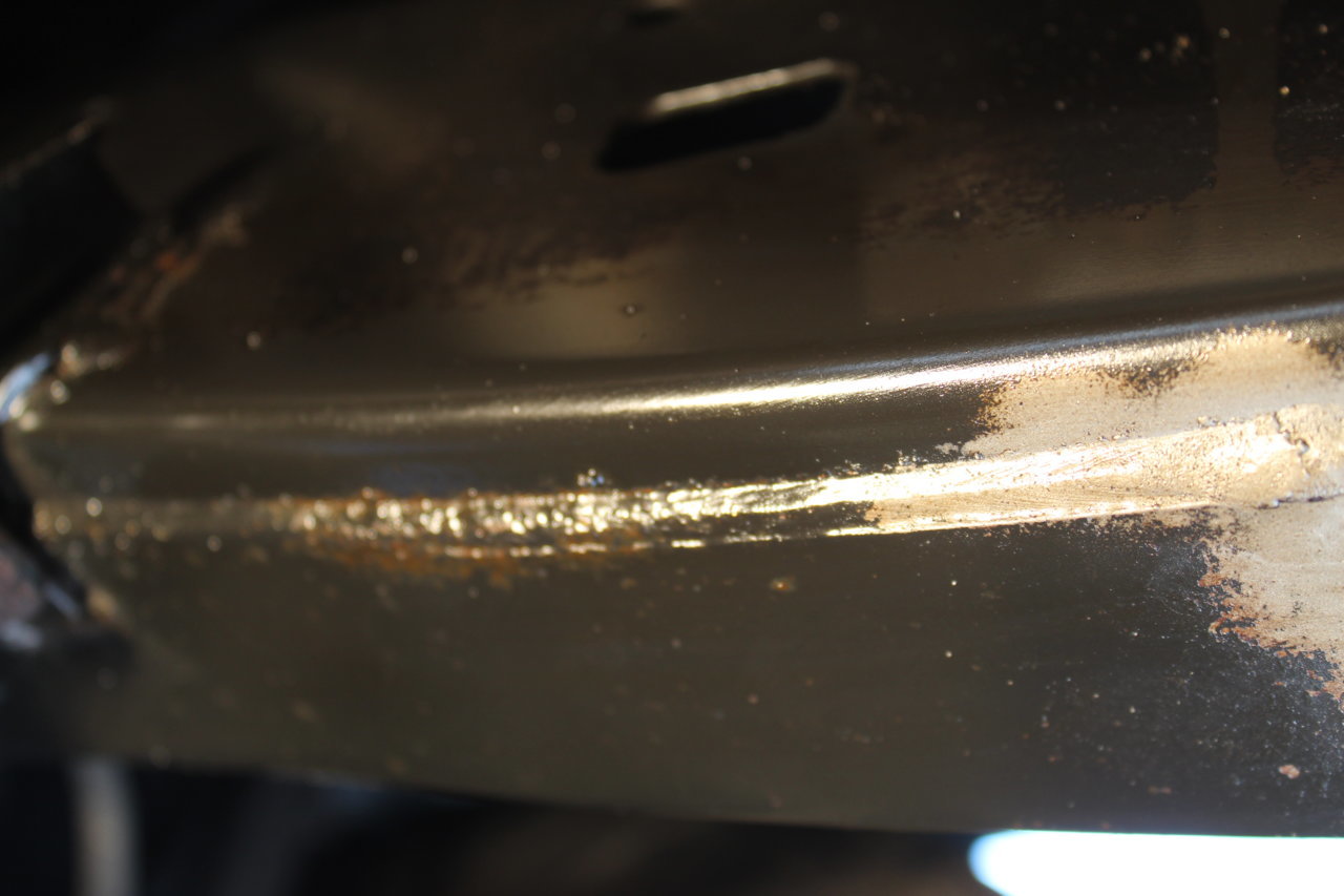

    another shot at it!
    i don't know if that's rust or the primer underneath failing and bubbling under waiting for the top to start flaking off
    its all very confusing!

    still a bit blurry but looks like starting surface rust? :notsure:
    Has the color of rust though... unlike that spot under the bed you showed before

    The original frame paint has not peeled off but looks getting close to it
    Maybe that bad reddish primer underneath idk

    One thing I've noticed after having my new frame for a year is that I'm starting to see some surface rust on top of the welds and some of the weld spatter. My thought is that the frame paint probably doesn't adhere as well in these areas with irregular surfaces, or perhaps the welds themselves hold on to paint less readily.
    In your case if that rust is bothering you, I'd suggest getting a small can of POR15 or another rust converting paint and just doing a touch up on those spots. Some cleaning and minor sanding should help the paint adhere better.

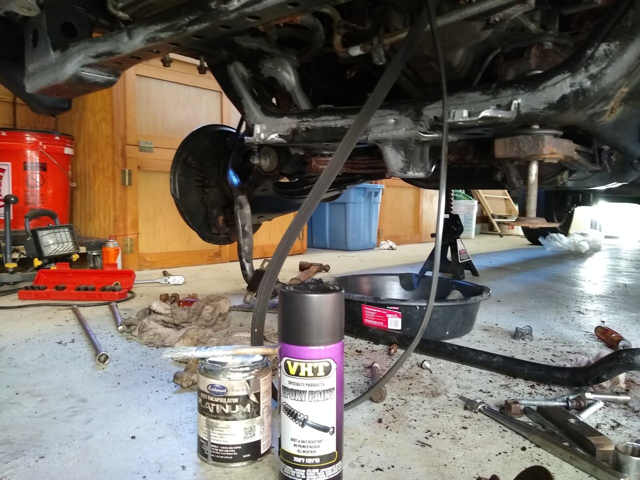

    I agree. My frame was replaced a few years ago and I have only slight surface rusting on the frame at the welds. When I am working underneath the truck I just use wire brush to remove the bubbling paint on the welds then use a rust converter and cover with black ceramic paint. I just did my front end
