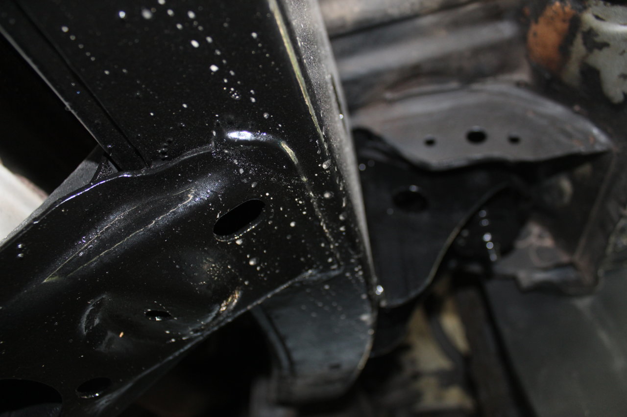

    it will be interesting to see those welds by the cab mounts after i cleaned them to bare steel, phosphoric acid coating them, 2 coats of primer and some extreme chassis gloss topcoat
    i spent 5 hours of my life doing ONE cab mount in the front, 5 hours! 3 more to do means 15 more hours
    it was extremely dangerous doing this & probably inhaled a serious amount of blasting sand turned to almost gray powder now after sifting and reusing it, a box of that stuff is north of $40

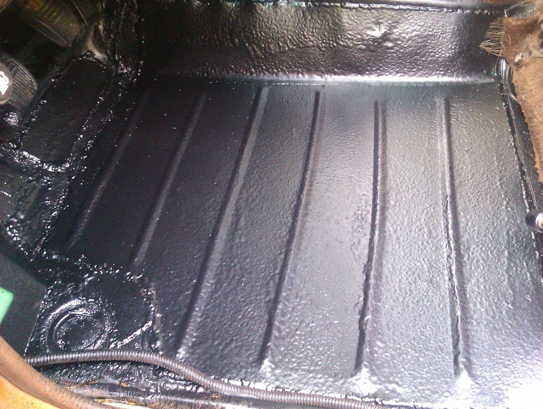

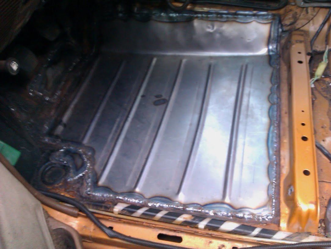

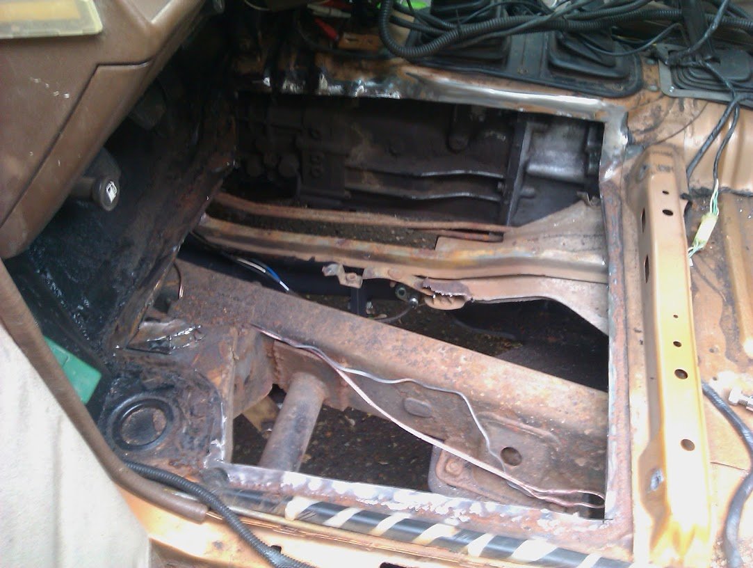

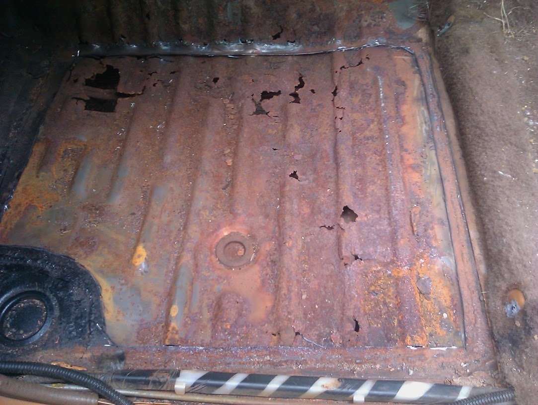

    Here are some pictures of when I patched the floor in my 85 4runner for some inspiration...
    16 gauge steel, and bought a HF bead roller which I beefed up before attempting to roll 16 gauge steel.

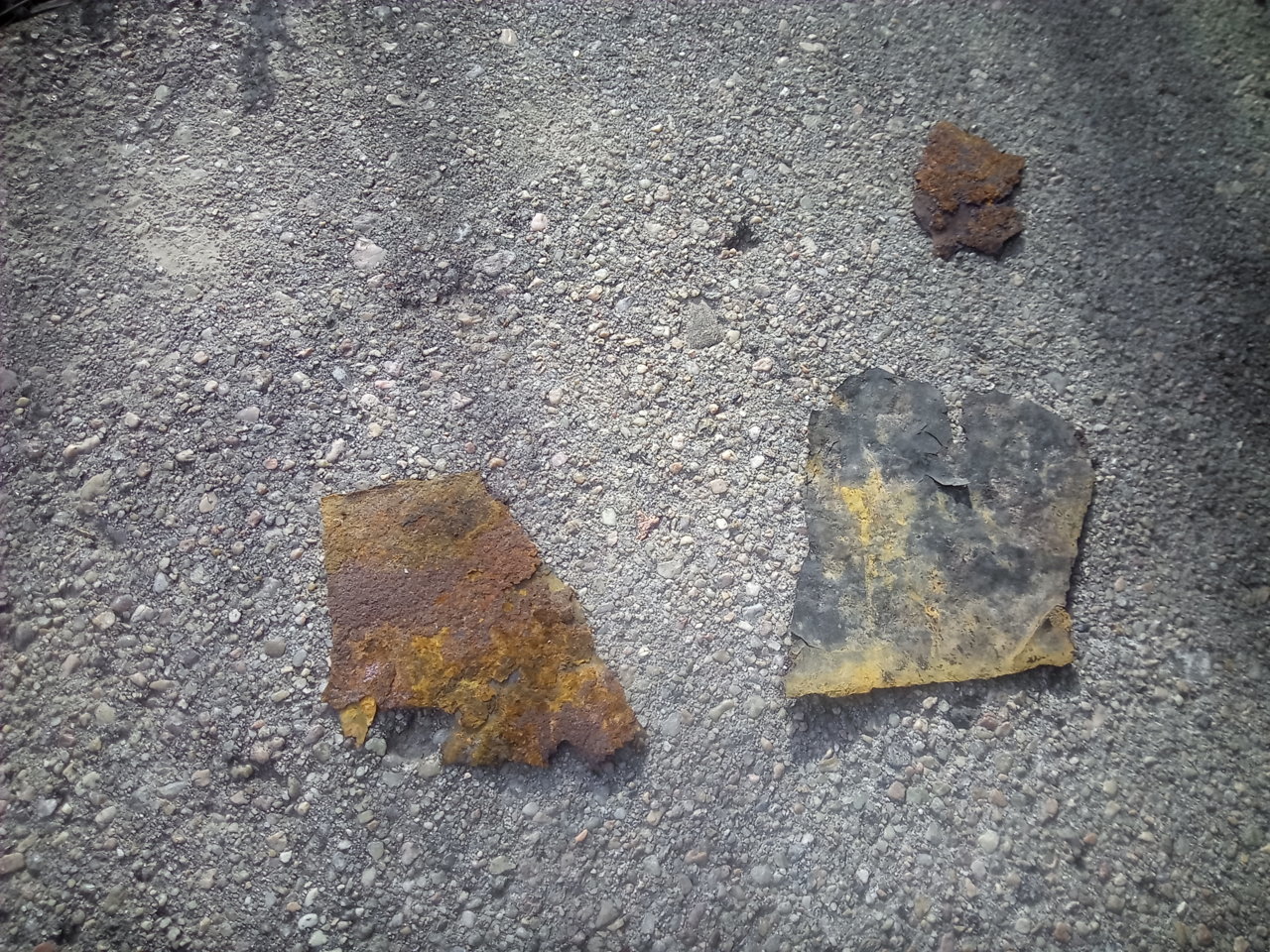

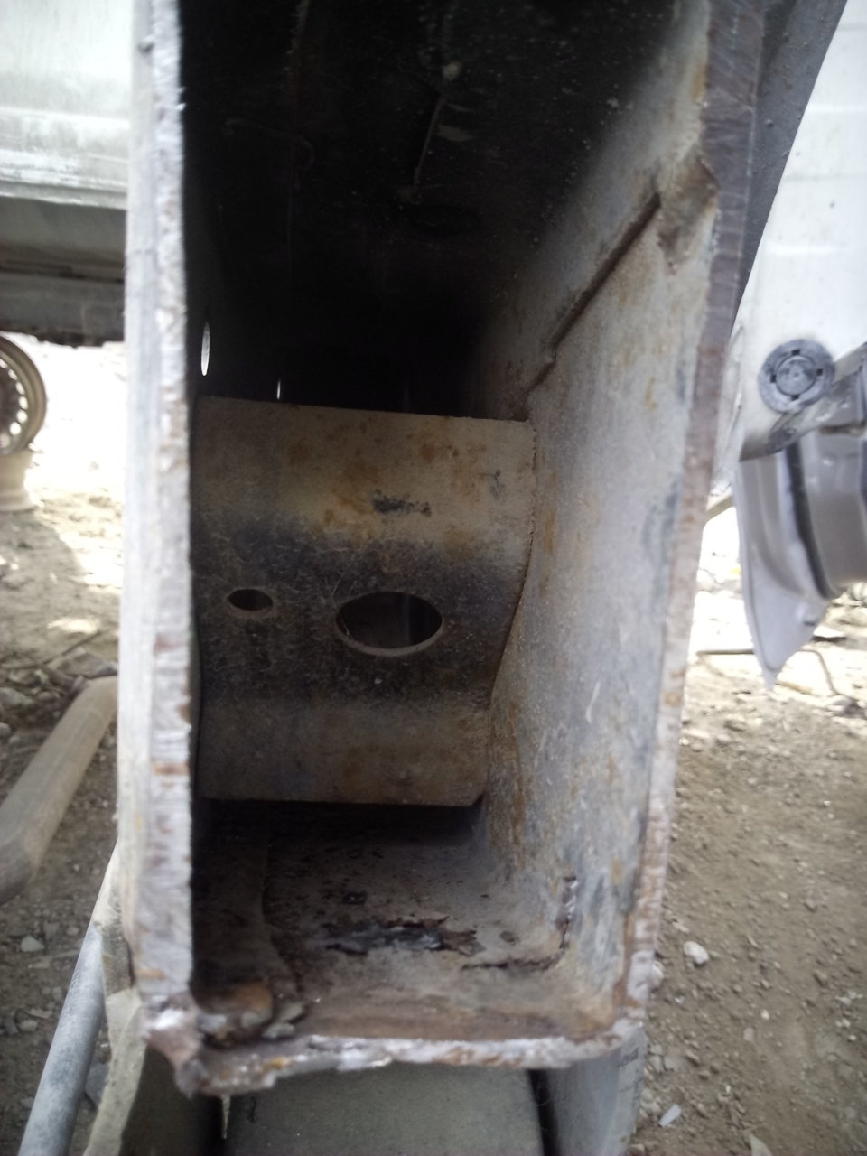

    not sure what to do about this here, anybody ever seen anything like this?!?
    was discovered whilst deep under the passenger front cab mount making it good
    the corrosion inhibitor sprayed last year did a number on the old rubber undercoat like it said it would, softened it up real good
    but what do we have here
    looking at the orangish spot up in the corner on this one

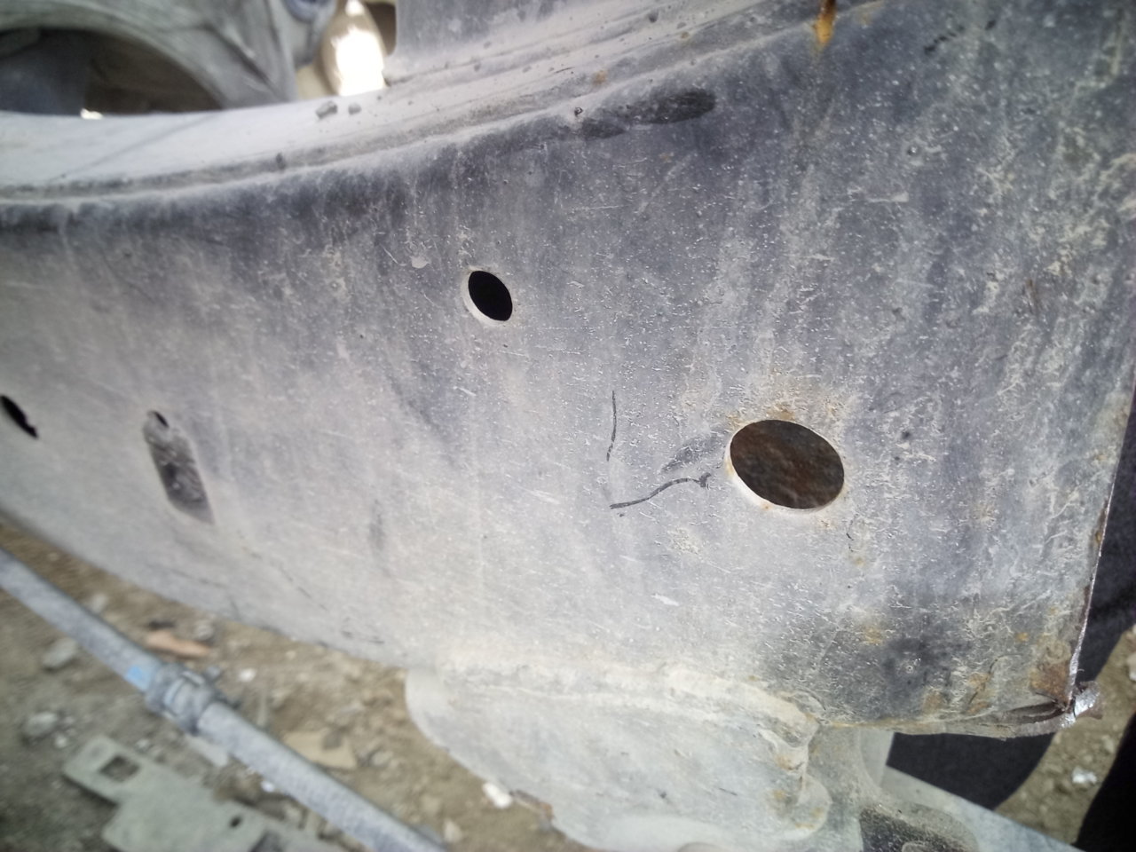

    so what's the deal with this crappyass primer or whatever they used on these frames?!?
    i am in a world of discovery and my pee-sized cranium is throbbing with befuddlement :(

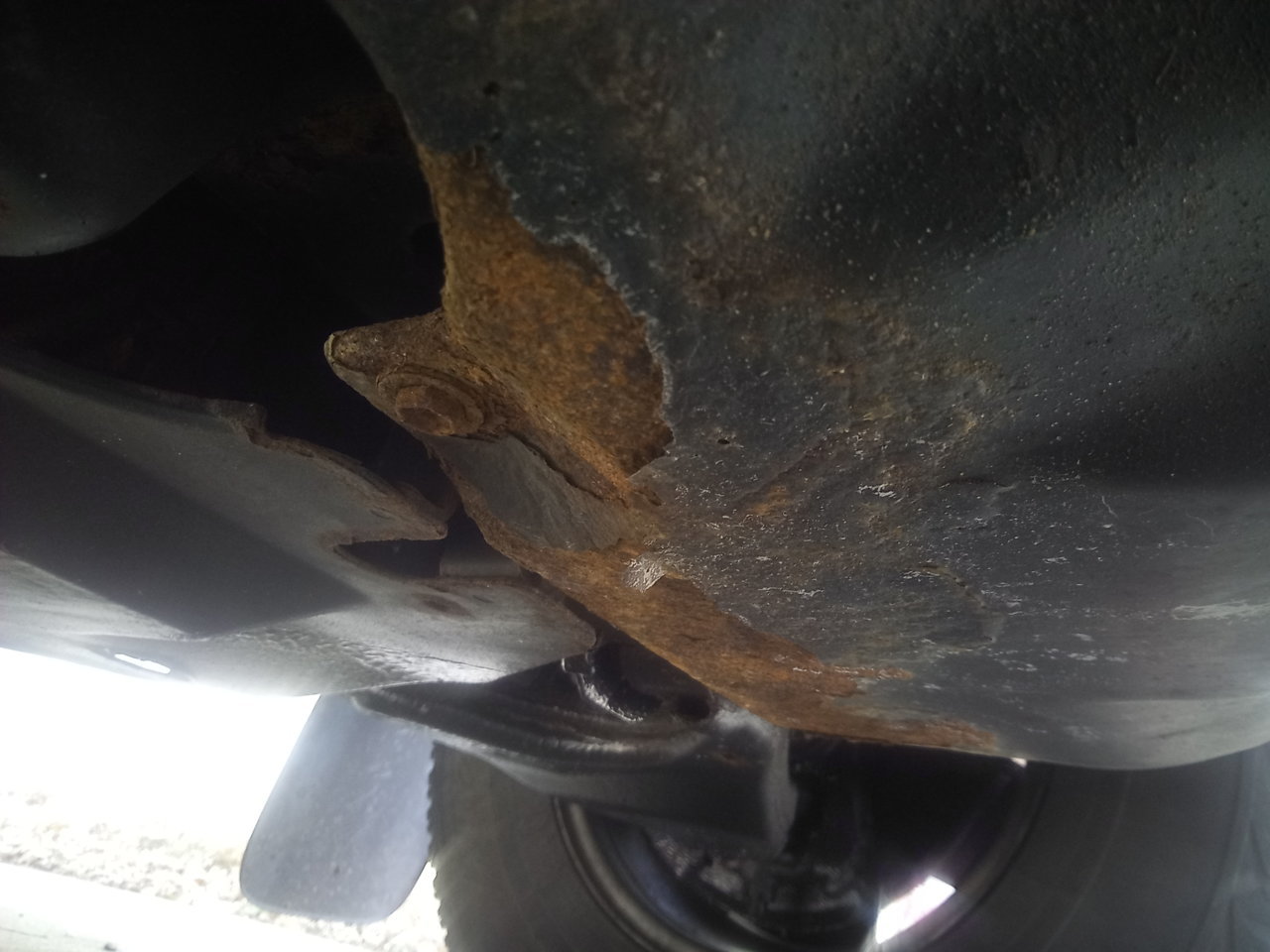

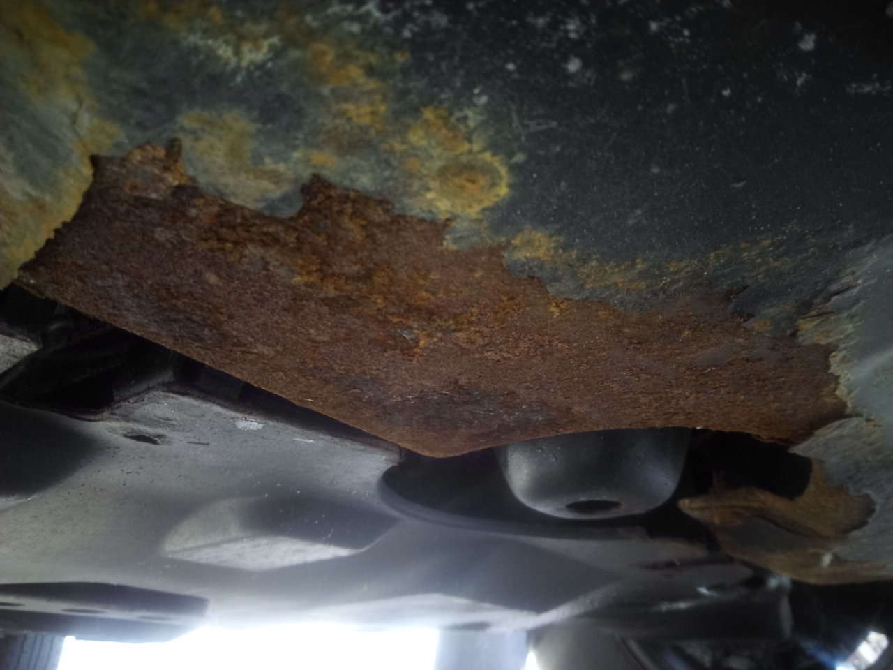

    This is a 2nd gen rc 2011 front skid shield plate with 47k
    1st gens don't do this bad in this area!?
