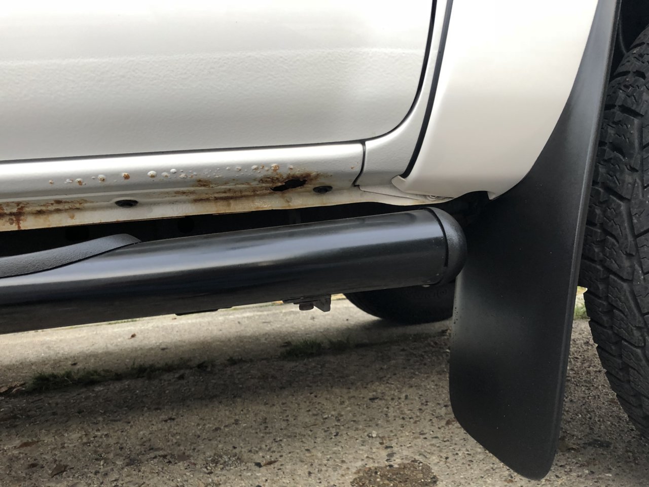

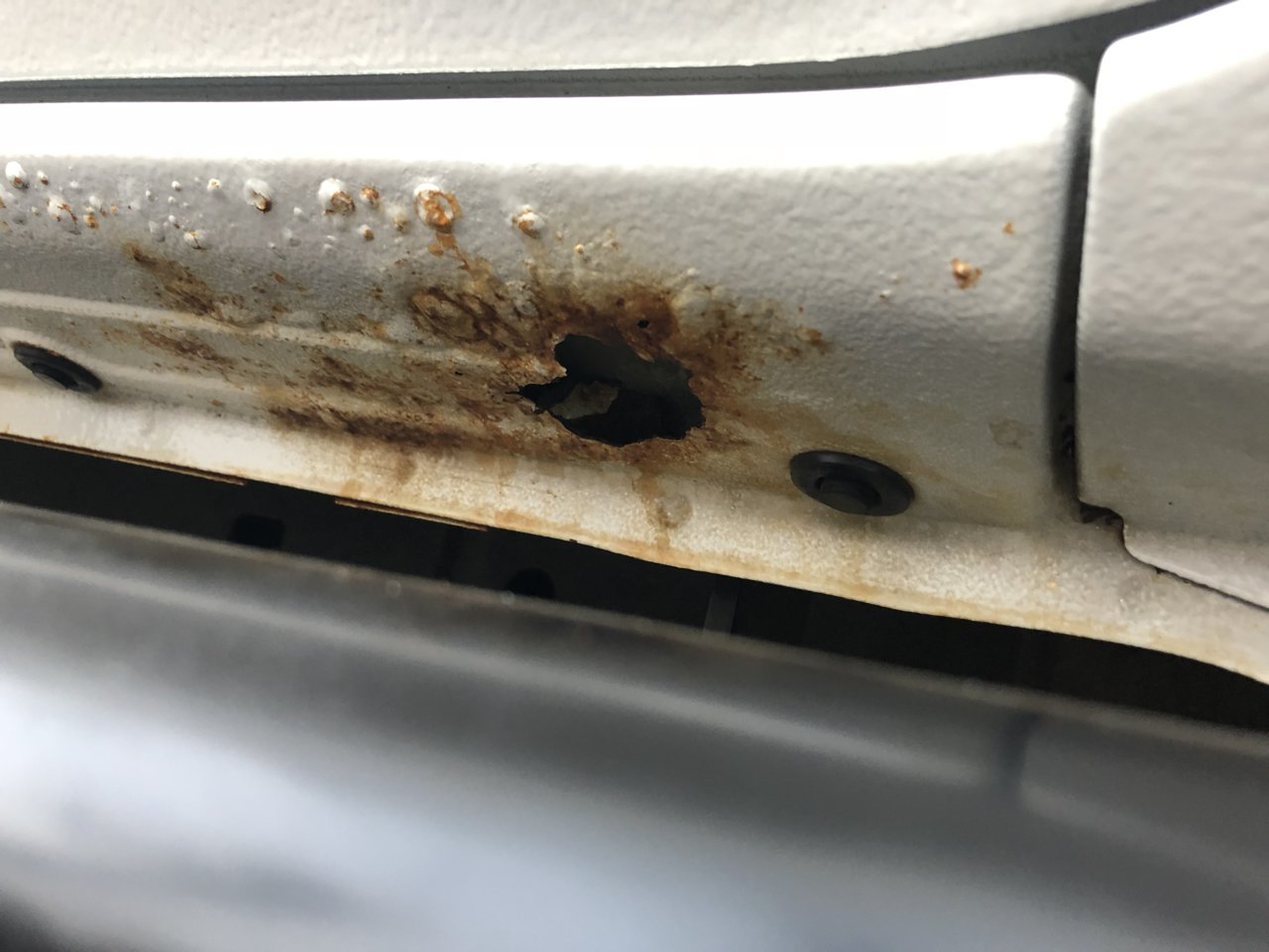

    88811FE7-D6F7-47E6-BBE3-107750DBD2CF.jpg 09C91E23-D847-48C4-B40A-085712B2A7E1.jpg Anyone have or seen this problem. Below passenger door on a 2012. Cause or what was the fix? Thanks!

    :eek: I hate rust so much. Salt ruins everything. Unfortunately I think I'd take it to a body shop to have it fixed. It is kind of weird to see rust there though, it seems most Tacomas have rust issues on the undercarriage, not the body/doors. My guess is that the paint got a nick in it down to bare metal and rust just creeped around the area.

    See those little black plugs under the door sill!!!. In areas of high salt in winter or wet conditions you should remove and oil underspray every fall before winter including frames, brake line, gaslines etc. and you would not have all these problems with rust and frame replacement. It amazes me that people spend thousands of dollars on lift kits, Bilstein shocks, wheels etc.etc. but cannot afford to spend a few dollars a year to protect the underside of their vehicles. You should do this to any make of vehicle if you want it to last. It is probably too late for you as probably the whole undercarriage looks like this but the door sills could be replaced by a reputable bodyshop..

    This is a common thing in salty areas, the reason most people deduced that it happens is the running boards. Snow will pack between the metal and running board, then salt gets into said snow, et voilà! You have the next few months of salt on metal contact and the rust starts.

    Not good.Salt getting in from underneath.

    100% guarantee the drains were plugged and water was held in there.
    It would be SO easy for Toyota to fill those areas with a closed cell expanding foam. They would never rust from the inside out [as that one did] if they did that.

    I would pull the carpet and check the floorboards for infiltrated rust along with the frame.

    2nd gen’s aren’t known for body rust. You can’t fix that with por 15. You need new rocker panels. Too bad your rust through warranty prolly just expired. You can’t sand and paint it, it rust from the inside out.
