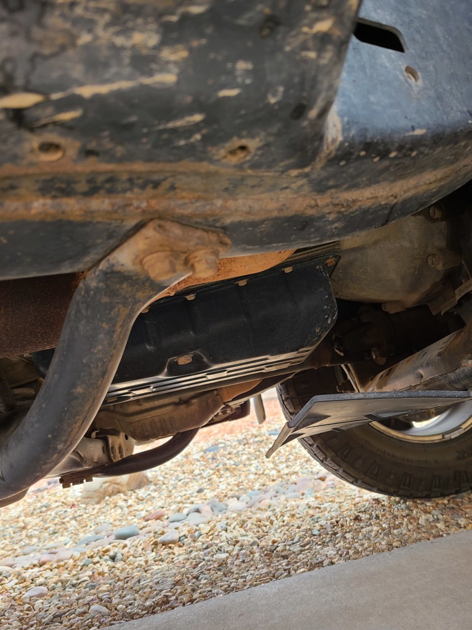

    I just went out and took these pics. 2006 4Runner with 170,000 miles. Spent its first 10 years exclusively in Ohio, PA, NY, and NJ. Lots of snow and road-salt driving (Upstate NY is ridiculous). I never treated it with anything. Just washed it regularly. You can see the rust seems to be where the welds are.
