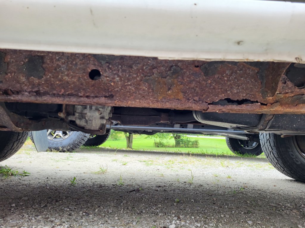

    Alright guys i'm up in Ohio with all these salty roads.
    Give me your go-to rust inhibitors, treatments, chems, converters.

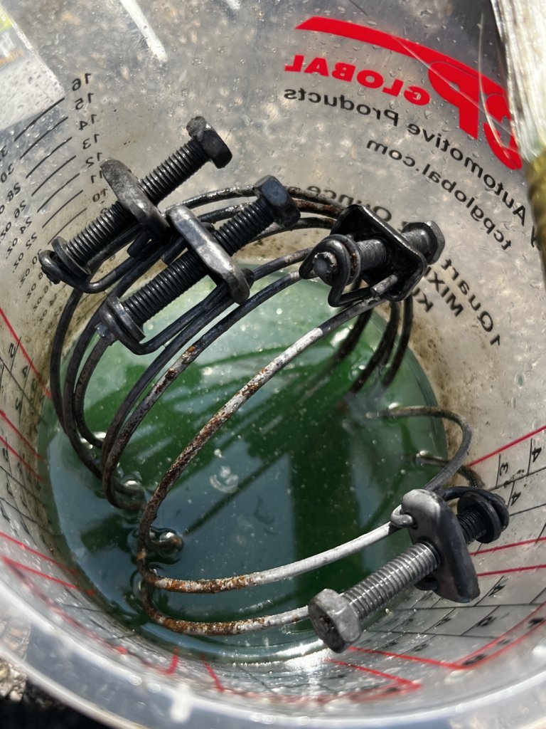

    So far my standard practice is surface prep (wire brush/sand) Ospho phosphoric acid to convert and neutralize the oxide reaction, and LPS no.3 inhibitor for mechanical components or paint for surface metal. (those pipe clamps where caked when i pulled them off and i was amazed at how much core metal was still left)
    I have seen a bunch of what look like gimmick spray coatings that (stop rust and seal metal) but i really dont feel like coating rust is a real solution. I also cannot dip my whole truck in acid sooo......

    I vouch for the ospho as well. Sometimes you need to apply multiple coats if everything doesn't turn black.
