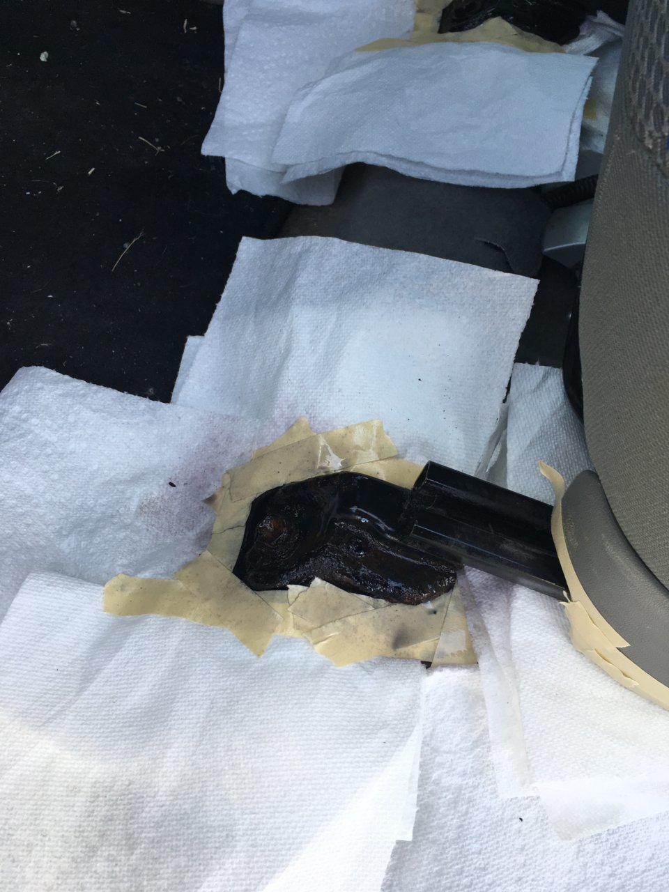

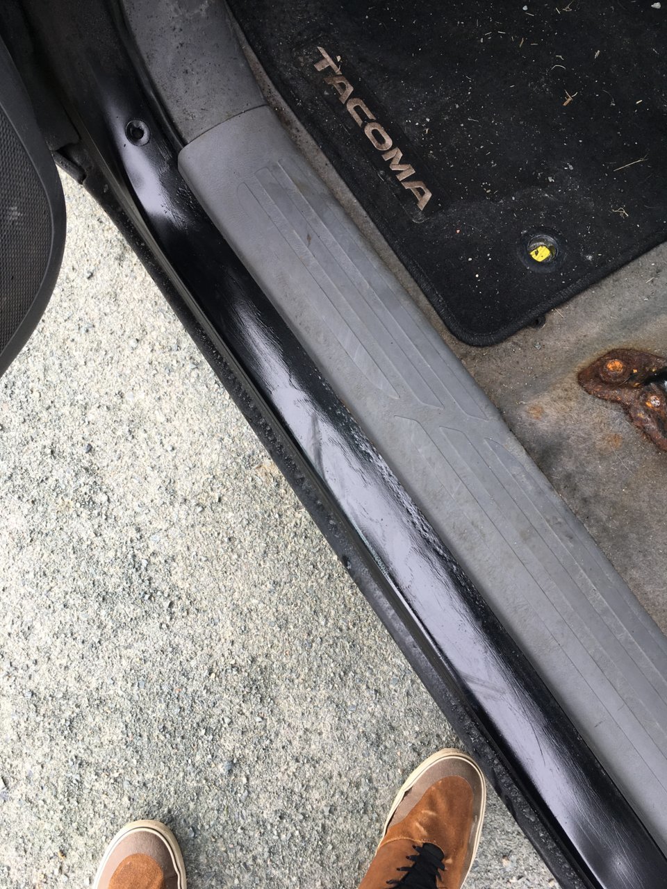

    Heres the finished product. Could have filled in the pin holes and blended some more, but I just wanted to remove the rust, also its a bit dirty in this pic after driving for a few days. Today I decided to attack the seat mounting points with some rust converter aswell

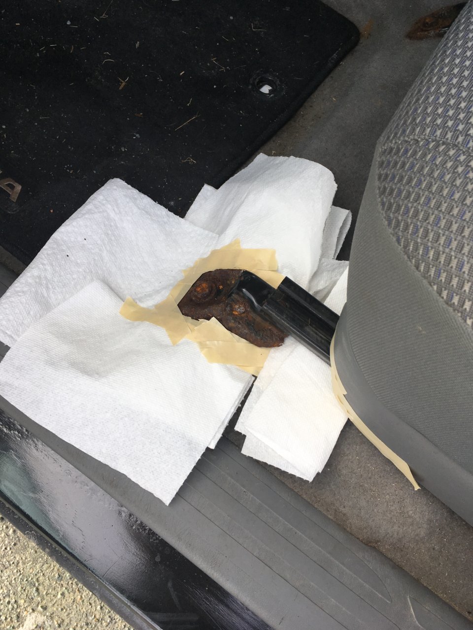

    My rockers are OK but my seat mounts are rusty as well although not nearly that bad. No idea how it happens.

    @Newfiebruh what type of rust converter did you use for the seat post. I’m going to do that next.

    I used rust check rust converter. Its a Canadian company so I'm not sure if its available in the US. But any spray on should be good.

    I'm guessing you live somewhere that's never seen snow..lol. Slushy snow mixed with salt from your boots will get caught in the door sill, slowly rusting it away under the plastics. And the salt is super attracted to bare metal, so if the paint of the seat mount wears away, its basically like a magnet for the salt. If you look at OP's, and my before pictures, you'll see the salt attached to it.
