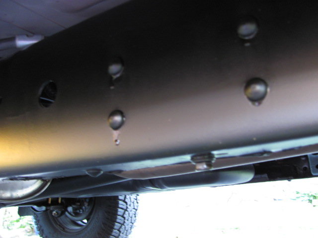

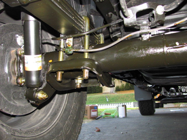

    Lost my beloved 2003 Taco to frame rust. Hope to not let that happen to my new one. My gallon of Cosmoline arrived today and applied it by hand to where the 2003 rusted.2020-10-14 012.jpg 2020-10-14 014.jpg 2020-10-14 022.jpg 2020-10-14 016.jpg
    4-inch foamie and a chip brush seemed like the best applicators.
    This is all I used.
