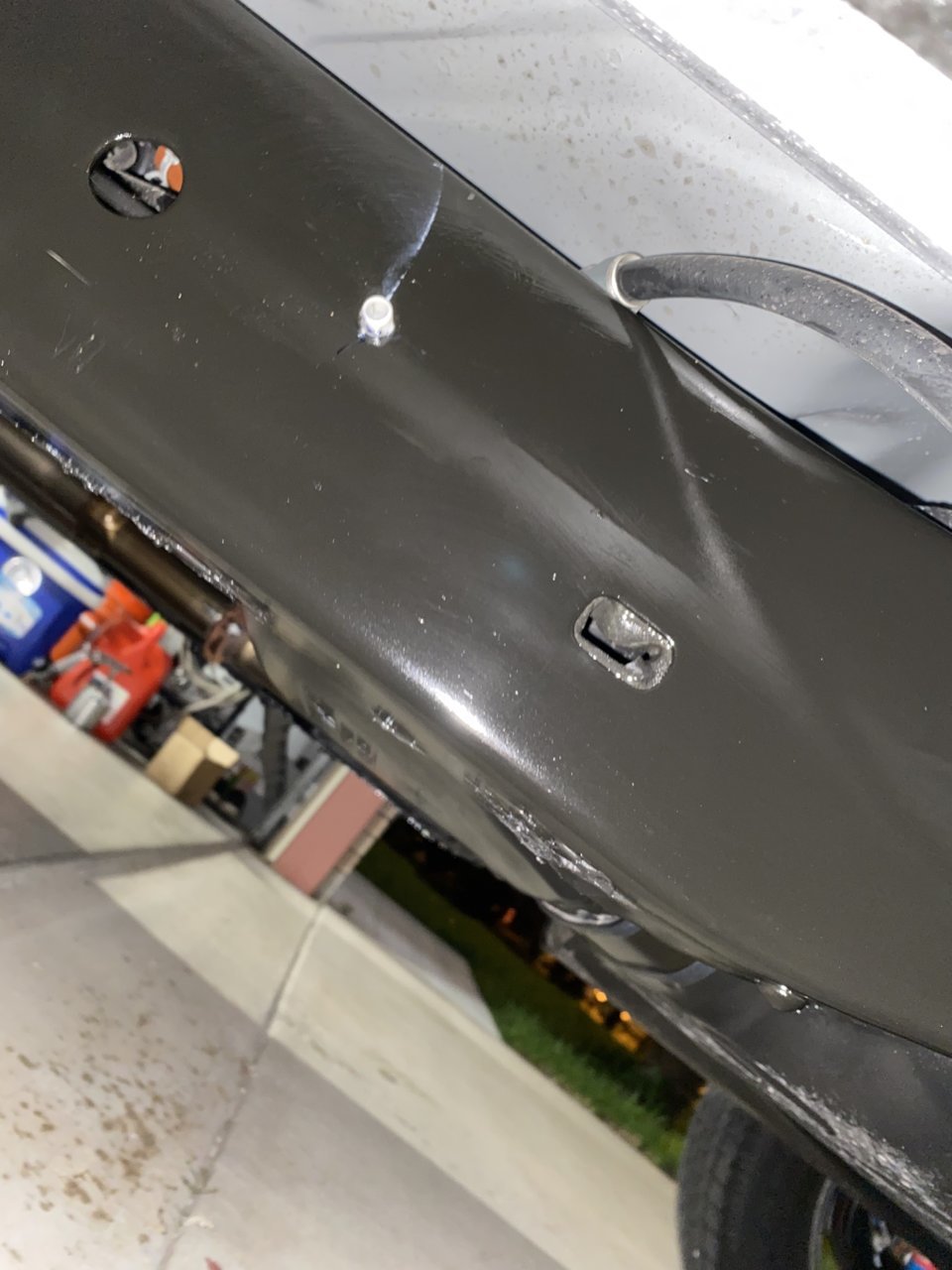

    About a month and a half ago I touched up the cosmoline.
    As mentioned before, Cosmoline is only really susceptible to being removed by abrasion. Rock chips and scraping branches seem to be the only way it gets removed on my truck.
    I drive a decent amount of gravel roads, so my undercarriage gets pretty blasted. If you drive on anything other than pavement 100% of the time, a once a year touch up is recommended. Just areas like the leading edge of the lower control arms, leaf springs, rear axle and crossmembers. Areas that don’t get direct contact from rocks or branch’s are still in perfect condition from the original application.
    My underside is dirty and happy. 99% rust free, which is an anomaly for any daily driven NW Ontario truck.
