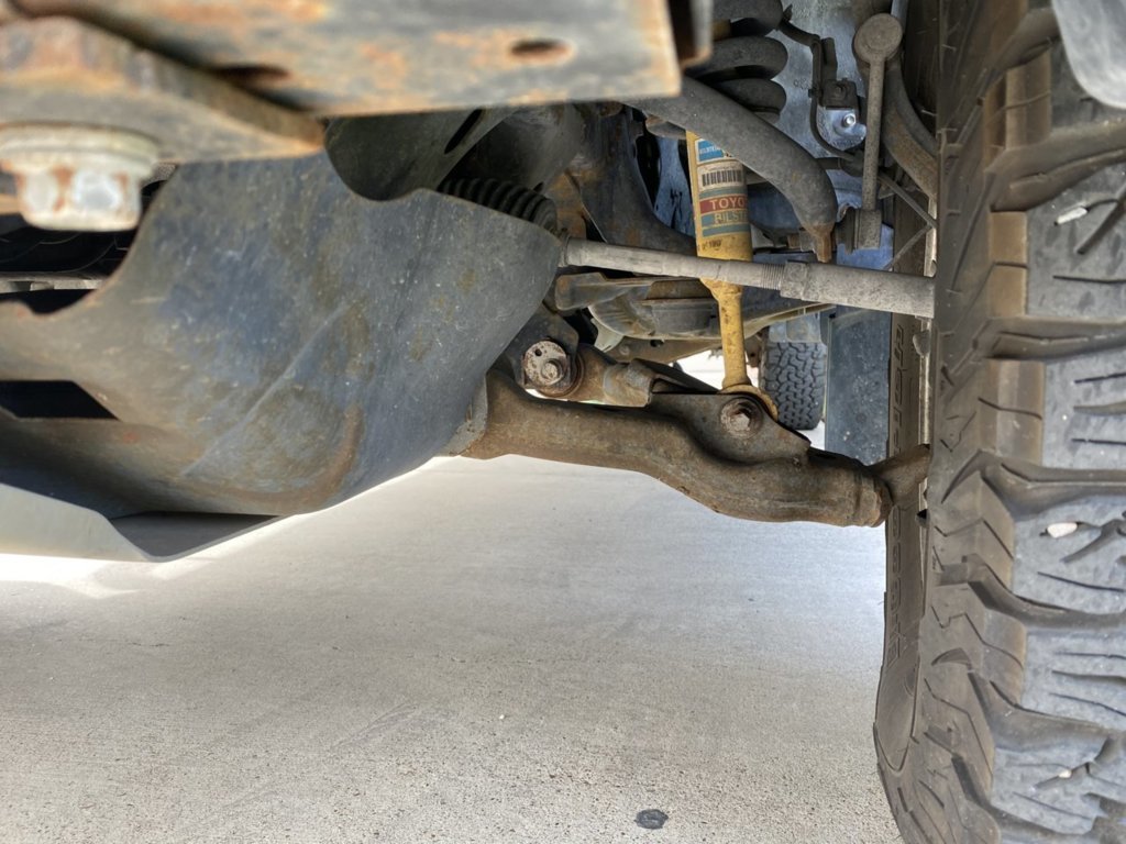

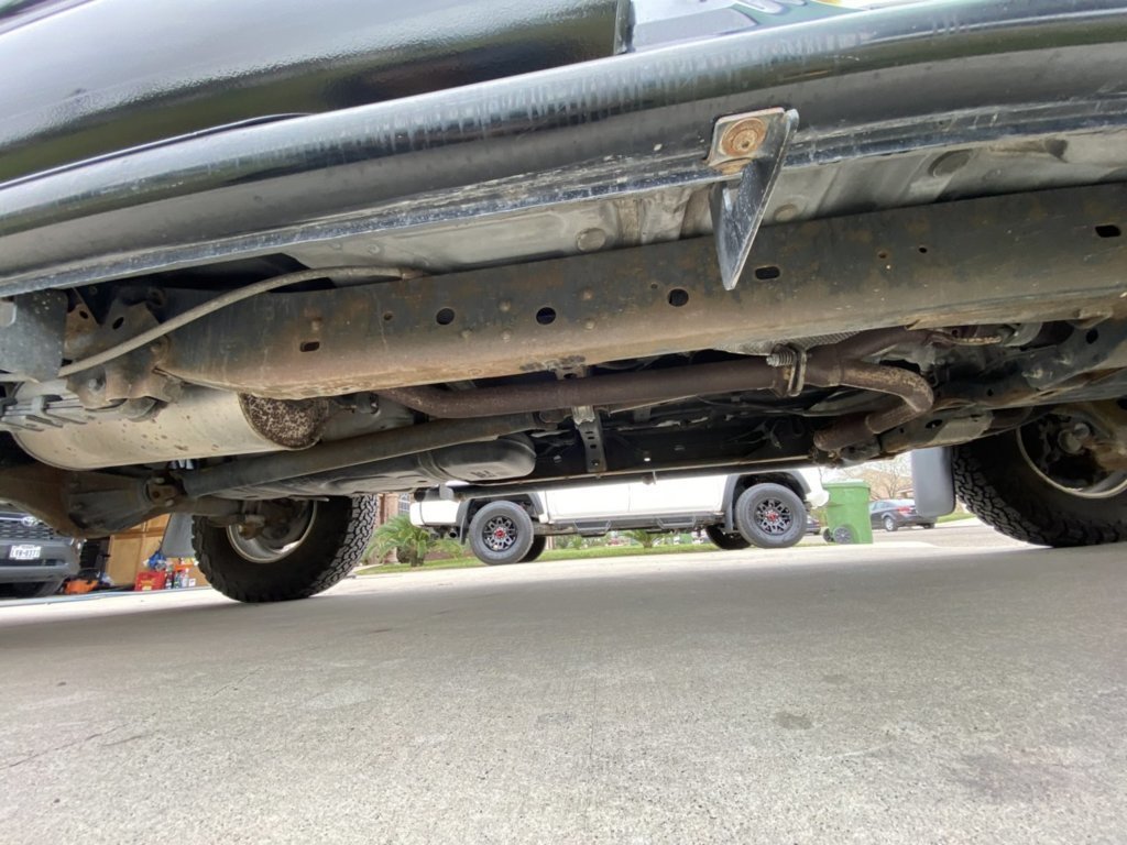

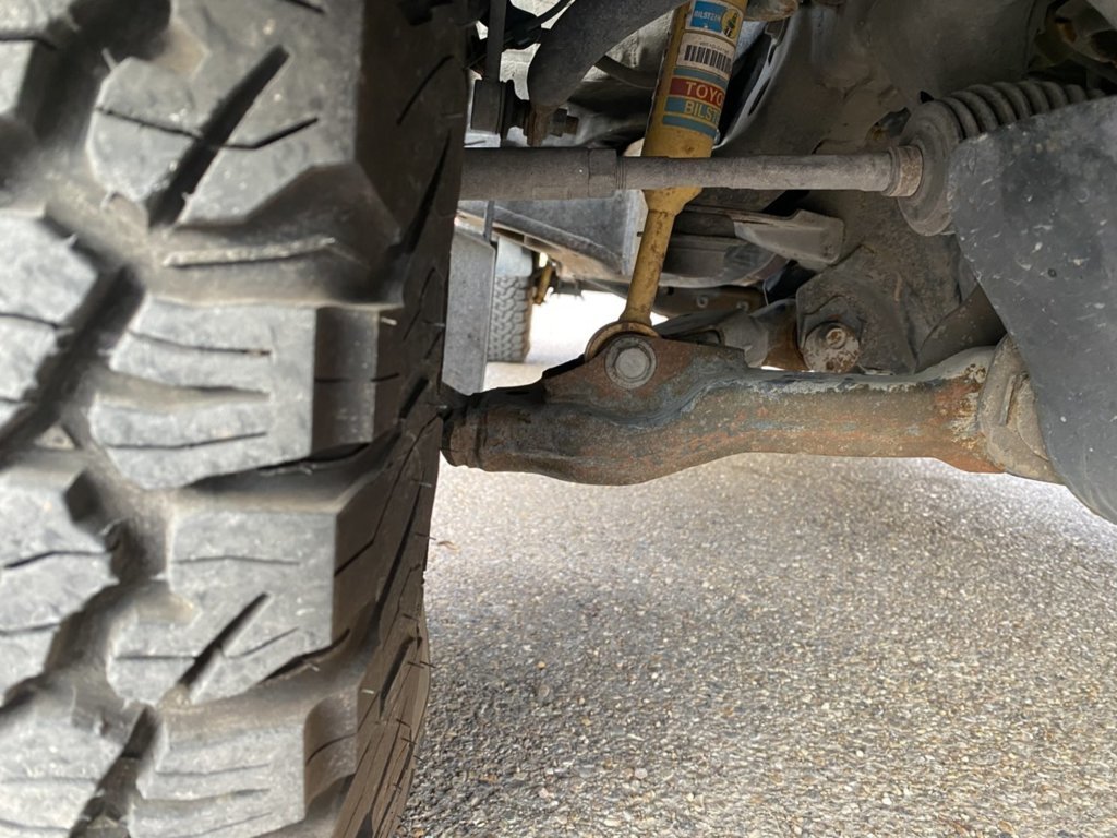

    Salty water from the gulf is just as bad. This was after 2 trips to the beach on which my 2nd Gens frame came into contact with salt water. I wish I would’ve known about FF earlier. I know this may not seem all that rusty but for only being 2 day trips to the beach, the damage is quite potent.

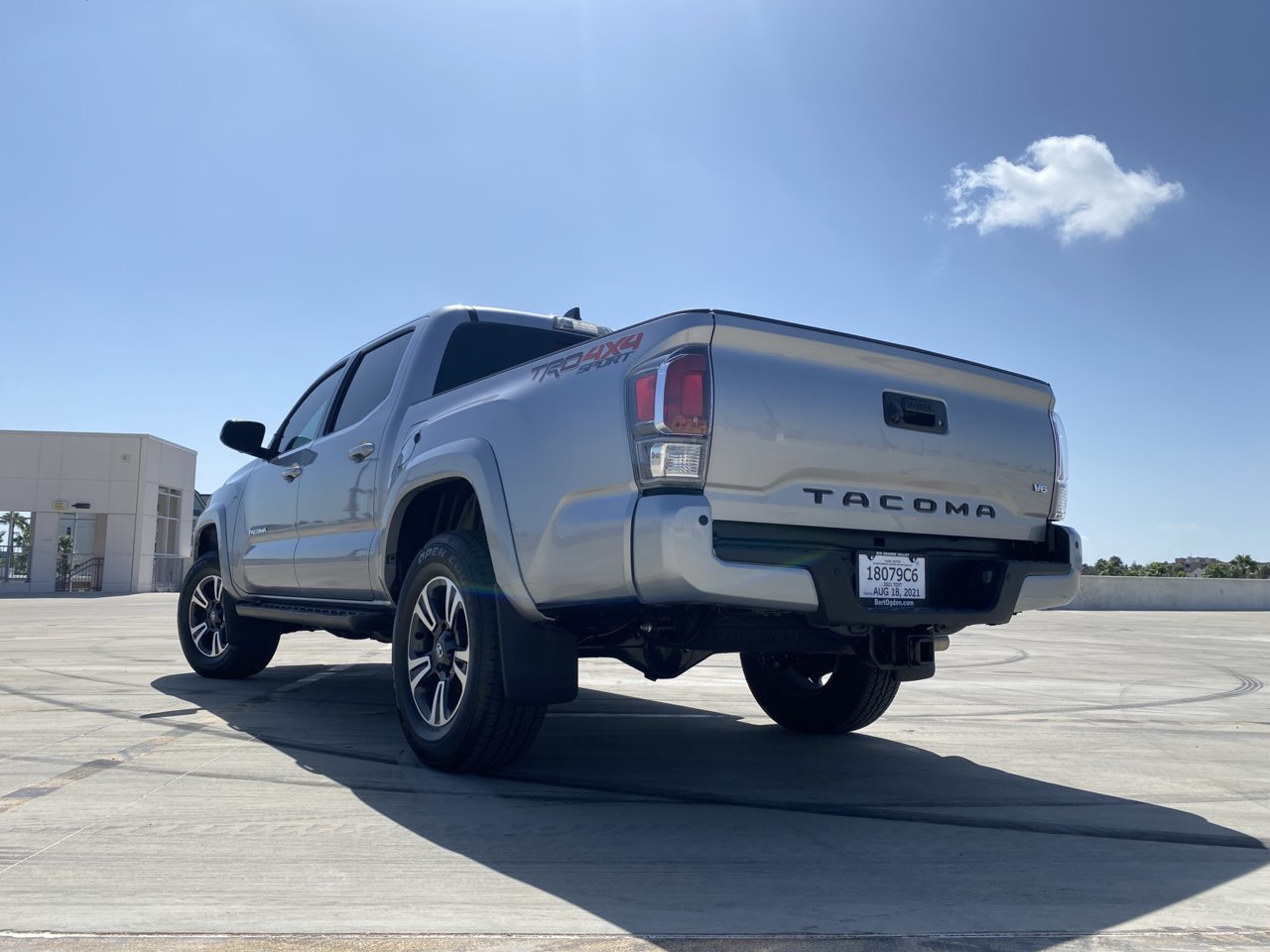

    I took my truck to the beach the very next day after I FF’ed the truck. Gave it some thorough rinsing to knock off as much sand as I could and now my frame is nice and matte. Dirt and grime don’t seem to stick onto the surface as bad as people say it does.
    Edit: you can kinda see my rear differential and how nice it looks. I understand it’s new, but it it’s gotten pretty dirty after I drove my truck through streets flooded with muddy, murky water.
