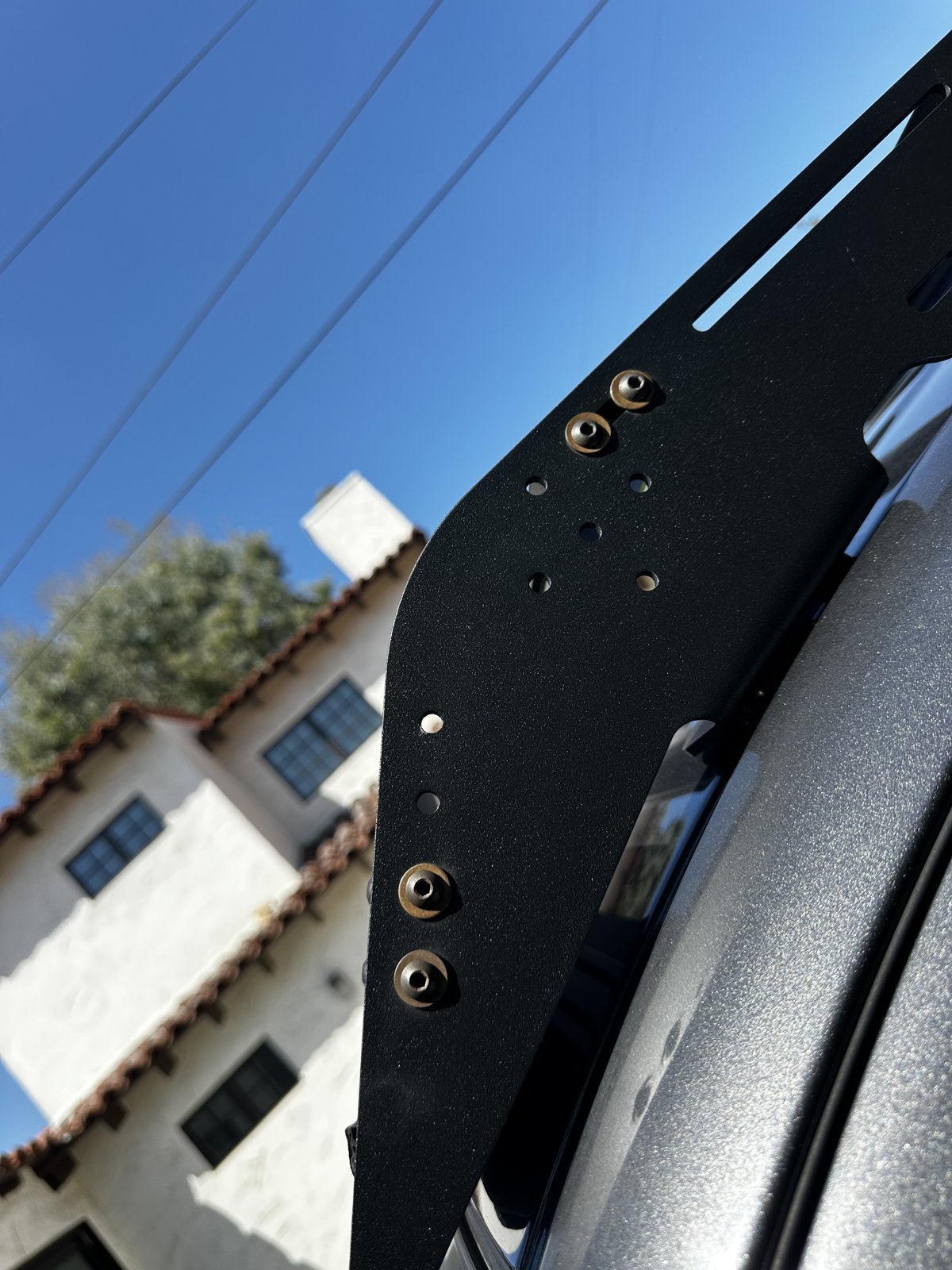

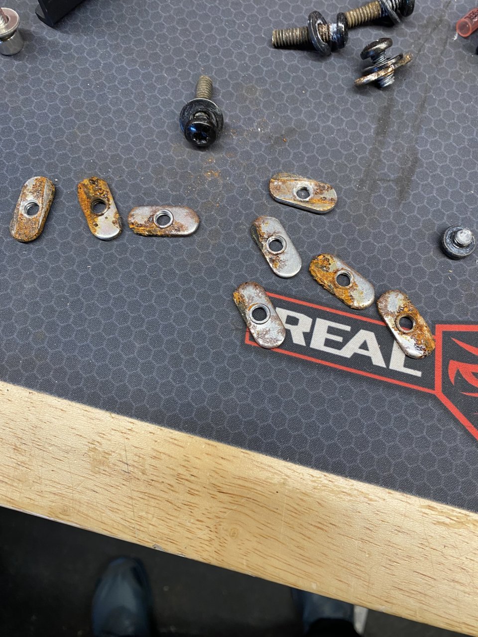

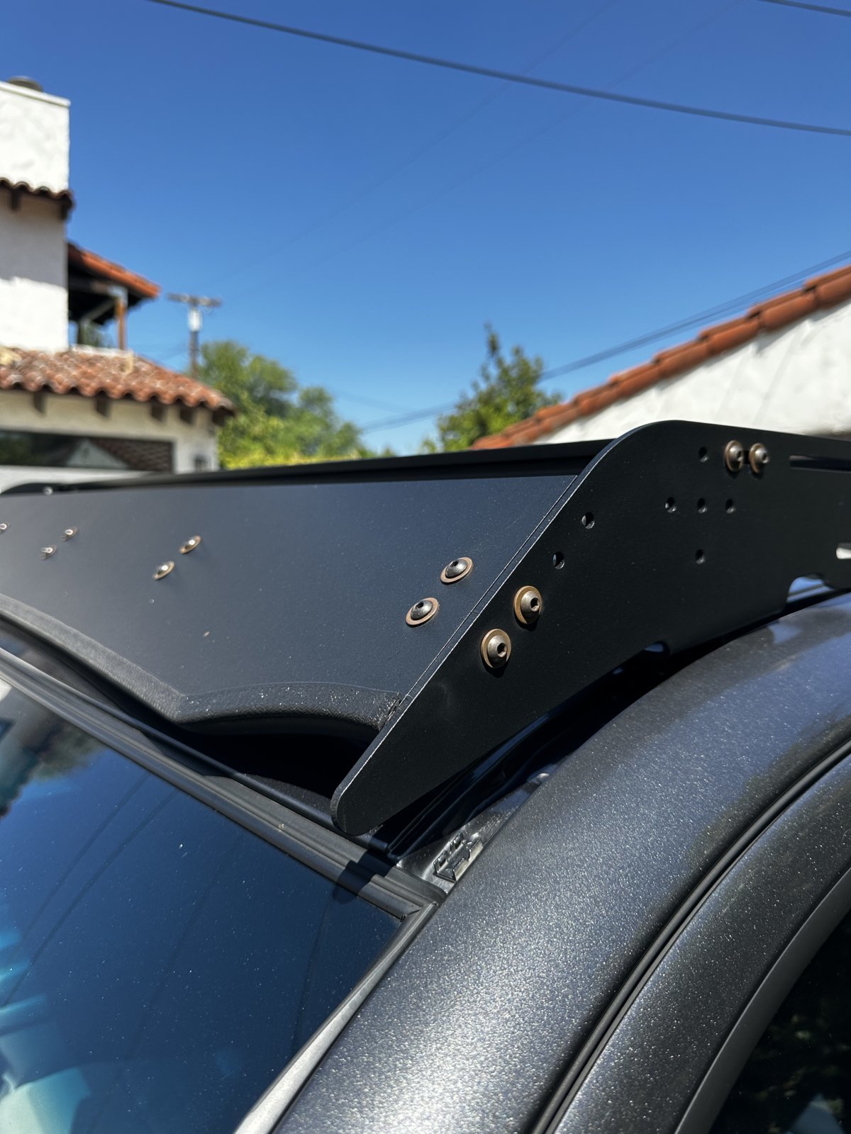

    I wish I had read some of these threads regarding Prinsu roof rack hardware before purchasing. I too was a victim of their poor-quality hardware.
    Prinsu (CBI Offroad) was slightly helpful but sent out the same corrosion/rust-prone hardware. As a quick fix, I replaced their hardware with all stainless bolts.
    I am now switching to "tamper-resistant" black stainless for aesthetics, and longevity. There are tons of threads on this issue and recommended replacement hardware again, just regret not doing more homework.
    For context, this was after a little over a year and I did apply anti-seize, I was adding/rearranging accessories and was gifted this fun.

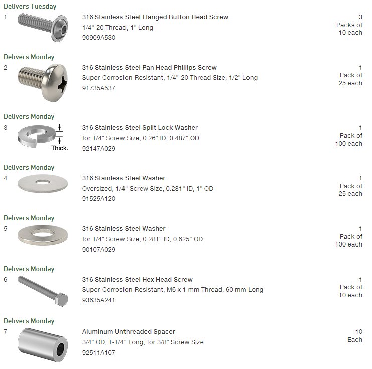

    I bought the full cab 2nd-3rd gen roof rack used and tried to disassemble to clean. Some screws broke in the extruded aluminum due to rust. All the fasteners are rotted out. That being said, I am reaching out to Prinsu to get new extruded aluminum bars via their warranty. But this time I am buying my fasteners from McMaster-Carr to prevent future rust. I also did this for my sliders, since my sliders was purchased used and missing all the bolts. Here are the items I ordered.
    Instead of the t-nuts on McMaster, which cost an arm and a leg, I ordered 1/4-20 Roll-In T-Nut with Ball Spring as 304 stainless steel from 8020. Product number: 3670
    By the way, I want to note I am getting slightly longer hex screws and spacers because I have seen issues where the front of the roof rack is way too close to the body. I also combined flat washers and screws into a single piece by ordering flanged button head screws. I will be torqueing everything to instruction specs, in order to protect the aluminum parts. I ordered blue thread locker and new rubber edging from Amazon.
    I live in New England, so I hate rust and will be spraying stuff with POR-15 Topcoat.
