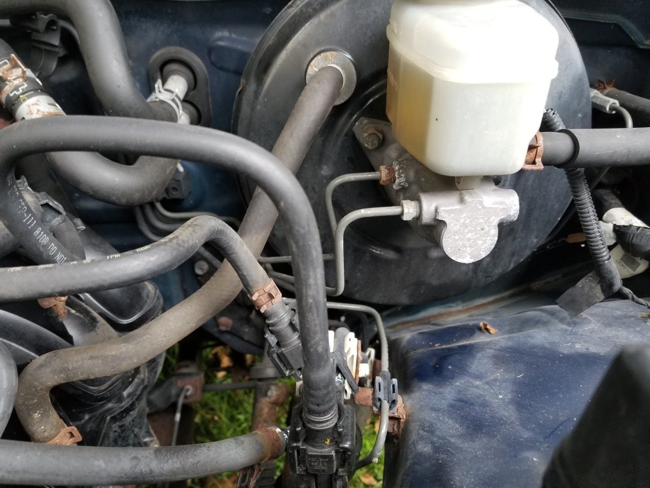

    this is my brake cylinder.I do not see the hose. What do I do to get my clutch activated after I bend up a line to replace the one that popped..How do I bleed the system..do I have to take the clutch pedal out?

    see the black hose with the spring clamp on the right side of the picture, left side of the reservoir? I'm pretty sure that's the hose that terminates at the clutch master cylinder. Once you have your new pipe, or adm installed, add brake fluid to the reservoir so that front chamber has fluid to the top. 2 person procedure, 1 is under at the clutch slave cylinder bleeder and dressed ready to get brake fluid all over your face, hands, arms, arm pits. 2 pumps the pedal up and down by hand, then holds it down. 1 opens and closes the bleeder, nothing will probably come out at first. Repeat over and over, every so often, 2 goes to add fluid to the reservoir. slowly, pressure will build, 2 will feel tension pushing down, slowly it'll start wanting to spring back up. once you begin to feel it springing back up, another step you could try. stick a hose on the bleeder nipple, it needs to fit the nipple tightly, clear hose is better to see what's going on, stick the other end in a container with a little clean brake fluid in it. Open the bleeder, pump the pedal up and down, might need to go back to hand. you'll see air bubbles coming out as you push down on the pedal, then draw back up a little as you pull the pedal up. so say for example, it'll push out a teaspoon, it'll draw back up 1/3 teaspoon. no it's not going to be that exact amount, but you'll see what I mean when you do it. eventually, you'll see no air coming out. tighten the bleeder, maybe pump and open a couple more times, you should be ok then.
    Anyone who wants to add to the above, or say it's wrong do it this way instead, I welcome the critizism. Always room to learn something new.

    Thank you a lot..I see what you saw..The big rubber hose with spring hose clamp goes right to the firewall..I bet there is a master cylinder on the other side..So the tube I need to make is just a U shaped tube about 8 inches long..fittings at both ends..one comes out of the slave..other goes to the bracket with short rubber hose..Awesome..again thanks a ton.!!! Radio bears Rule!
