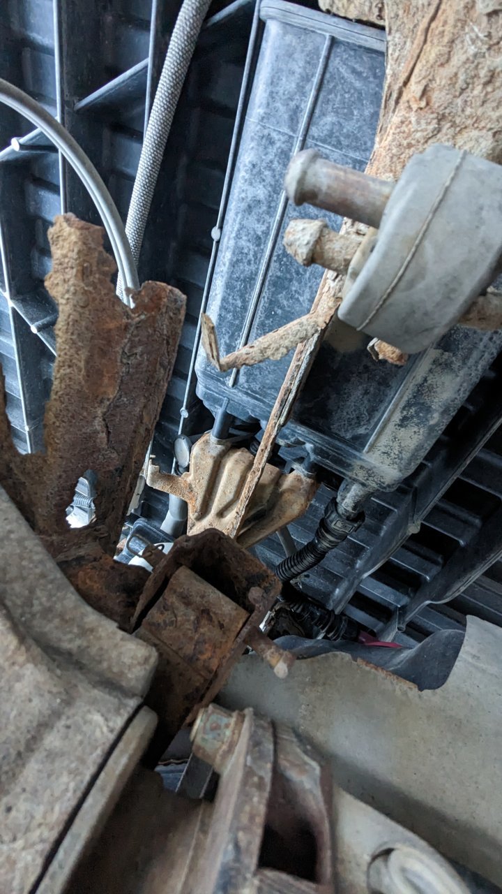

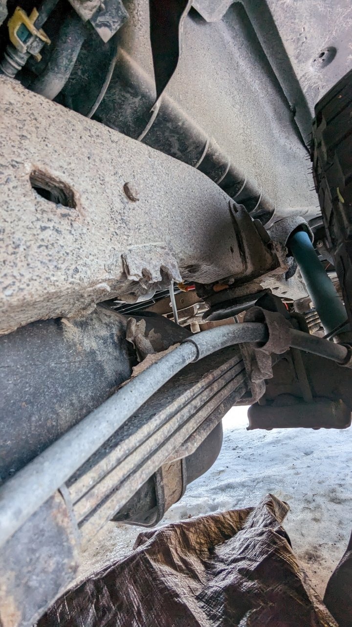

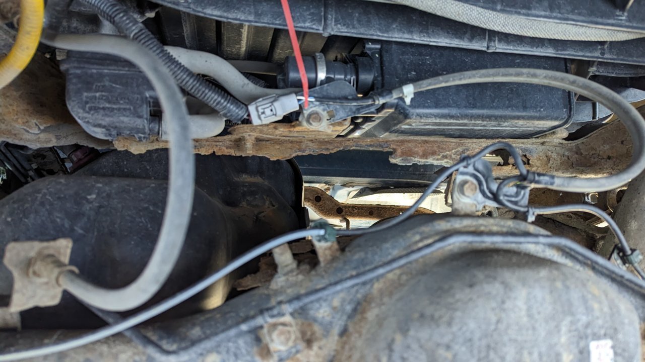

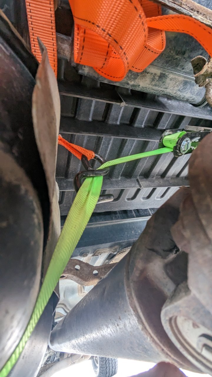

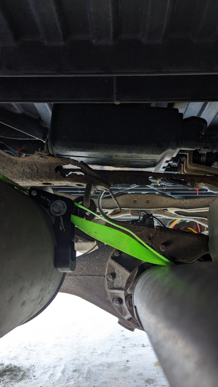

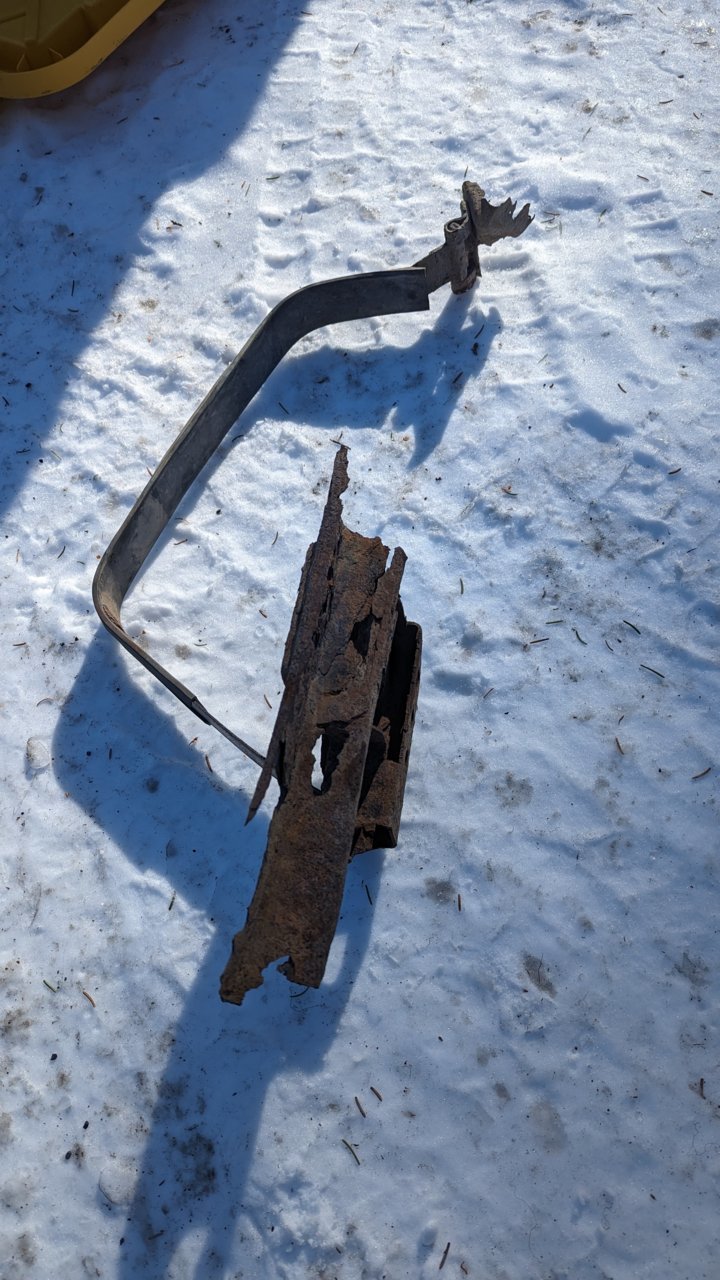

    Well my rear gas tank strap fell off yesterday and after taking a closer look I noticed the rear cross-member by the fuel tank was completely rusted through and the mount on the frame broke off so both sides failed at the same time. I think I'm going to have to weld a new mount on the frame and I will definitely have to replace the cross member in order to repair this mess. yay. I am going to try and document my process here for advice and in case anyone else has this issue down the road.
    I've got a 2006 DCLB 4x4
    Here's a picture from the passenger side rear wheel when I noticed it wasn't quite rightPXL_20230310_015509432.jpg
    Here's a closer look at the broken frame mount
    Here's a picture from the rear of the truck, the rusty crossmember front and center
    Looking up at where the fuel tank strap fell away from the crossmember
    Looking back at the other side of the crossmember,
    And finally the broken fuel tank strap with its chunk of the crossmember still attached

    If one crossmember is that bad, I would strongly recommend you get the whole frame checked by a good fabricator to ensure that there are no hidden issues!

    Before expending any $ or effort, best to make sure the frame is even worthy of use.

    Dang that looks horrible. I think your frame is a tad beyond welding patch fixes. Good luck with your project OP.

    Also in case anyone is interested, here is my short term fix for keeping the fuel tank secured so that the strap clears the drive shaft and the muffler. I rolled up the excess straps and will probably just put a few zip ties on to secure them from getting caught up in any moving parts.

    I was able to get the truck the hundred some miles to a shop without the fuel tank falling out so that was a small victory. The shop was able to take a look at the frame and is going to repair some spots and replace three of the crossmembers. The cost is definitely running up, but at least I won't be having to replace the whole frame... I'll post more updates as they come, but hopefully there won't be any surprises.

    Unfortunately I am currently waiting for a shop to replace the back half of the frame... The rust damage was pretty extensive on the frame and there wasn't enough good metal to save.
