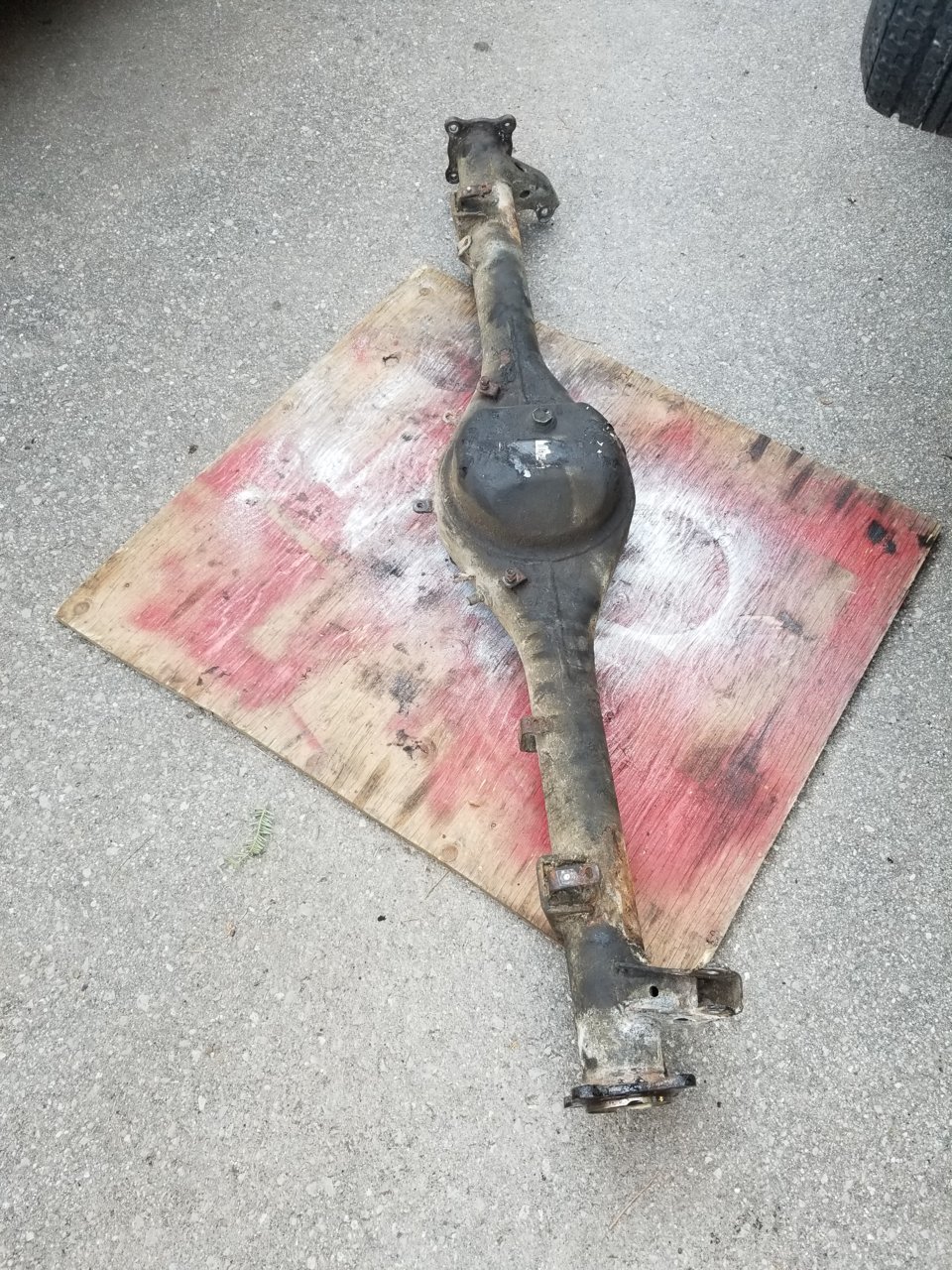

    I won't mess around trying to repair it, find one these or a complete rear end. This one is in my garage but I'm guessing your not close to me. 20210314_172823.jpg
