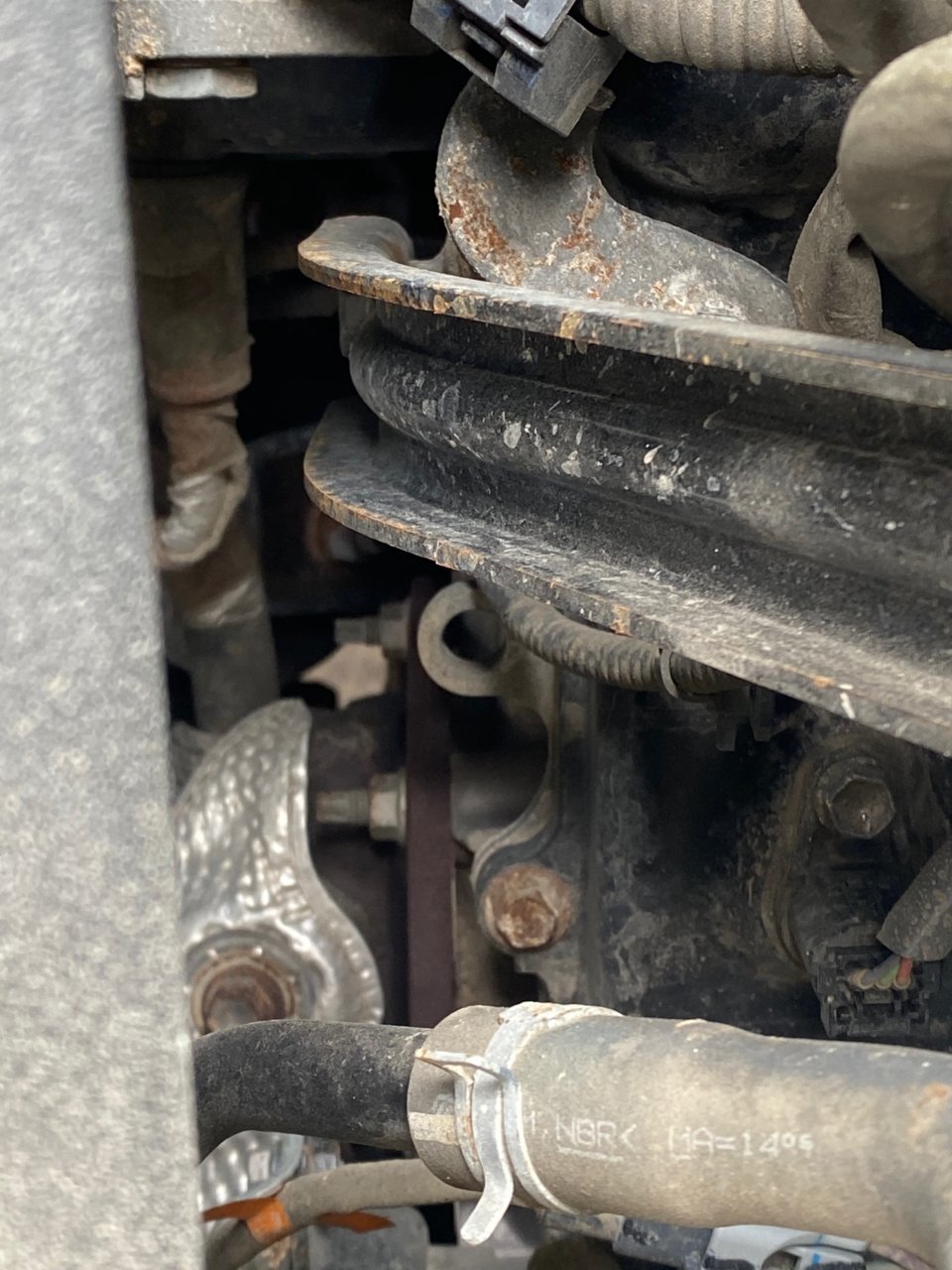

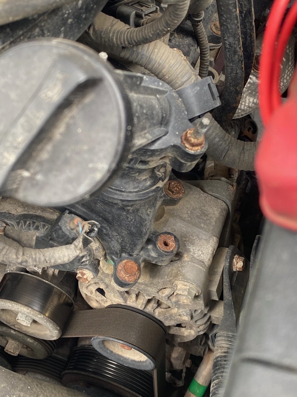

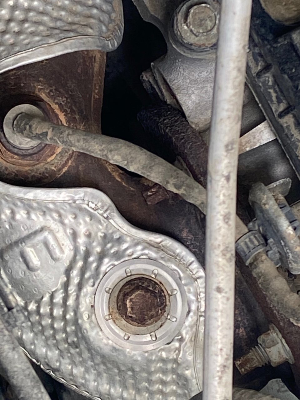

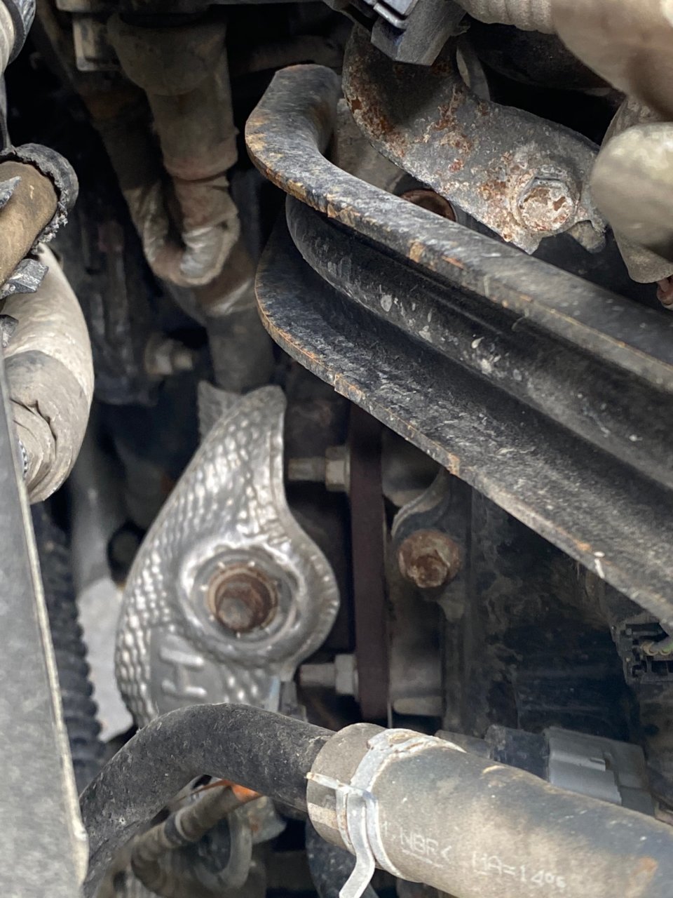

    OP, hate to say it, but you take shit care of your truck!
    That engine bay has way more issues than rusted bolts.

    Found the problem.
    It's part of it, man. I'm not being salty, its just a fact of life when you live on the coast. Washing things down just occasionally would massively help with that. Dirt holds moisture to make the rust issue even worse. Every time you've had that salty schmutz on your windows, it was also all over the rest of your truck. Annecdote: my seat rails in a TJ rusted to the point that they were hanging up and i had to grease them after one week open at the beach. It was already 15 years old and had yet to have that issue... and the previous owner left it outside with no top for 3 years!
    One week ocean front. 4 years and a ½ mile, sounds right.

    I was afraid of that. What should I be doing that I am not? I've stayed on top of all the regularly scheduled maintenance, fluid changed, etc. But have always been weary of cleaning the engine bay. Have heard mixed opinions about whether or not you should do that.

    Half a mile from the ocean, you need to rinse everything down more often. I lived in Jax with my 2nd gen 4 miles from the beach, and mine was fine with some extra upkeep.

    I'm going to guess that all that "dirt" you see in the engine bay has some amount of salt content. Since you aren't washing it away on occasion, it's attacking the metal. Probably need to clean the engine bay on occasion. As far as fixing the damage done, you'd have to wire brush it away and coat it.

    You need to be careful and try not to spray water on the alternator, but you drive through a giant puddle and it probably gets a little wet in there.
    Just be careful with the electronics and I usually crank and drive it to get the moisture back out of the engine bay when I do it.... which honestly isn't that often.

    Holy crap that is bad! Can you paint over the bolts with some paint to protect em?
